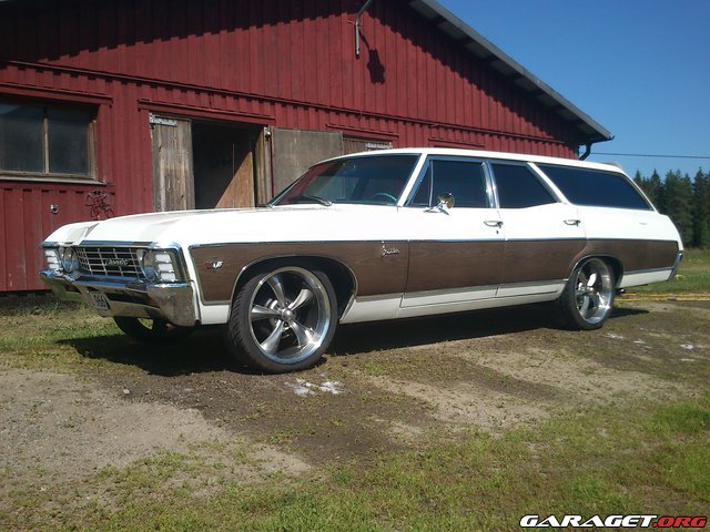

  11. JimpeBoy
    JimpeBoy Active Member
    Apr 7, 2012
    58
    25
    Sweden
    New shocks, new tailgate seal, washed and polished and ready for Classic car week 2013
    Airride-kit is on the way!
  12. Dewey Satellite
    Dewey Satellite New Member
    Oct 30, 2011
    4,367
    9
    Ogden, Utah
    Sweet bowtie Jim, can't wait to see it with the altitude ajustment. (y)
