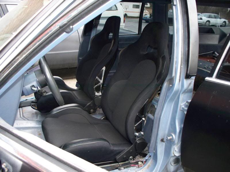

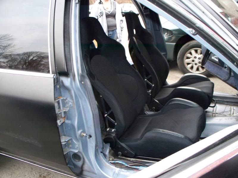

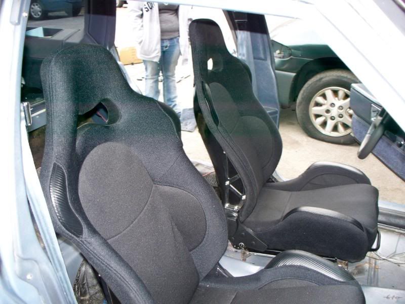

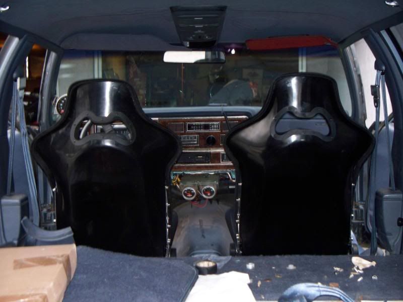

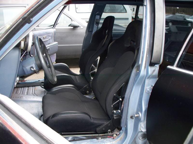

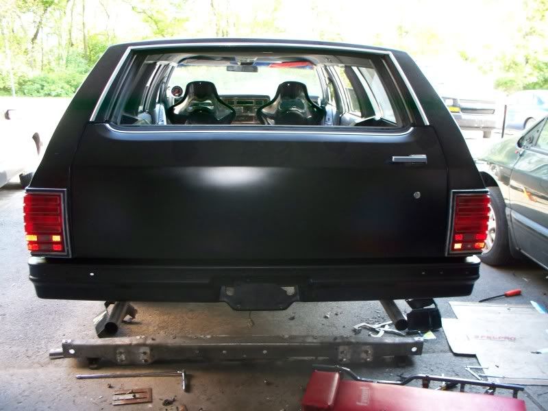

    Ok bucket seats day 2. My car is becoming more and more like my vision of a high performance touring car like i want. We worked on getting the drivers seat perfect and making brackets for the passenger seat. It took most of the day(well started at 1pm) but now I have both front seats mounted, and I can work on the backs. Here are the newest piccs of both installed. BTW there should be alot of updates this week as I plan on lowering the front end and will be getting my wheel spacers and poly bushings for the front end.
  7. Stormin' Norman
    May 30, 2007
    19,625
    34
    813
    Winnipeg, Manitoba, Canada
    That's too sexy! :D I'm getting my keyboard bib out. ;)

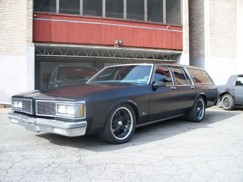

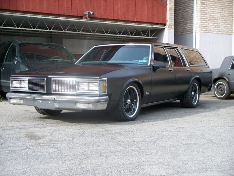

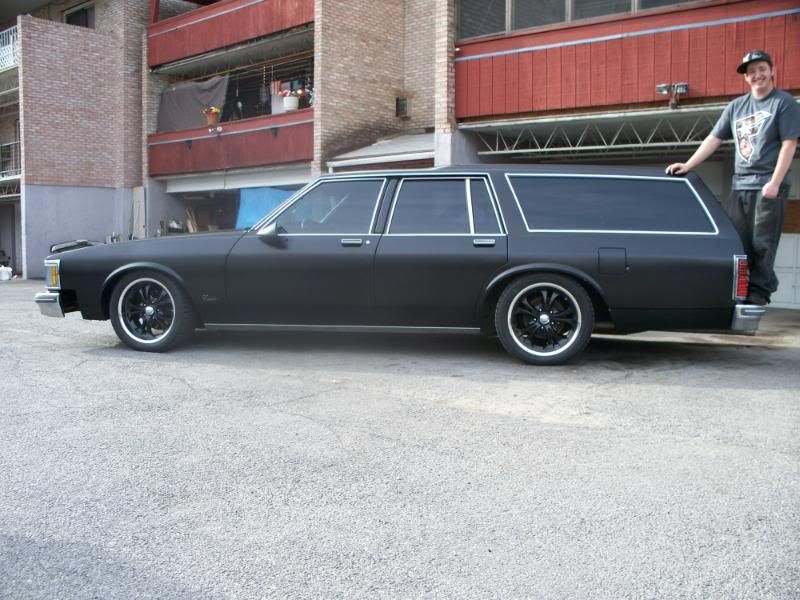

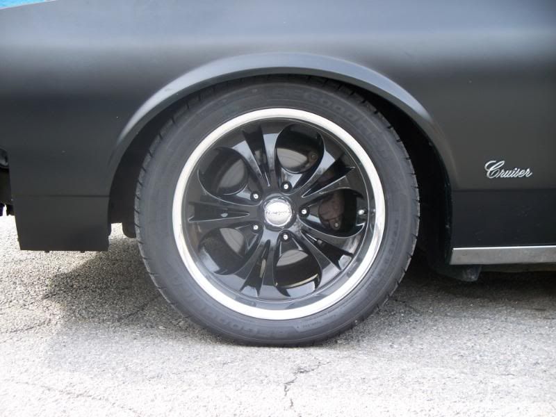

    So here's what you have missed. I rebuilt the front suspension with Energy Suspension bushings and I took the Eibach springs out of the front and put the F41 RPO code springs back in. First I took a half coil off and it brought it down to the level of the Eibachs and I wanted more of a drop. SO I hacked off a whole nother coil. That might have been more extreme then I had originally wanted. But the looks and ride are perfect. So I got way lucky. Here's some picks.
    Here's how I want the rear to be with some help from a friend.

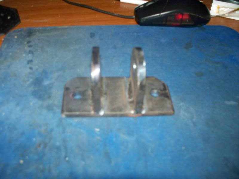

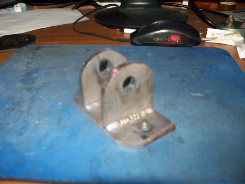

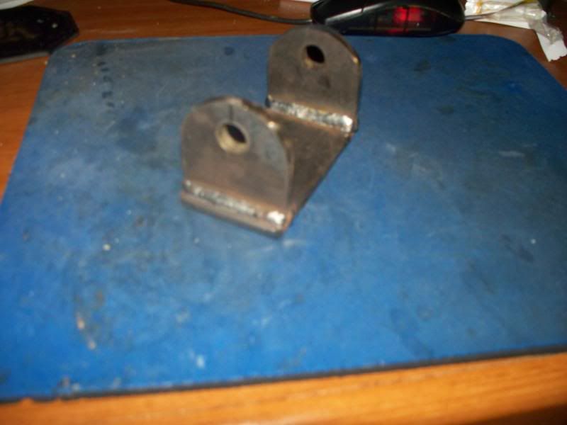

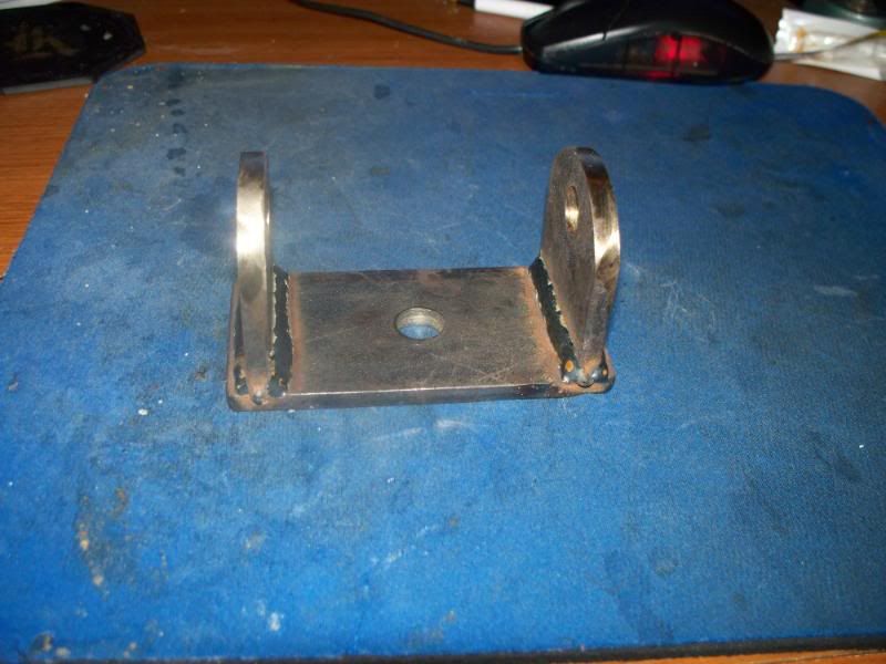

    Here are some coilover brackets that my wife made. Problem is I have 2 pair of Coilovers that are too long so we have to figure a way to find the extra space for them.
  9. Stormin' Norman
    May 30, 2007
    19,625
    34
    813
    Wow! Sure makes it look longer, leaner and meaner.(y)

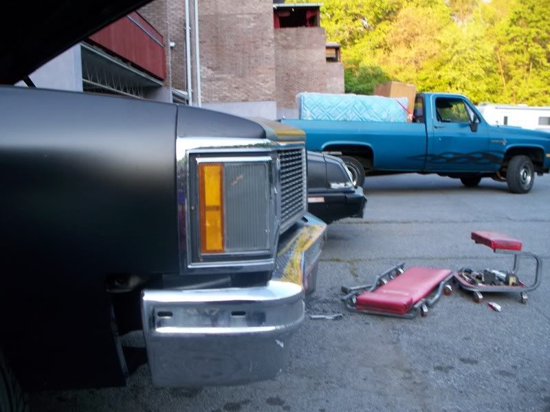

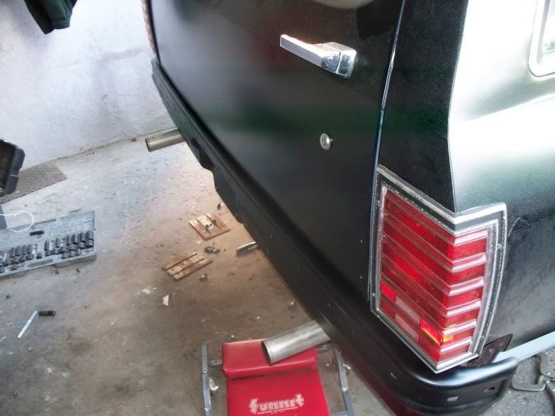

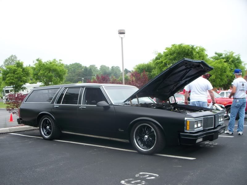

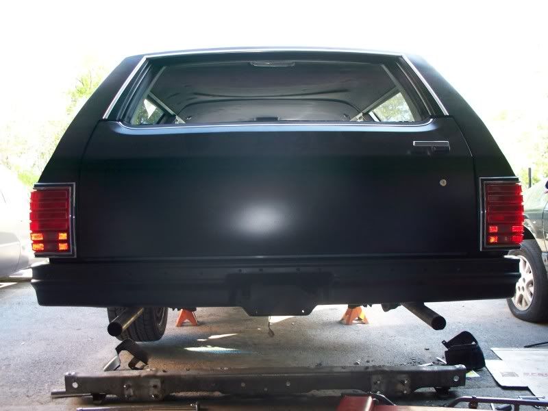

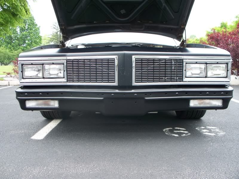

    Well I promised more updates and here they are. Here are some body mods I did with the bumpers. First the front bumpers are tucked in. The one bumper shock was partially collapsed so I collapsed it all the way. Now to collapse the other one I had to drill a hole in it. Then I stripped the bumper down and painted it black.
    Then onto the rear bumper. I stripped it down and painted it black like the front. I took it off the mounts and put it against the body and it looks great. But I have to figure out the mounts to get it right but here is how I want it to like
  12. Fat Tedy
    You know, that looks dam good(y). The front end though, to me it mite look better with the grille blacked out also and just leave the chrome around the head lites. Don't get me wrong, it looks great but it almost seems like too much chrome now that the bumper is black.
    But in the end, it's your wagon.:tiphat:
  13. Stormin' Norman
    May 30, 2007
    19,625
    34
    813
    It's far more realistic the way you've done it. A 25 MPH bump would crush those shock absorbers and crunch the sheetmetal.

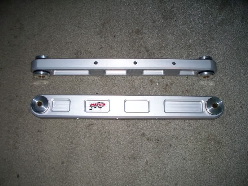

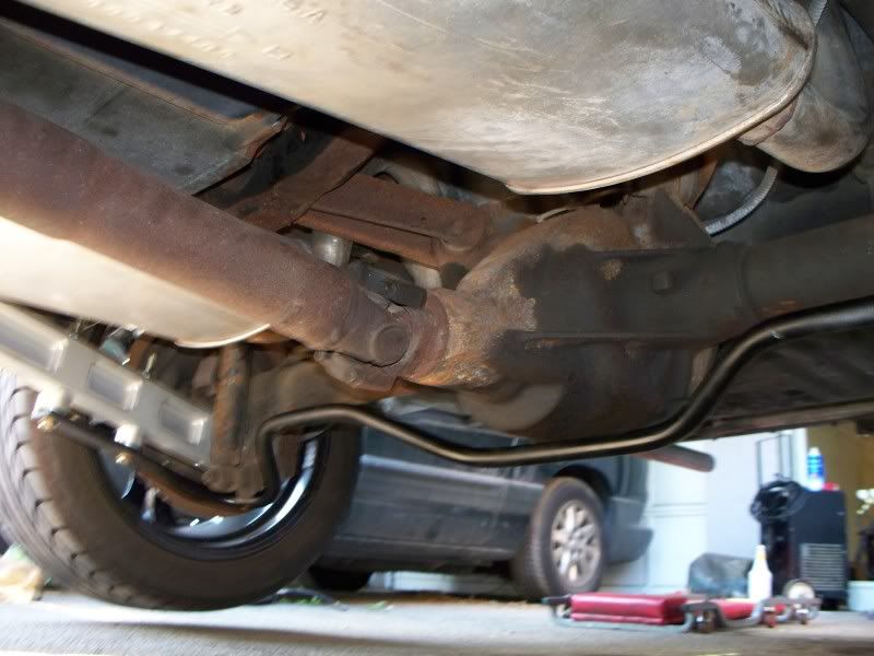

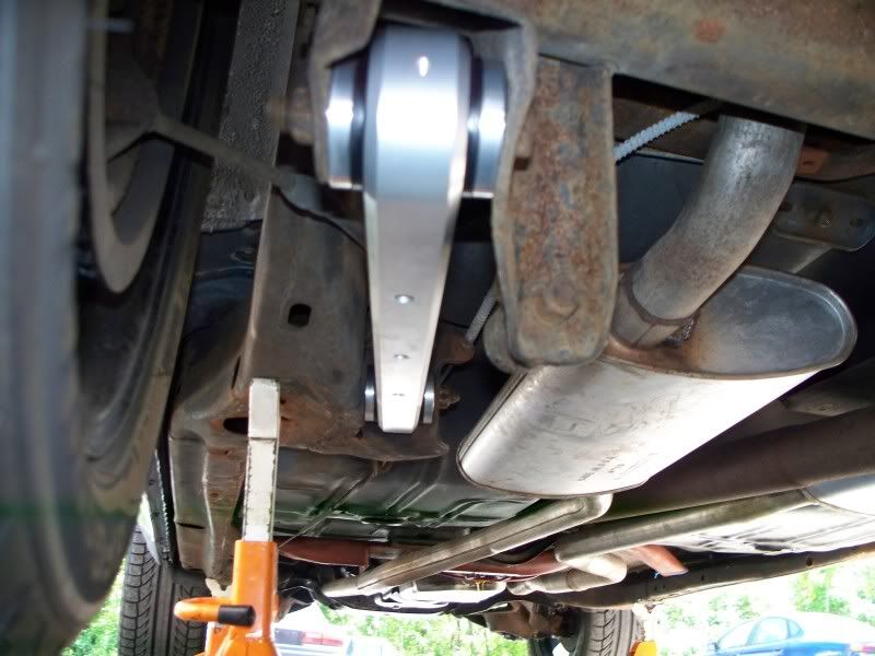

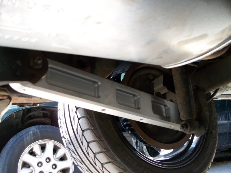

    Here is the rear suspension mods I have done. These are my Metco Billet Aluminum LCA's. I really like these arms. They are very nice quality pieces.

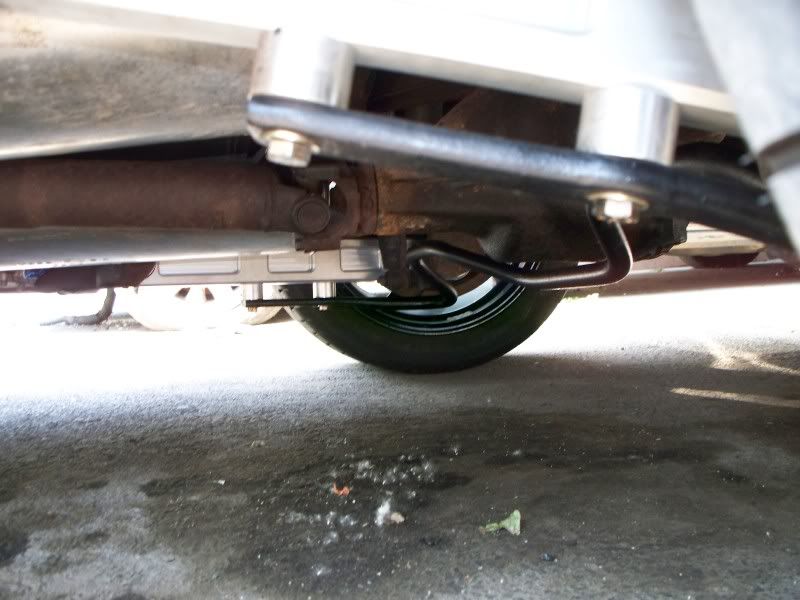

    They allowed me to mount a sedan swaybar on may wagon until I can get a set of much bigger wagon bars.
    Here are the arms mounted without the swaybar mounted.
    Here it is with the swaybar mounted.

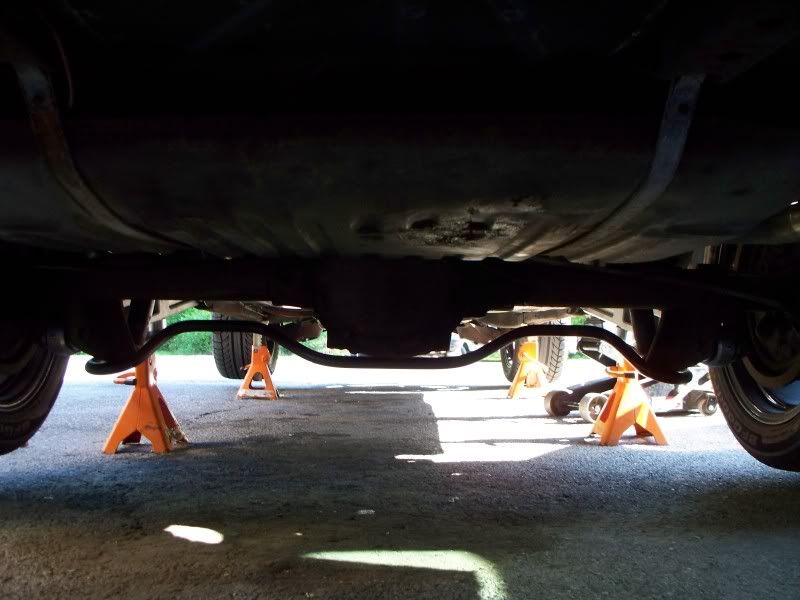

    ANd here is a pic showing the twist in it.
