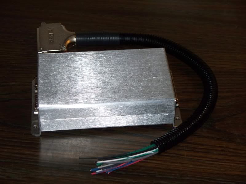

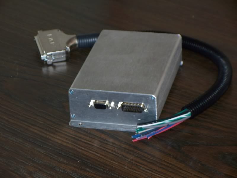

    Looky what I just got in the mail. It's a new MegaSquirt II v3.57 with wiring pigtail. I am so excited. I have been looking at their site and some of the info and videos and it seems like this will be a fairly easy conversion. Now I just need to clean up my intake to get it sent off to have the bungs welded on and drilled out for injectors and the fuel rails put on.
  9. Stormin' Norman
    May 30, 2007
    19,625
    34
    813
    Winnipeg, Manitoba, Canada
    Satin finished no less! Will Twig's car keep up after that upgrade?:biglaugh:
  10. The Stickman
    Nov 26, 2008
    1,316
    9
    111
    Lehigh Valley pa
    Actually I am finding doing EFI with a MegaSquirt is not that expnsive or hard so once we do mine and get it figured out we will be doing her's. But I am looking for a dual quad intake for hers and will run dual TB's with her scoop on top of them. Should be pretty trick. I so can't wait to get started on this mod though. I have to clean up my intake to send off. I need to either get another tank with the fuel pump in it or find out if I can put one in my tank. Then run new fuel and return lines.
