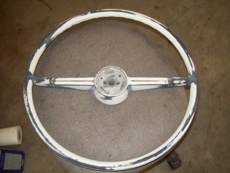

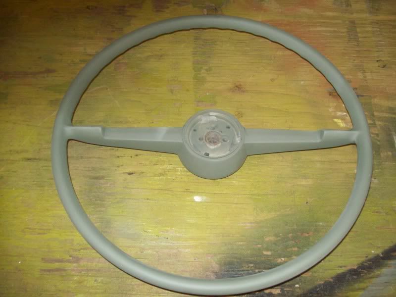

    I guess this would only apply to the plastic style 50's & 60's steering wheels with cracks but this is how I did the wheel on the "Ranch Wagon".
    There are many different ways to repair a steering wheel,,this is how I did mine.
    I decided to repair my cracked and damaged steering wheel for the '54 "Ranch Wagon" and thought my photo's might inspire someone that is thinking about repairing their own steering wheel.
    This is what I started with,
    Basically the wheel had a lot of chips and hair line cracks,,and a few really deep cracks that need filling.

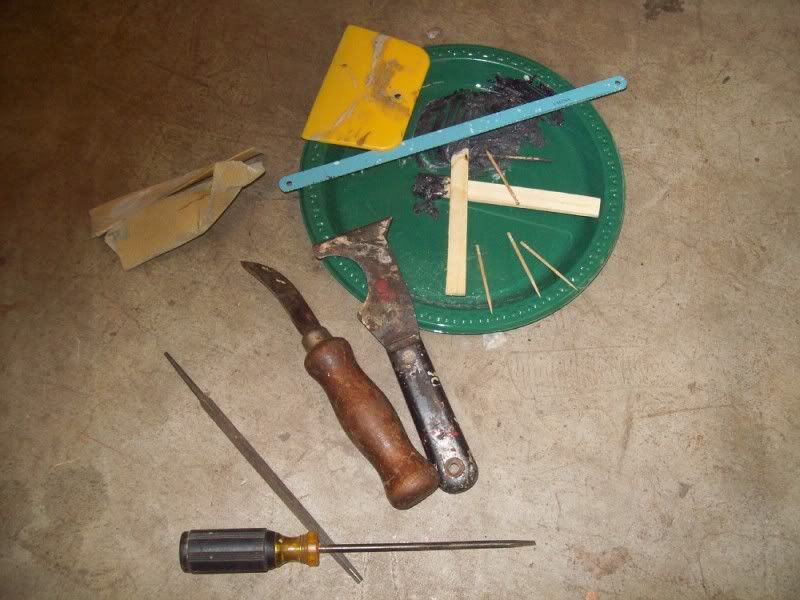

    The tools are simple and I would think most of you have them in your tool box,,or in a kitchen drawer.
    files,assorted utility knives,hacksaw blade,sandpaper,bondo spreader,assorted toothpicks and pieces of wood and a screw driver,,and PC-7 epoxy,,your tool list may be different but I think you guys get the idea.

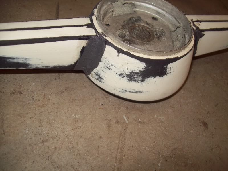

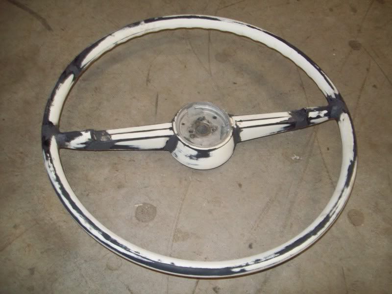

    After all the gouging and spreading the cracks to get a slight V groove I started trying to wipe the PC-& on smoothly with the plastic spreader and small pieces of wood,,it became quite apparent within a few minutes that I had the best spreader for the job attached to my hand,,,my fingers worked extremely well.

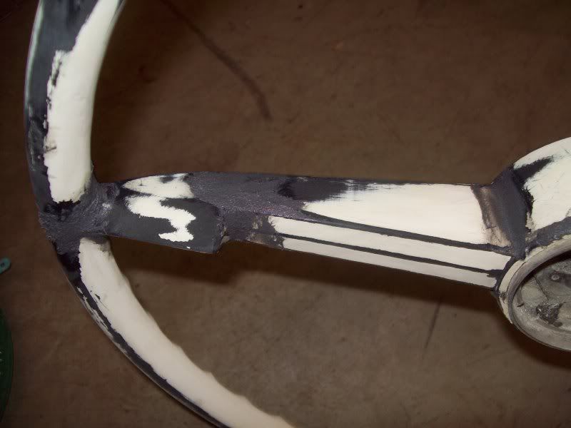

    At this point I let it dry until the next day and started to sand,,I'll point out my mistake now so you guys can avoid it,,this stuff doesn't sand as easy as you would think so smear it on just enough to cover the chips and cracks,,don't cake it on in spots like I did.
    This is what the wheel looked like after a few hours of sanding,,I did have to go back and address a few small hairline cracks I missed.

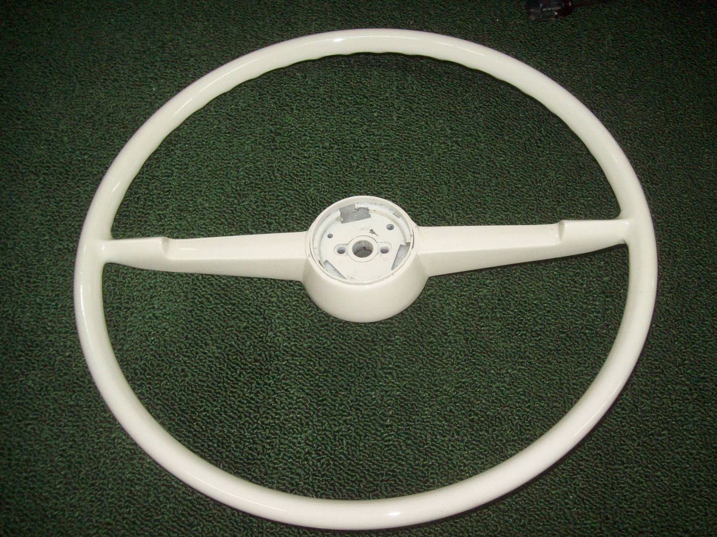

    After the final sanding I wiped the wheel down the final prep and shot it with etching primer.

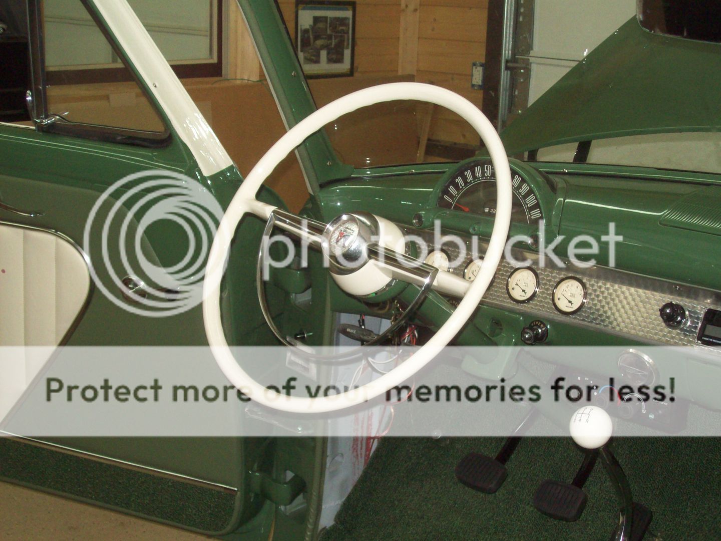

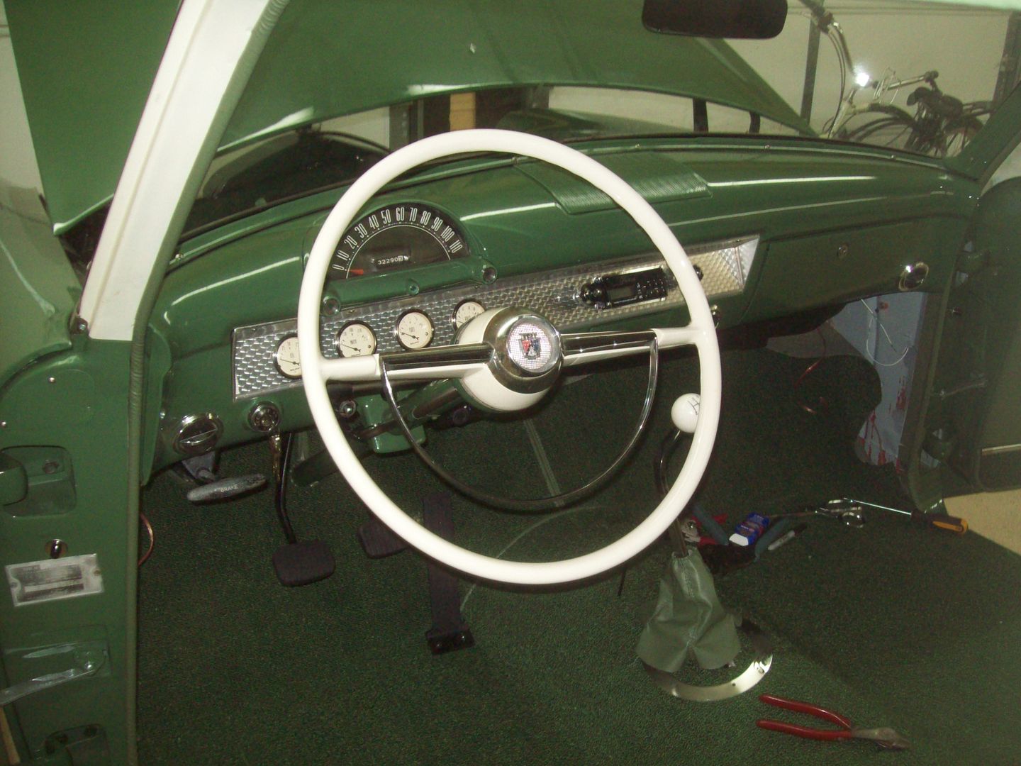

    At this phase of the project the wheel sat idle for a while,,the time between priming your steering wheel and painting it may differ from my time frame,,you could paint it the next day,,mine got put on hold for about a year and four months and it finally got painted this past Friday.[​IMG]
    And this is how it looks in the wagon.
    I used the same color on the wheel as the outside window trim,,Dupont urethane base coat/clear coat.
    I think it turned out pretty good. HRP
