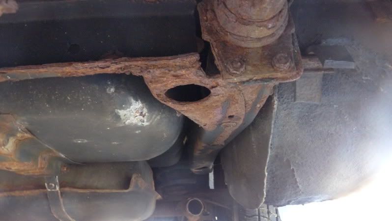

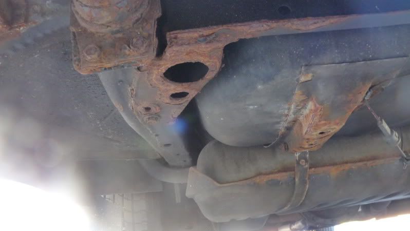

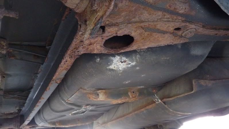

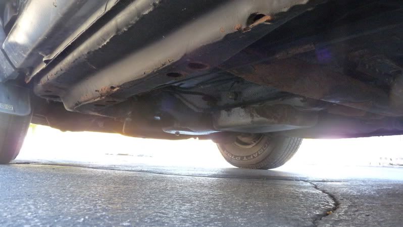

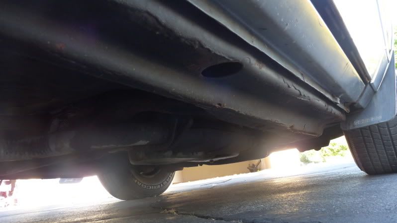

    Anybody seen this product before? This sticker is in the window and according to the previous owner, his father, the original owner had this done.
    It seems in some places there's evidence of a coating but in others it has been eaten through or just not strong enough to prevent the rust. Then again, maybe the coating has slowed down as much as possible what happens to a car from Michigan.
    If I want to POR the frame, do I have to get what's left of that coating off?
    Driver Side
    Passenger Side
    The rear and bumper area is the worst.
    The doors are really shot so although I'll prob POR them, I'm still going to pick up clean ones when I get the chance. I'll use the opportunity to learn as much as I can can for future reference.

    Moliva...I've got good news, and bad news. The good news is that if you've got the youth and ambition, you can get this car to look half-way presentable. The bad news is that the quality of your pictures reveals some serious chassis deficiencies. If this car was of historical (or sentimental) significance, it could be saved, but it's time to start runnin' some numbers here.
    The pictures show some serious metal-loss (~30-50%) at the bumper-struts, and this is all that is between your family and the cold, cruel world. If the body was other-wise sound, you could consider dropping it on a donor frame, but we're talking some serious effort. Rather than nickel-diming yourself to death trying resurrect the dead, you might be well-ahead consigning this car to its fate, and saving your money to buy a better candidate in the not-too-distant future.
    Even with a full frame-off strip-and-dip, the visible losses on the frame only anticipate further concealed damage. This car's only a coupla' pot-holes from major frame fractures, and we're not talkin' GT500 Shelby here. To be a bit brutal, you could spend the price of a new wagon, and still have only coin-toss odds of catching all of the rust on this car.
    If the majority of the interior is in good condition, you could probably find a matching (otherwise solid) car with beat seat-covers for far-less than you'd pay just for sand-paper and chemicals. Even if you give your hobby-time credit for minimum-wage, you can anticipate several hundred hours here. I'm sorry for the "cruel to be kind" assessment here, but sometimes it pays to take two-steps back, and add things up before we get in too deep...Cheers...
    Edit...Regarding the Tuff-Kote Dinol "RUSTPROOFED", I guess they lied, huh...

    Stang has good points. The money it will take to TRY and get rid of the serious rust would be better spent for a rust free car. Not to mention all the long hours of hard work. Michigan has taken its toll on that one. That's my :2cents:
  12. Fat Tedy
    Even before I saw the under the car pics I had serious douts but did'nt want to say anything. It's your wagon and you clearly like it and so many posts followed giving advise, good advice on rust removal things got cloudy for the big picture.
    Stang did what some times is the hardest thing to do, being upfront and honest with a friend, fellow member. I know and can tell you love your wagon but the old girl is pritty far gone IMO to be repaired at a justafiable cost. I went through the same "what to do" with my last Fox wagon, not rusted but smashed from being stolen. Yes my wagon was repairable but it was'nt worth the cost and I only came to that realization after I had bout some parts for repair. Some times ya just have to let them go.
    I'd keep your wagon, drive it this winter and enjoy. If anything just buy a couple rattle cans of as close to colour match paint and cover the rust where you grinded as best you can. Look for a wagon that yours could be a doner for. You never know when you just mite find a non rusted one thats in need of TLC, you have all the trim, moudings, glass, interiour, etc, etc.
