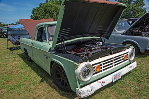

    Just got the new adjustable throttle linkage bracket in the mail today. I also made an extension to the throttle cable at the machine shop at work. I will be playing with that soon. I also have a Lokar trans kickdown linkage kit to install.
    Since I need a good trans cooler because I plan on doing some towing, my buddy gave me one from a Dodge V10 Viper truck. He installed the Viper drivetrain in a 67 Dodge pickup and used an after market cooler. I like FREE things. It worked out very well. Only mods were drilling 2 holes and notching one of the brackets. It dropped right in. A couple of compression fittings and all looks well. It did take me like 3 hours to make up one of the trans lines. I wanted it to look really good so I was very particular. The second one should be a little easier.
    The V10 Viper truck in question. A good friend. I helped him out when he needed an extra hand. Now he's doing all the metal fabrication and bodywork on my 69 Dodge Dart with a 440 big block.
    60Mercman, OrthmannJ and wagoninsane like this.
