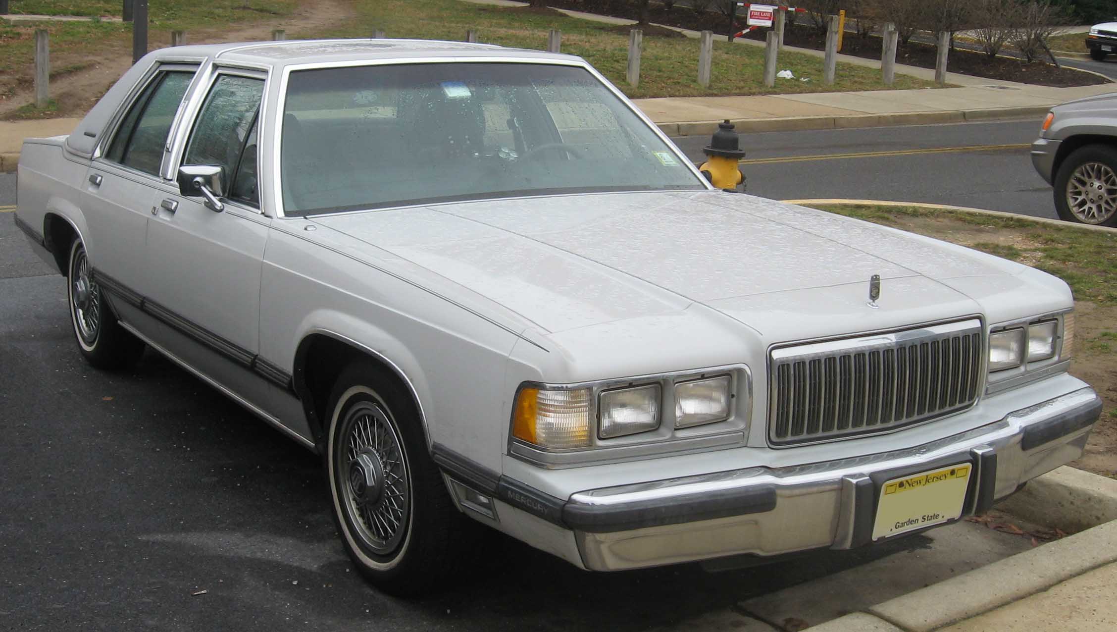

  7. patrick80
    patrick80 Wagonista!
    Apr 8, 2008
    3,083
    93
    157
    OK
    I've been looking at the front sheet metal on my Merc. Then I looked at the front of an '87 Lincoln Town Car...My brain started spinning, and I've come to the conclusion that I can take the Lincoln hood and front fascia (bumper, grille and everything in front of the front fender line), and transplant that to the Mercury...voila! instant Lincoln Town Car woody wagon!
    It does not appear that it is anything other than a bolt-on mod to the Colony Park! Whatcha think???

  12. patrick80
    Apr 8, 2008
    3,083
    93
    157
    OK
    Gotta do something, right?
    I'm off to the local Lincoln/Cadillac scrap yard tomorrow to double-check the fit and interchange possibility. Just looking at pics of the '88 LTC and my '91 GM front ends, suggest this is a bolt-on swap in ALMOST every way. The thing that concerns me is the contour line on the GM is not on the Lincoln. This might require the use of the Lincoln fenders and doors, too. This is hidden by the upper trim of the Colony Park; but, the inside of the GM front fenders do not appear to dip as far down as the TC fenders do. I must take a lot of Lincoln pics and mull this about.

  13. patrick80
    Apr 8, 2008
    3,083
    93
    157
    OK
    Nope. No Lincoln wagon. The big issue is the contour line on the GM, along with the height of the fender peak between the two cars is different. It can be done, but the best way would be to also take the fenders, doors and the upper quarter skins off the Lincoln and do some serious grafting to cover the wagon rear quarter upper contour line. then, and only then, would the build look right. I think we'd have seen others if it were just a front fascia and hood swap.

  14. Krash Kadillak
    20,940
    1,985
    A shame I tell you, a shame.....
    Yup - the beauty lines on the TC don't match up. If you compare Patrick's pics above, you'll see the upper beauty line on the GM is about 5-6" below the belt molding, while on the TC it's only about 2 1/2" or so...... The panels themselves also have different contours, the TC being a lot flatter.
    I maybe have seen a pic of only one wagon were somebody took the trouble of changing all the outer sheet metal on a Colony Park to Lincoln TC stuff. A serious undertaking.
