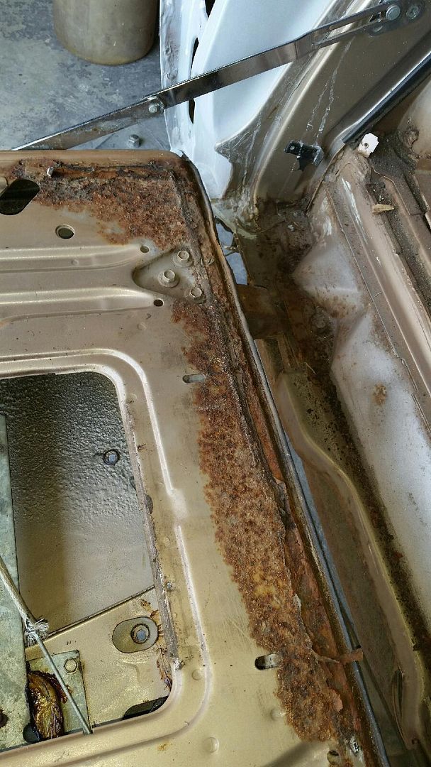

    Nice project, if my wagon wasn't my daily driver I would tear it down like that. While doing the body rust repairs take a good look on the inside of where the tail lights are, that's where my Country Squire had the most rust. Water leaks from the back window and the trim mounting holes caused that.

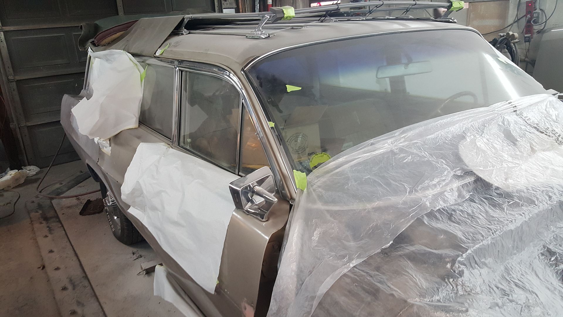

    sanded the quarters and put some more guide coat on them. they are pretty much 100% now

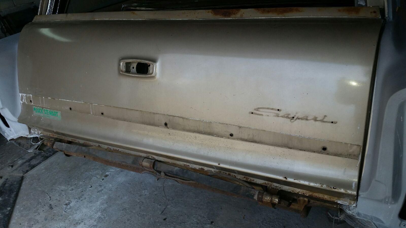

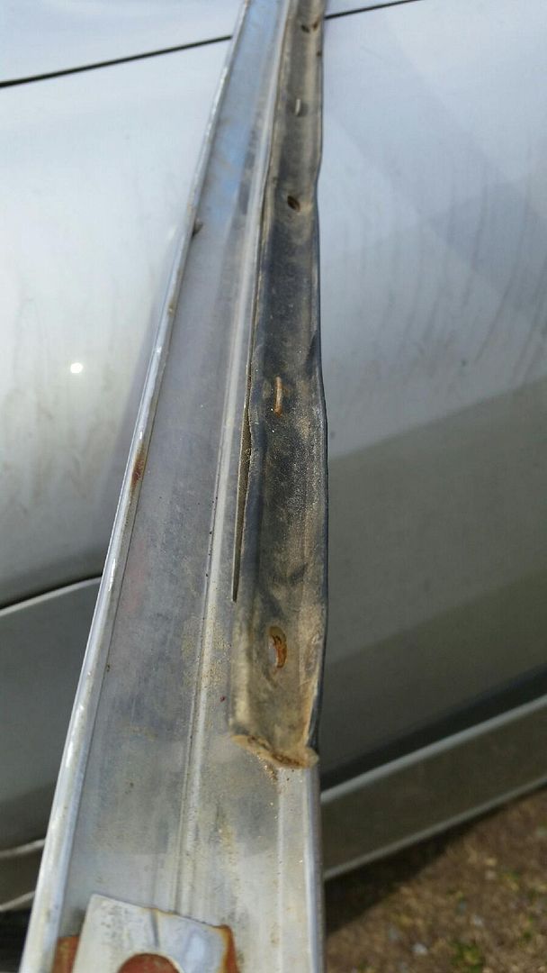

    Tailgate looks a little crusty but my body guy says "Sonny fix!" lol See that metal strip? I need one. Dont know where to get it.

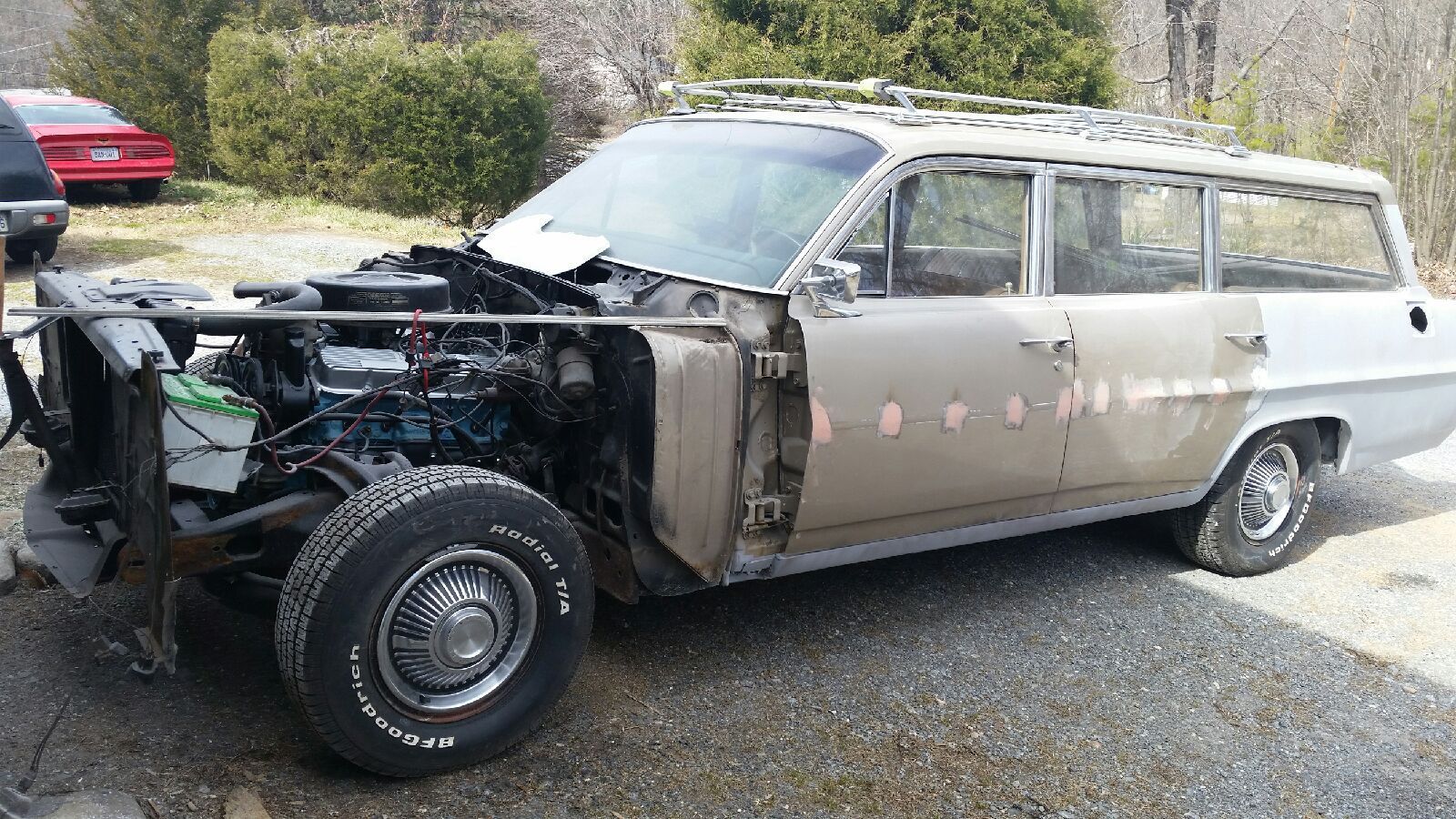

    Pulled it out to work on it

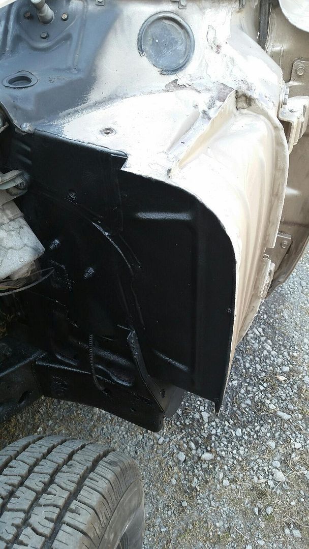

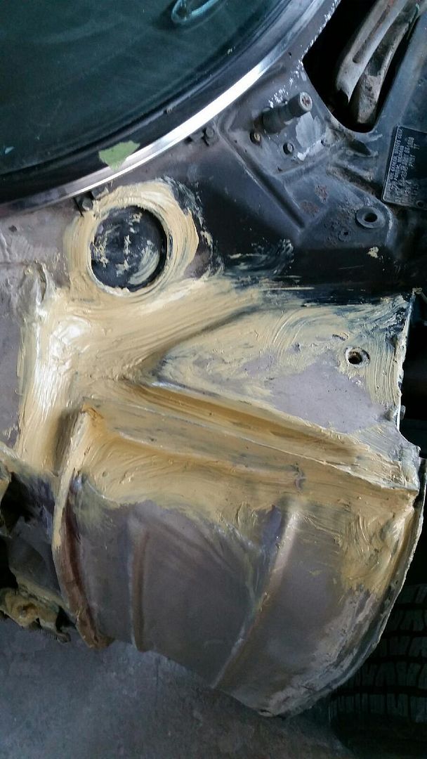

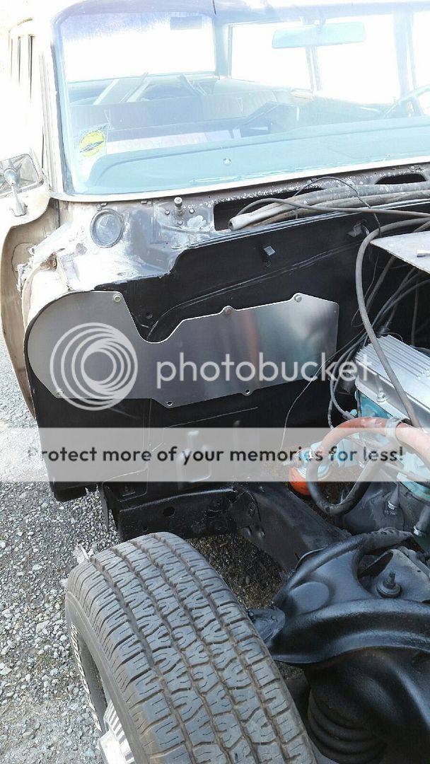

    paid some attention to the firewall. Ended up removing the heater box.
    Installed a block off plate as I will be running an under dash AC unit
    Seam sealer!
    Tailgate coming apart...will need some repair
    Thats all for now!

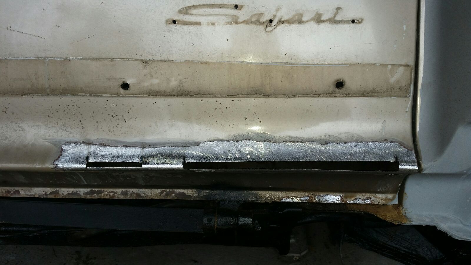

    Tailgate rust repaired

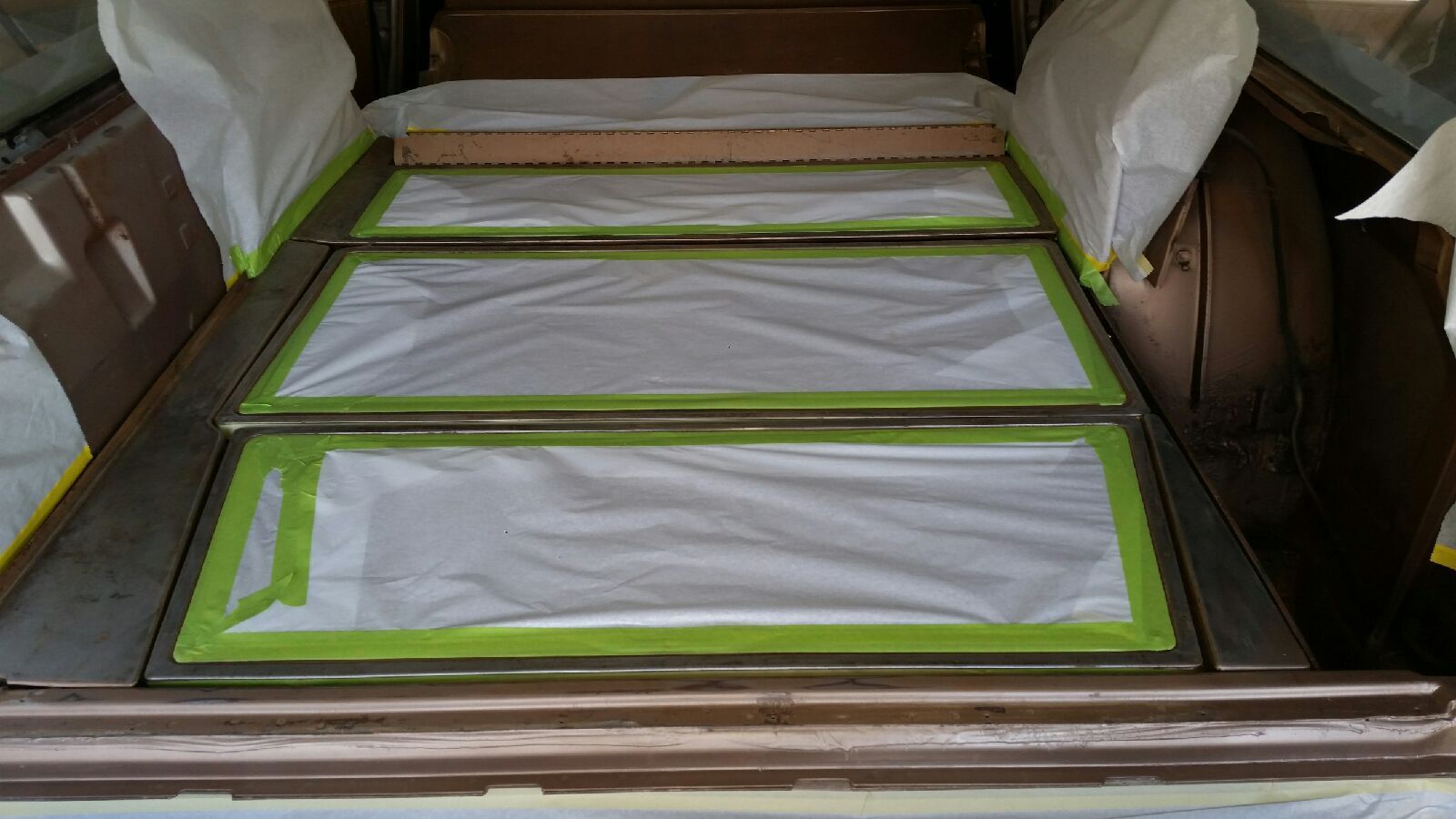

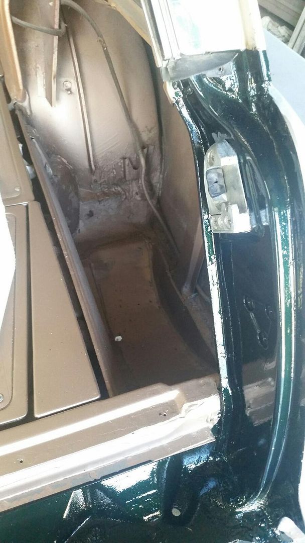

    spare tire well all repaired

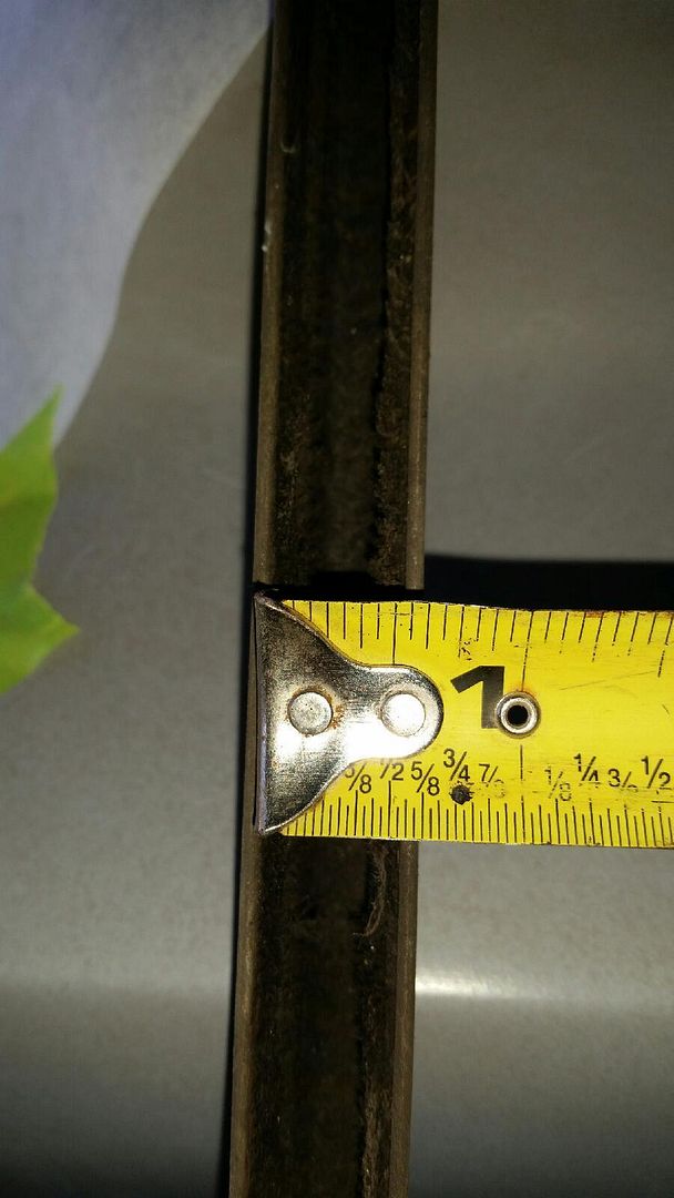

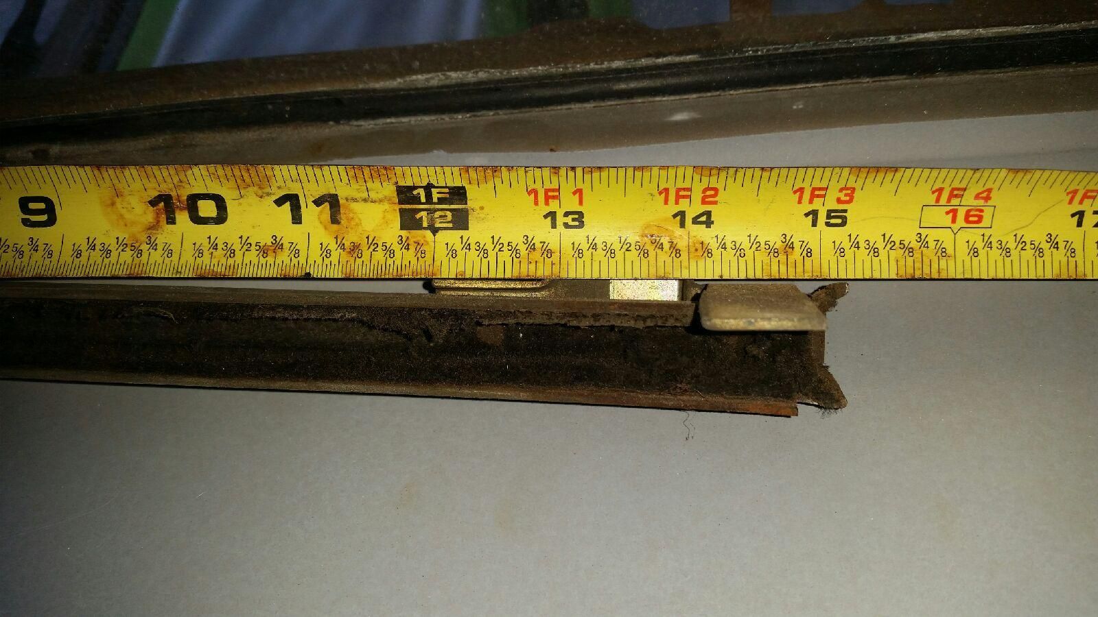

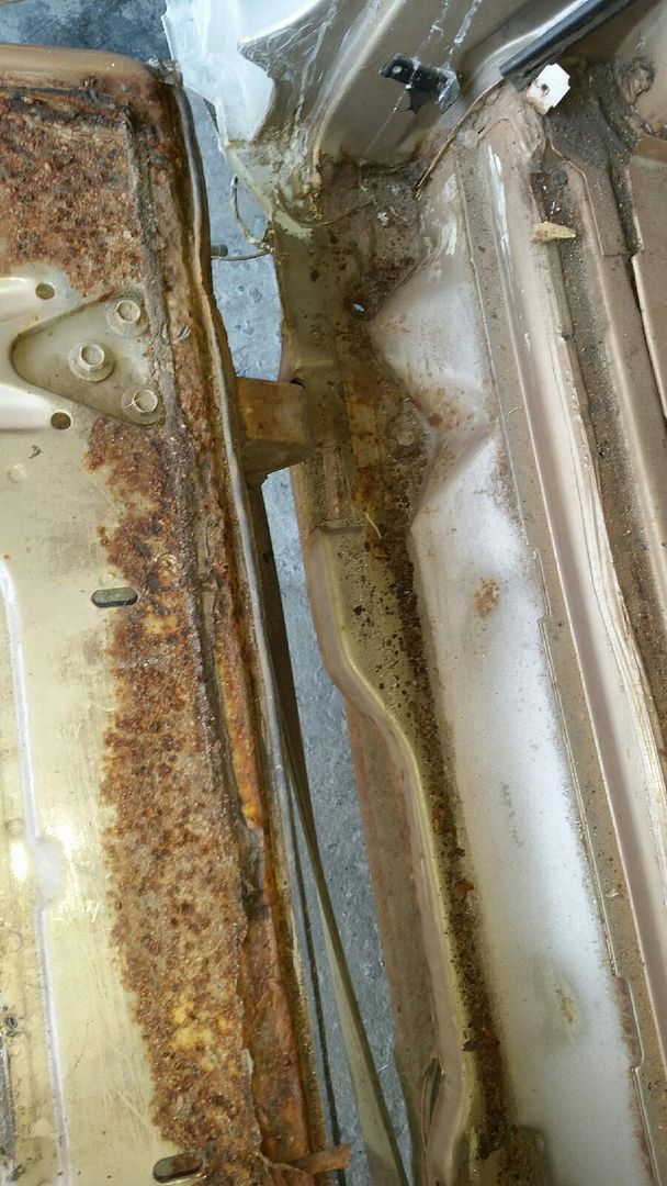

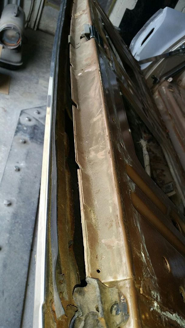

    having a hard time finding window run channels, so he measured the ones from the car and I'm trying to match it up the best I can

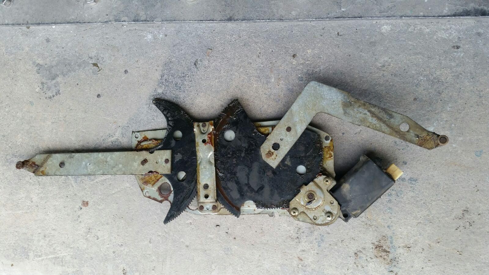

    Tested the tail gate switch to figure out why the window wont go up or down with the key. switch is fine.

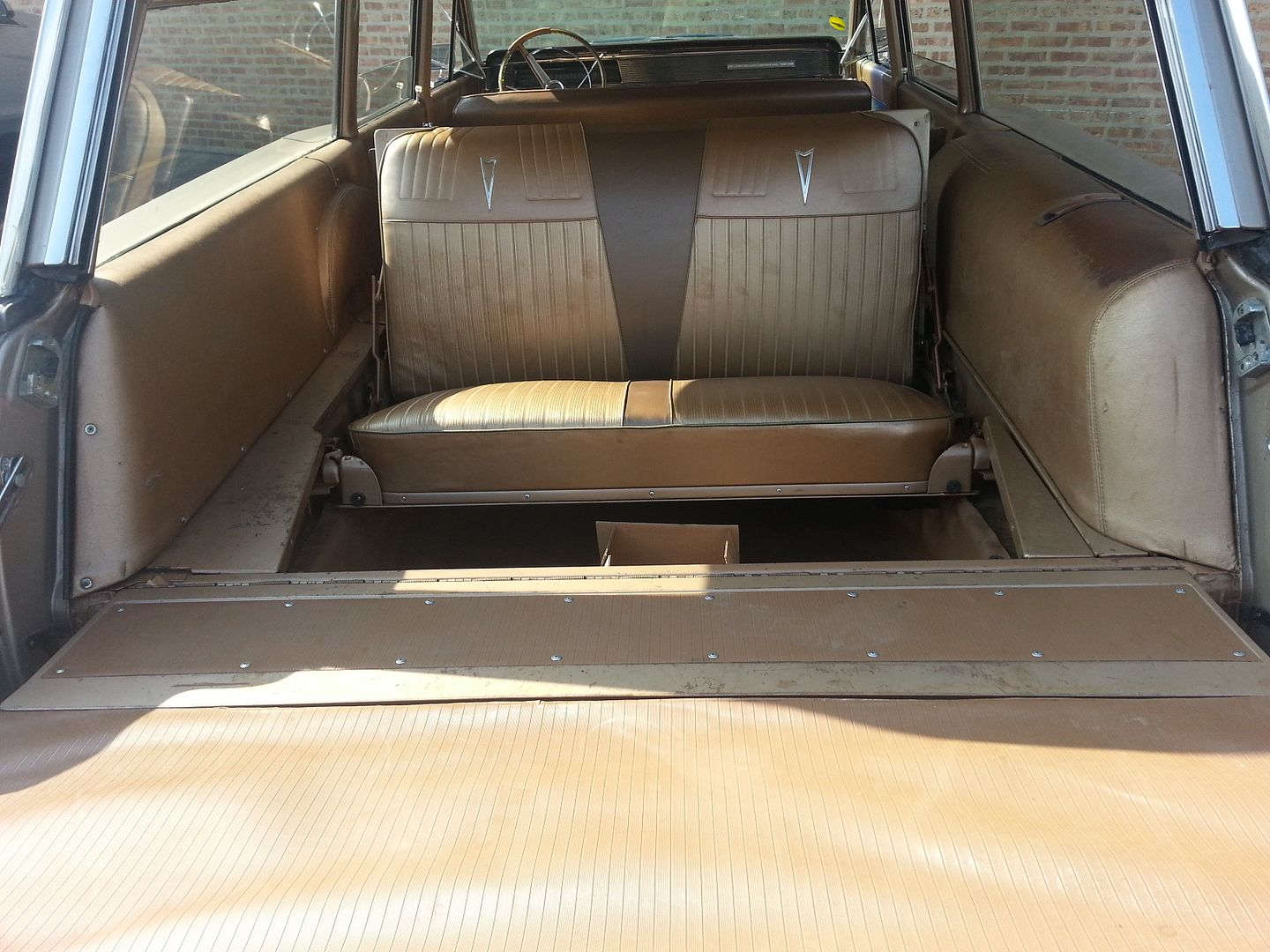

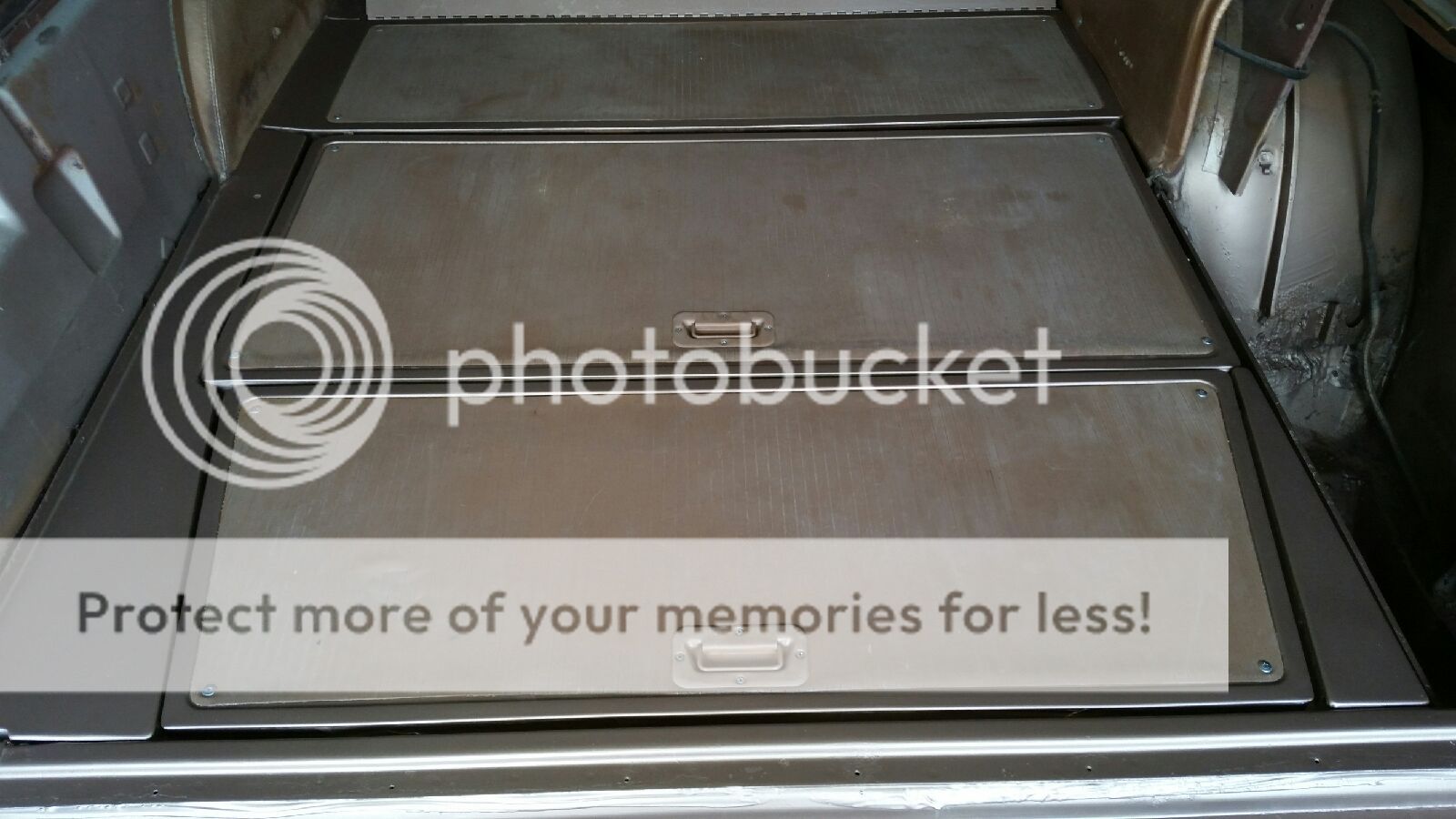

    He painted the interior metal (on the sides of the 3rd seat).
    Before
    During
    After
    I think I am going to have that vinyl removed, and replaced with carpet.

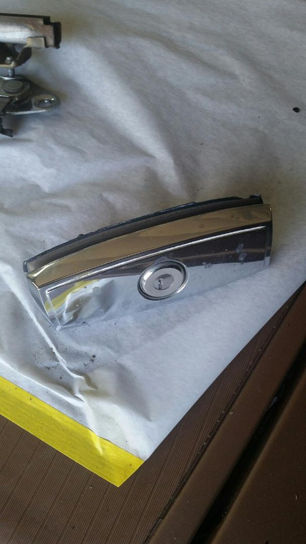

    Brightwork on the tailgate being restored

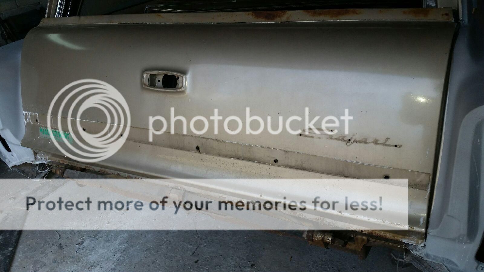

  15. justintiime
    justintiime Active Member
    Apr 18, 2015
    98
    44
    30

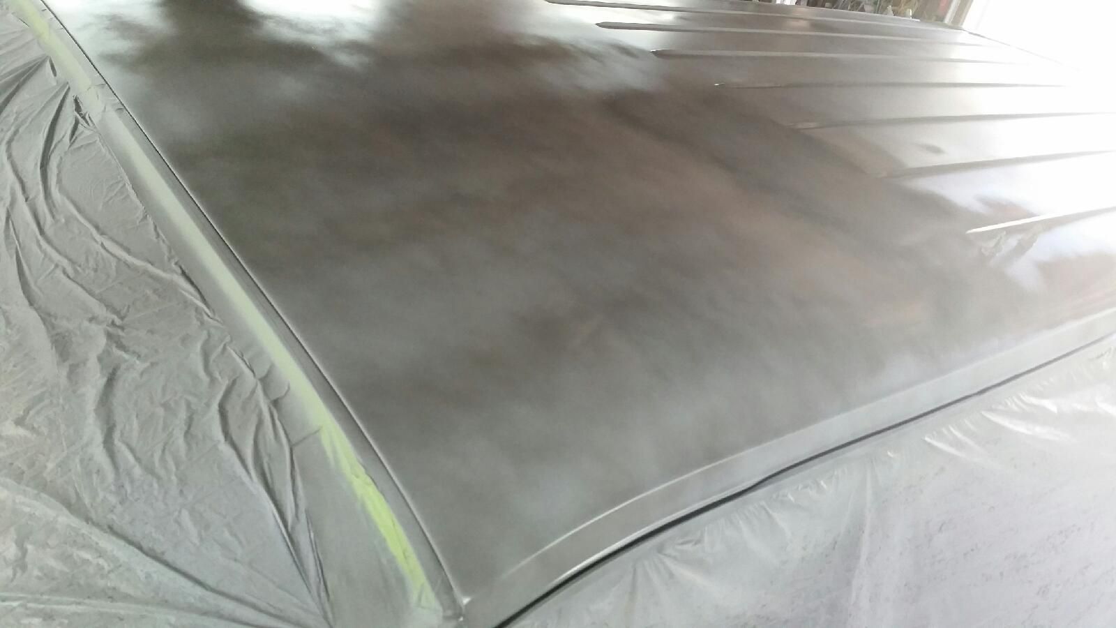

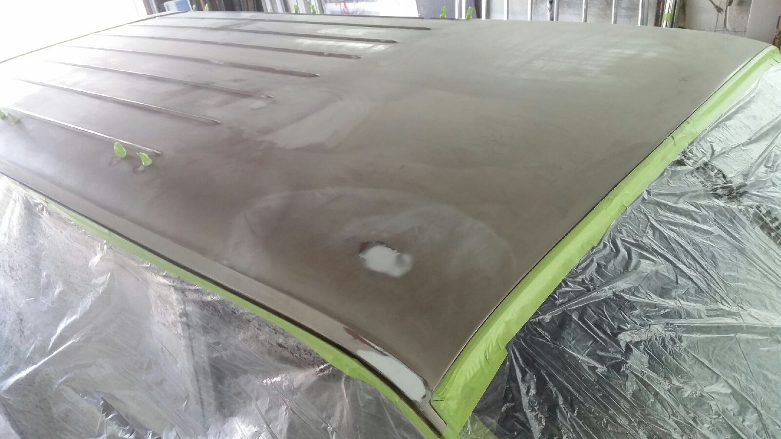

    Couple small holes in the roof being repaired
    guide coat
    primer
    on to the doors!
