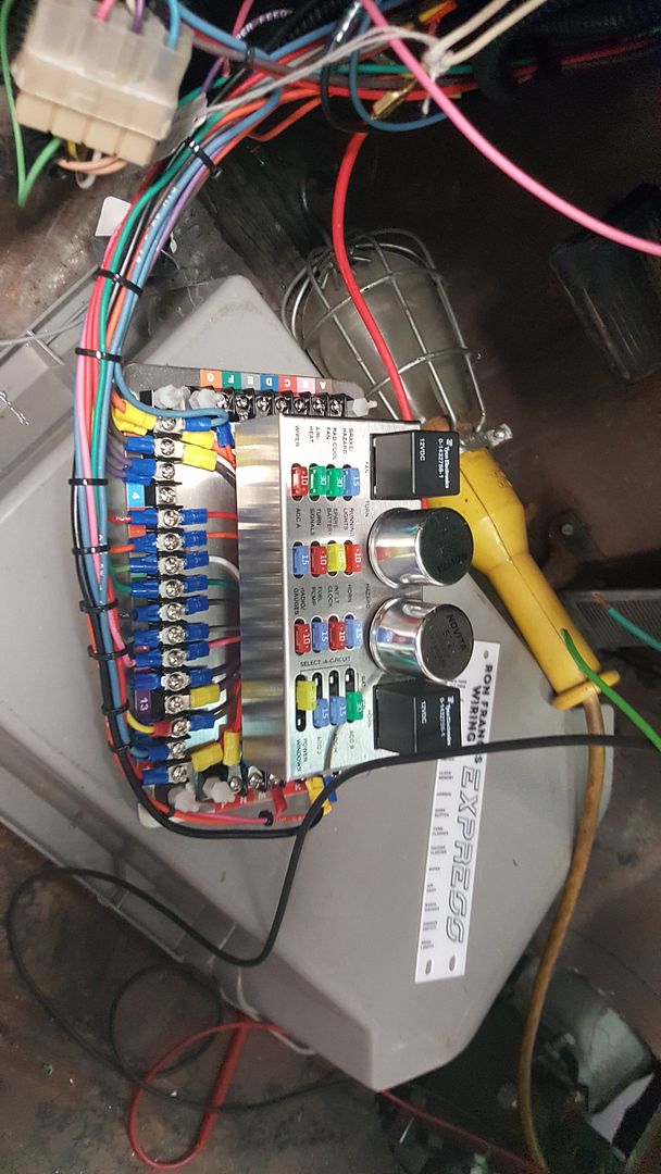

    Not many cool updates right now. Wiring is still taking place and is almost done. The battery has been hooked up and there were no fires, so thats good. I just ordered an empty AC box from Vintage Air, to use for mock up. It weighs 3 pounds and is MUCH easier to hold up under the dash to make brackets, etc. It cost about $80 to "rent" the box.

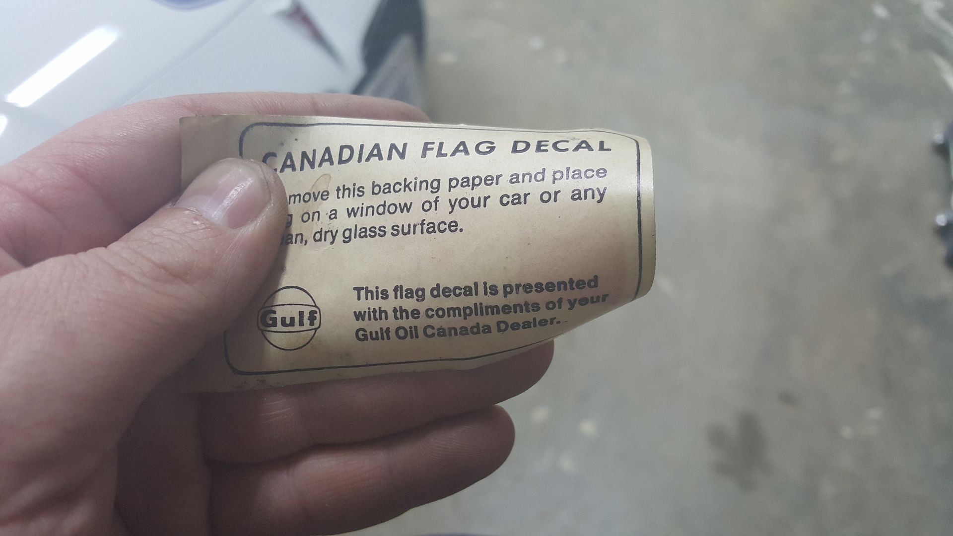

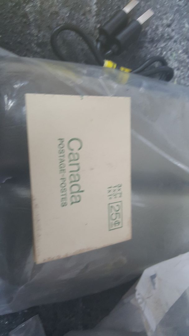

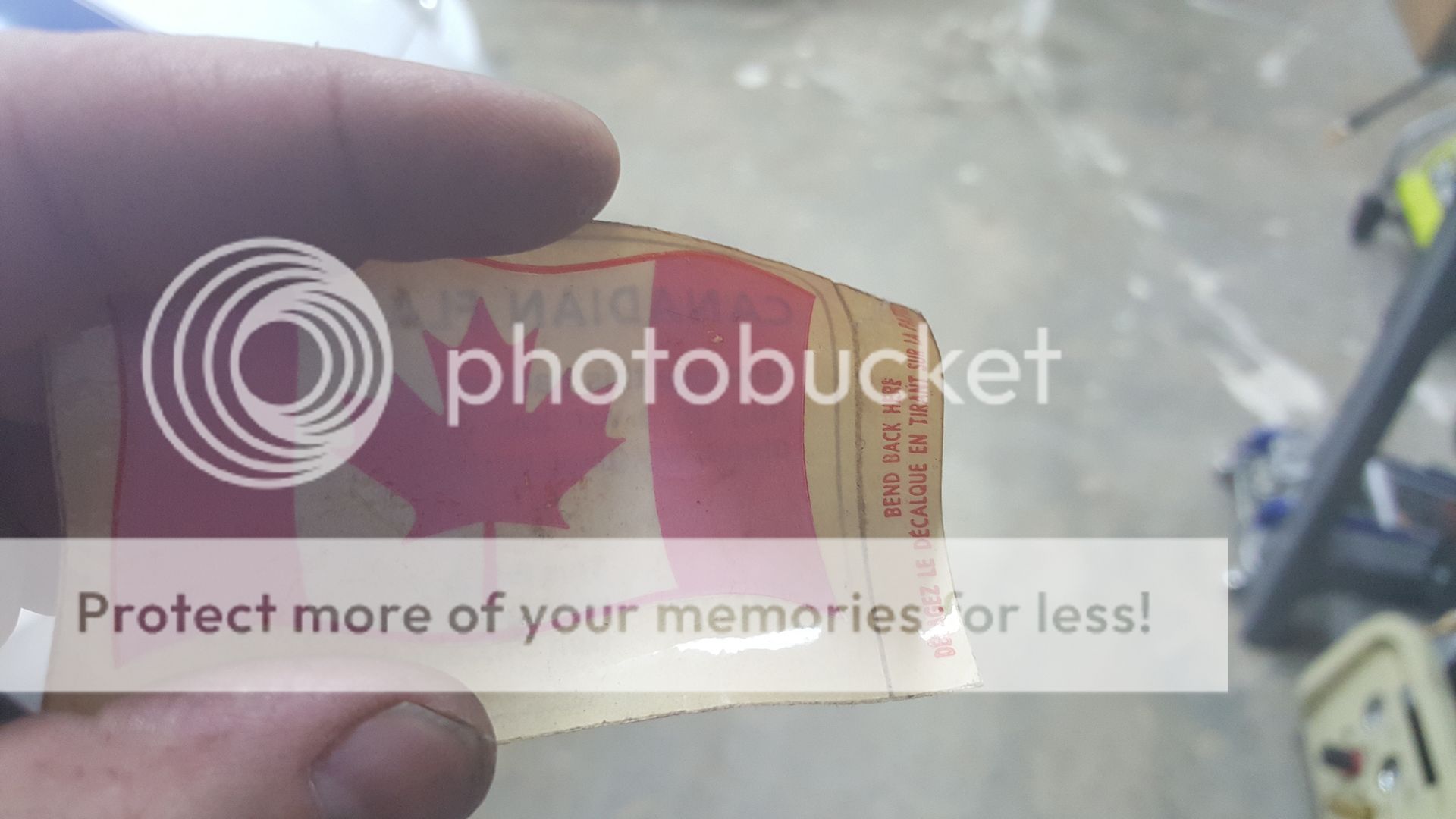

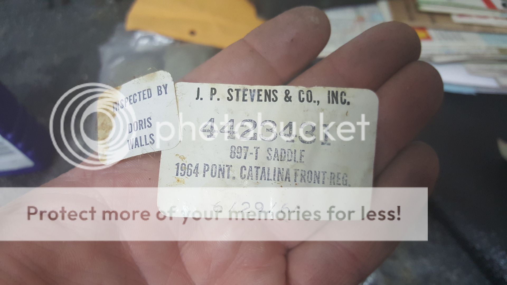

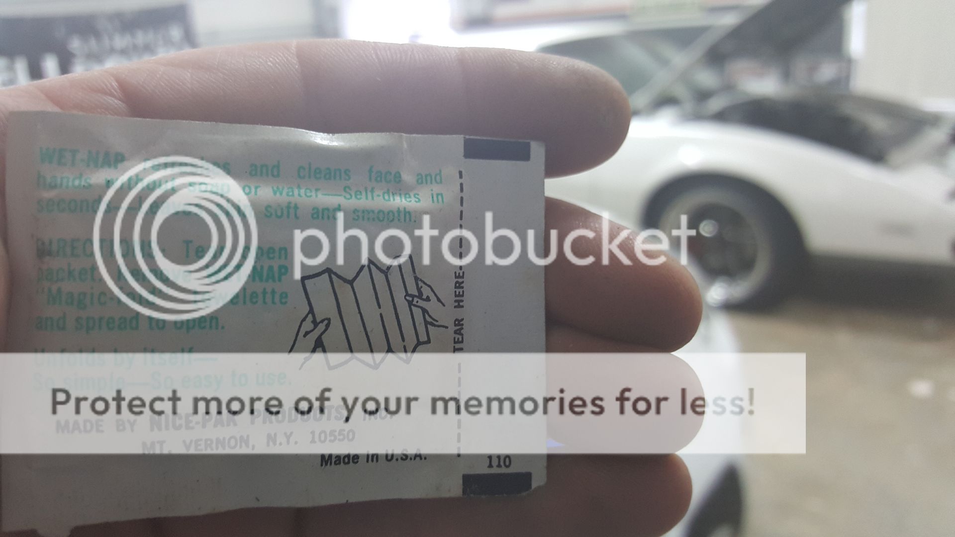

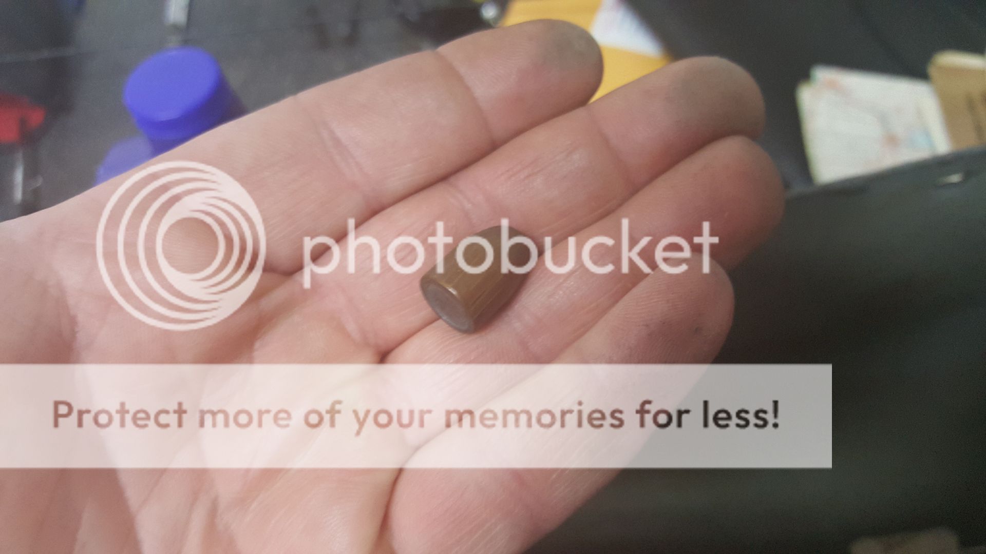

    I picked up some parts that I forgot at the body shop. Included was the glove box. I found some cool stuff inside it. All the old maps confirms the ladies stories of all the trips they took :)
    A bullet?

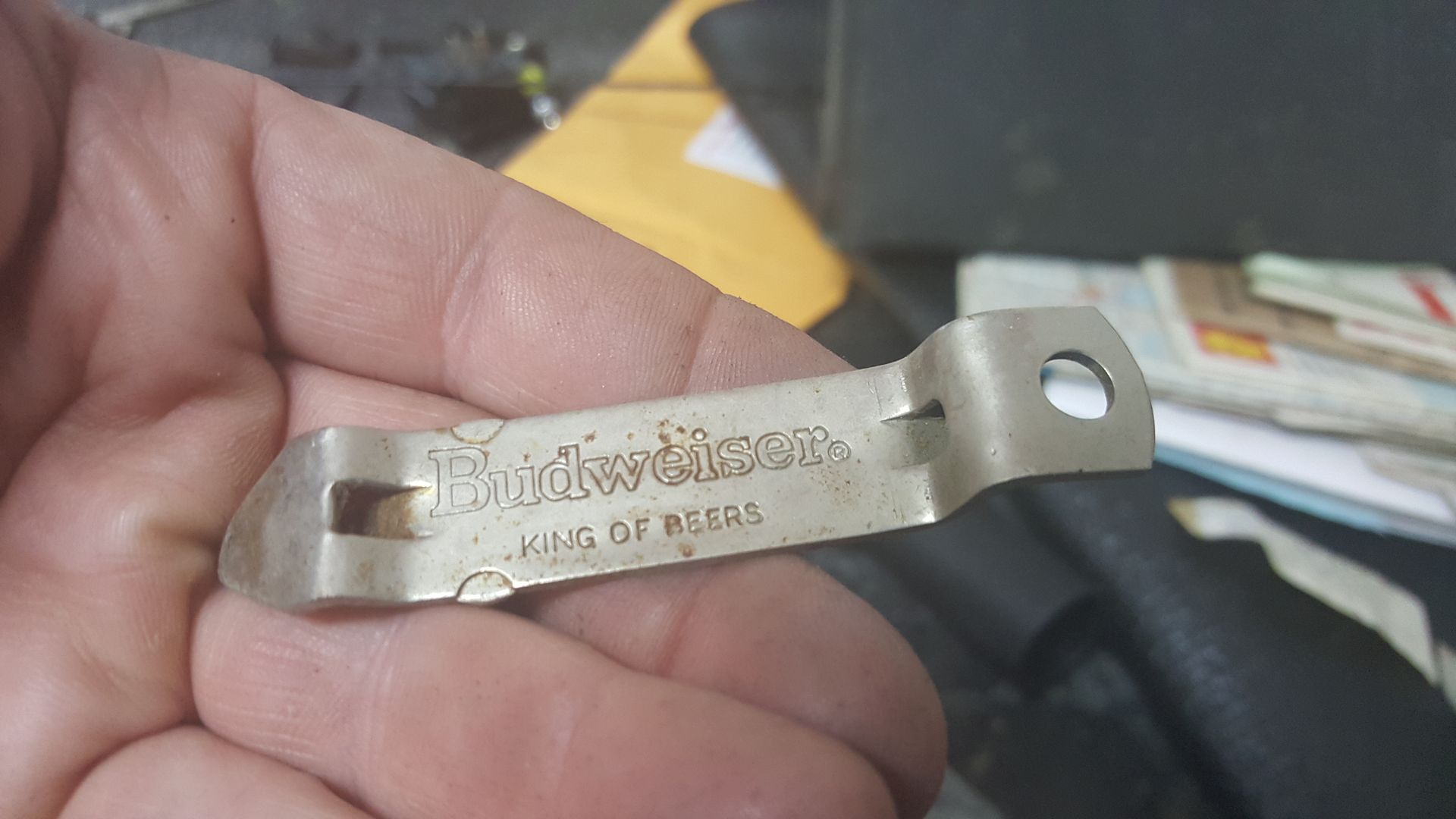

    Old budweiser can opener
    This is one of the companies that provided carpet to GM
    One of their trips must have been to canada
    Maps and stuff

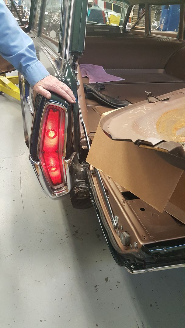

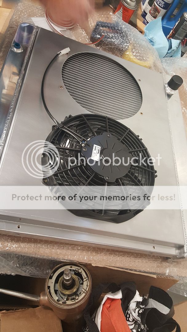

    riv-nuts put in the fan shroud so I can bolt the fans to the shroud, and the shroud to the radiator. All sealed up with rubber strips so all airflow goes through the fans
    spy shot of the ridiculous LED lights. No more low visibility issues :D
    I now have 4 way flashers :)

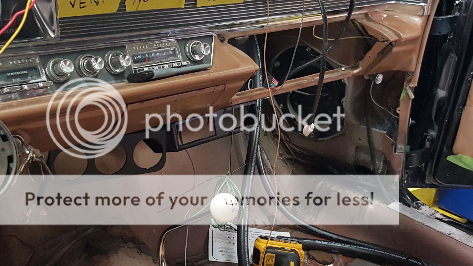

    wiring is being tidied up

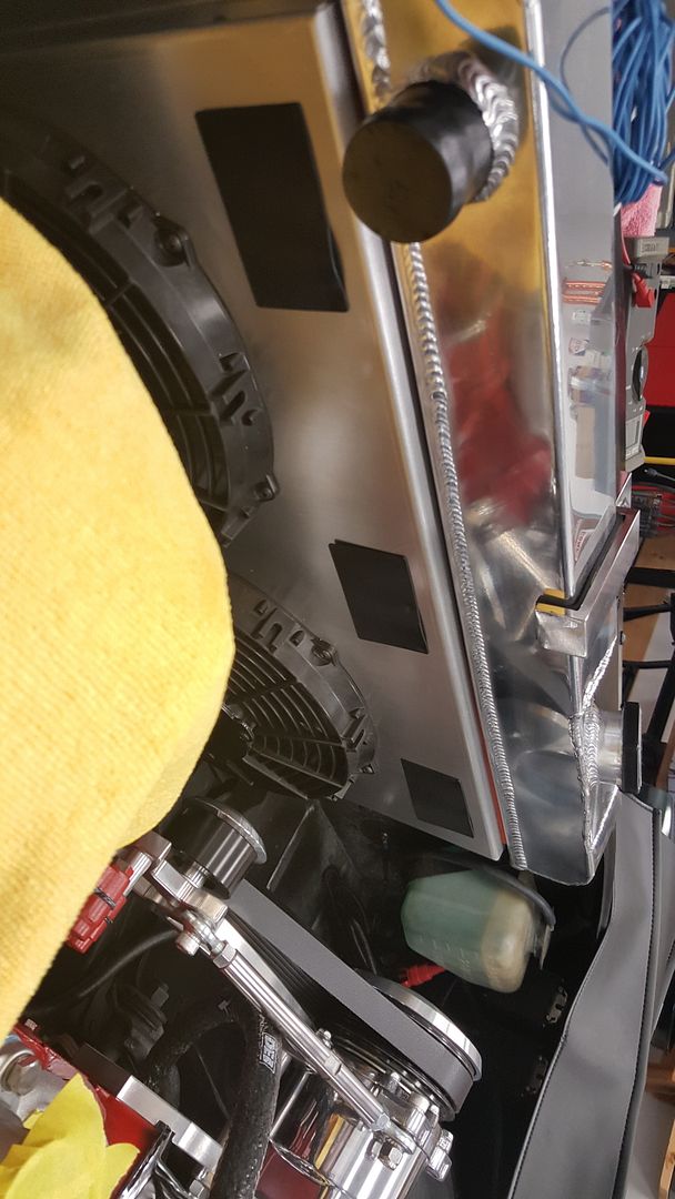

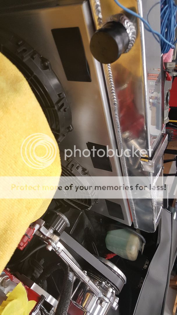

    Cooling fans are wired up
    The black rectangles on the fan shroud allow more air to flow through while driving down the highway by flapping in the breeze . When stopped or in traffic, the fans will actually suck them against the shroud, and force all the air to go through the fans.

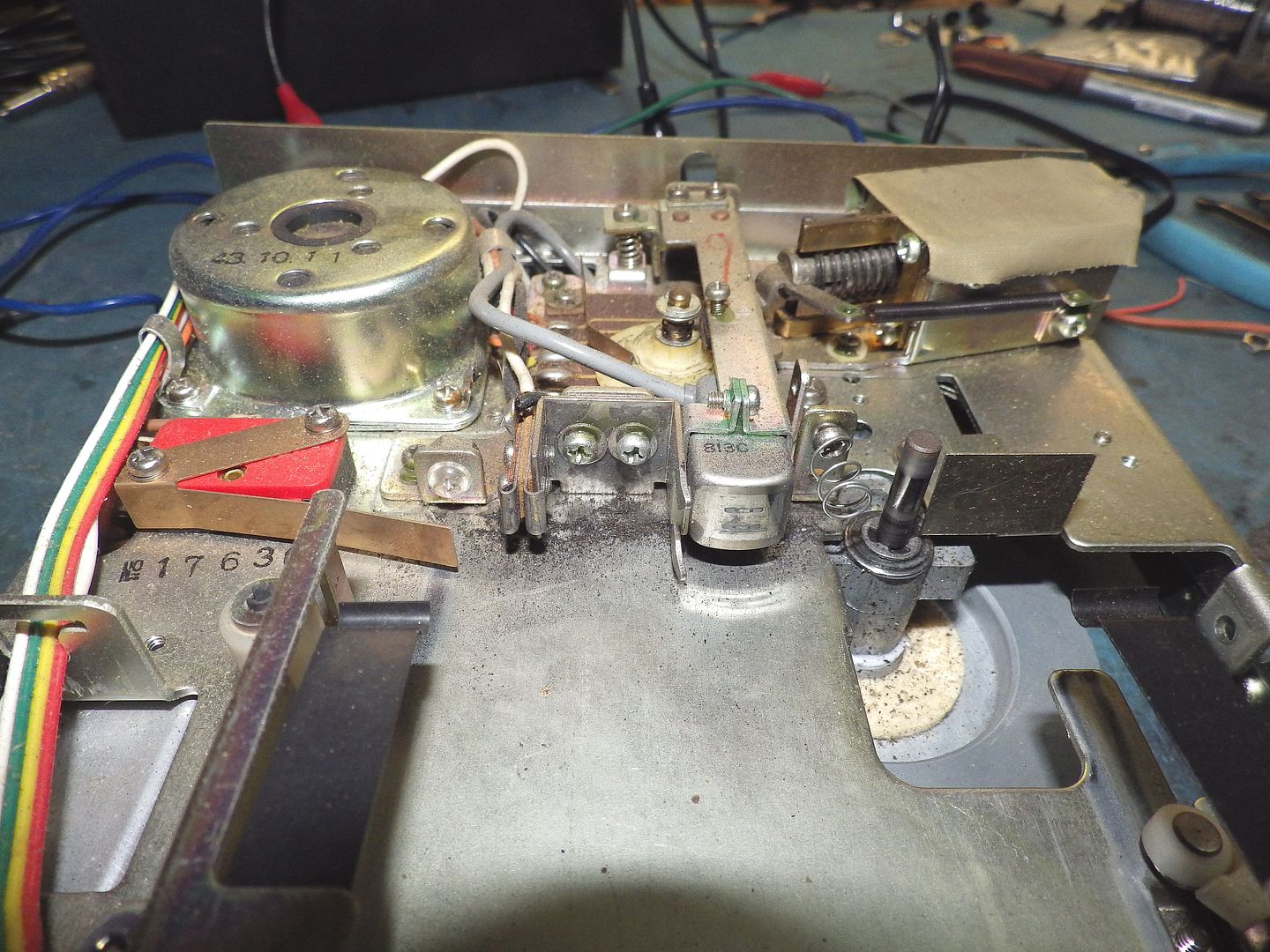

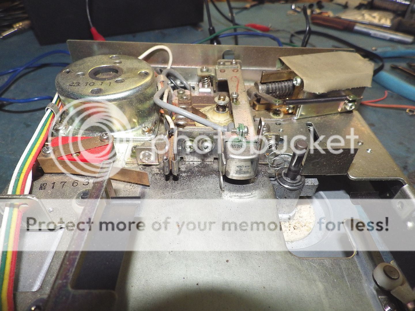

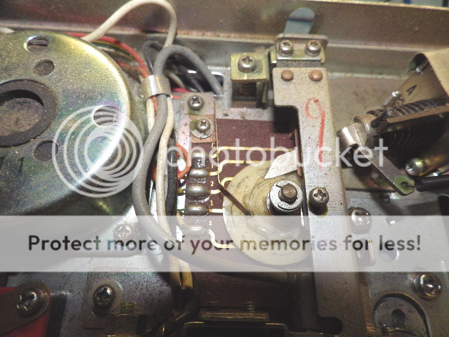

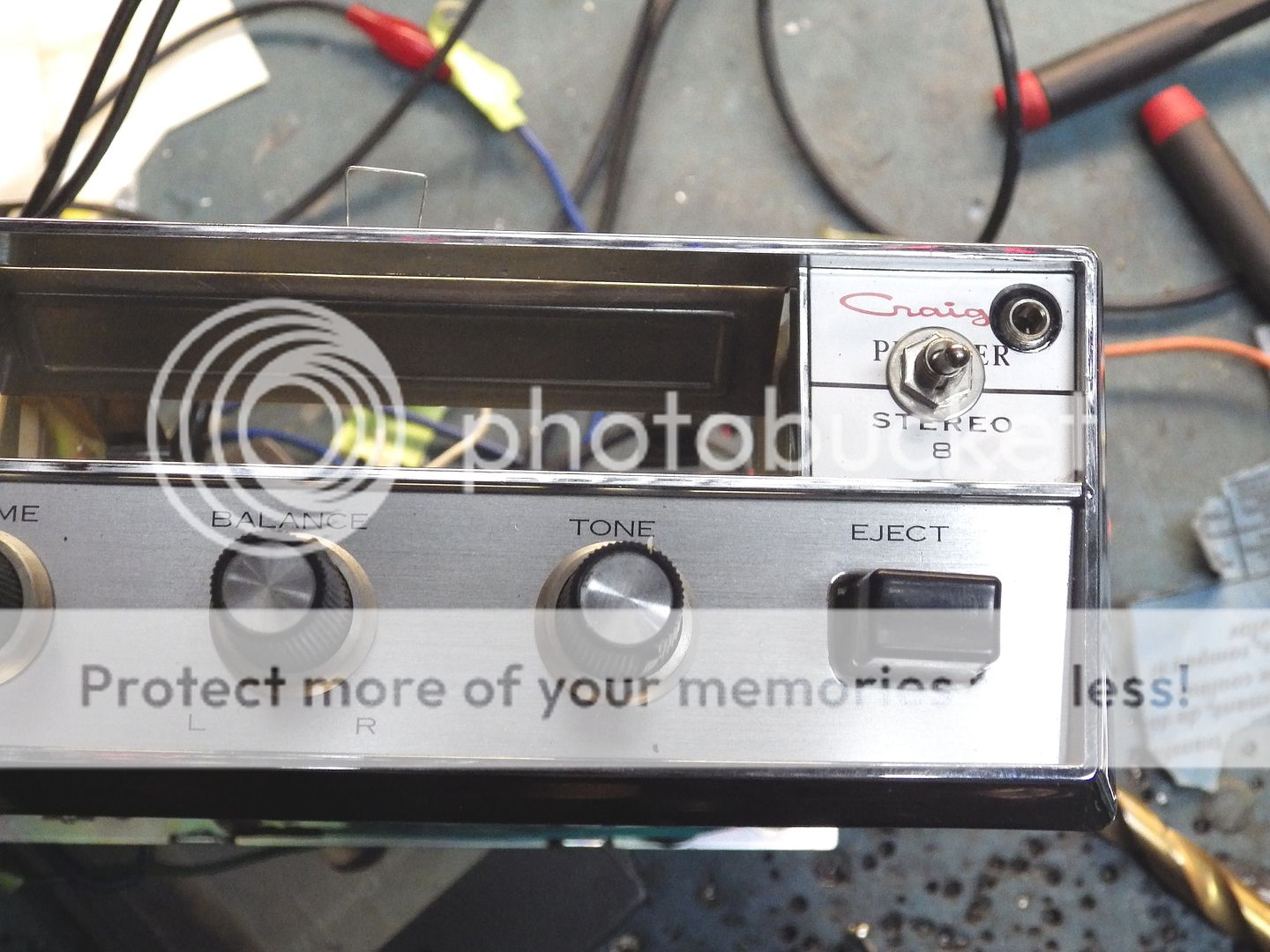

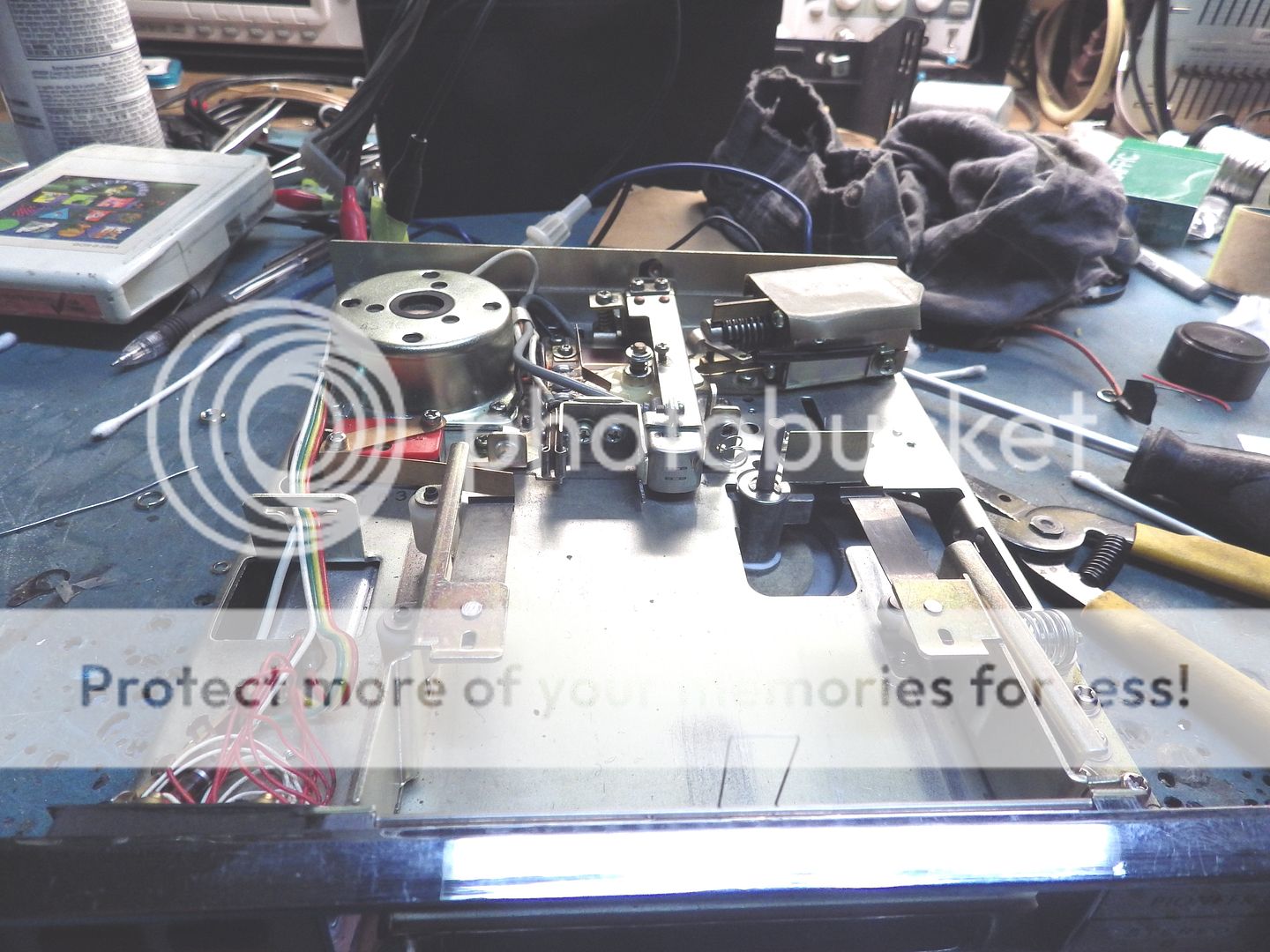

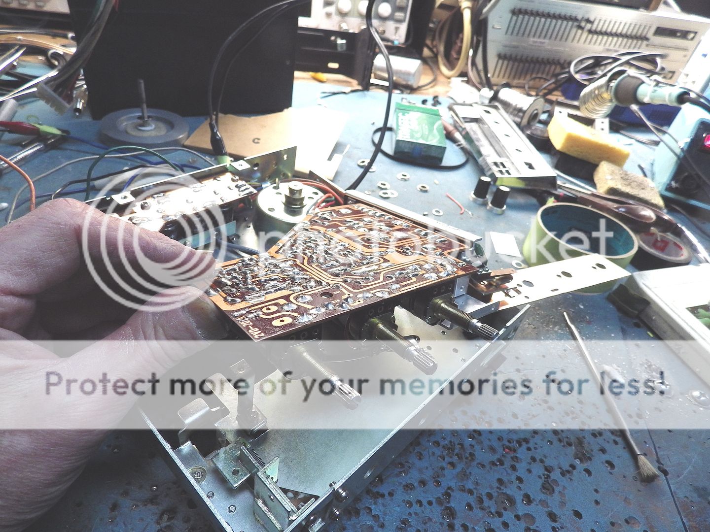

    My Craig Pioneer 3108A 8-Track player is finished being serviced. The guy I sent it to is sort of a mad scientist. I recommend spending a few minutes to review his website. He thinks very highly of himself. I get a kick out of it
    http://www.barrys8trackrepair.com/
    Before pics

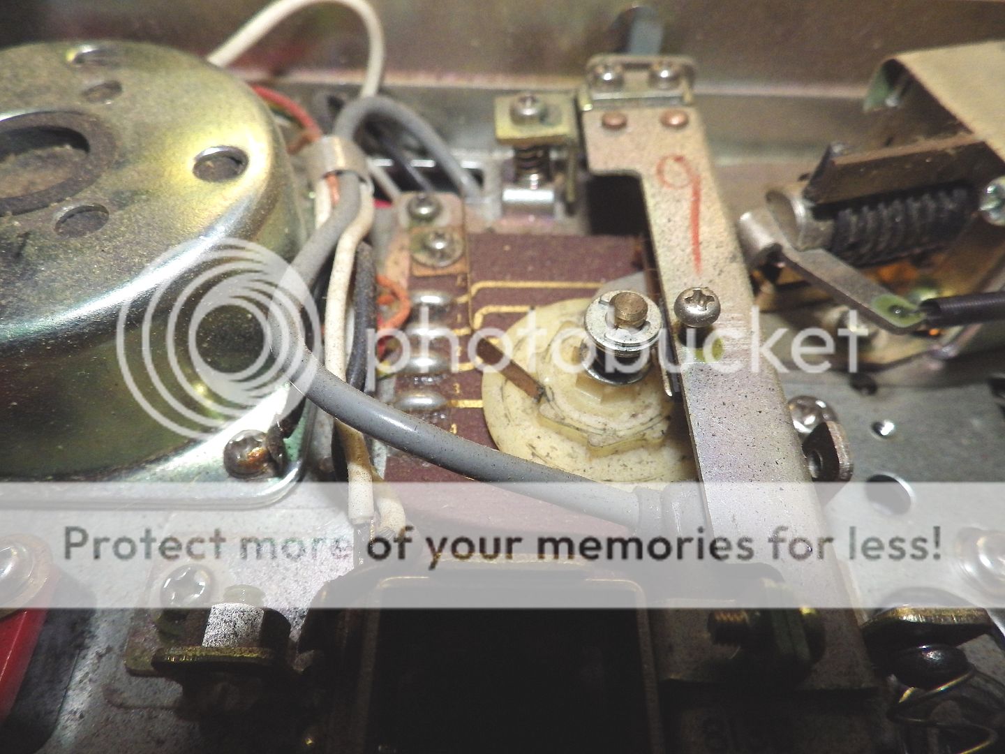

    The controls had a real staticy sound, here they are being cleaned

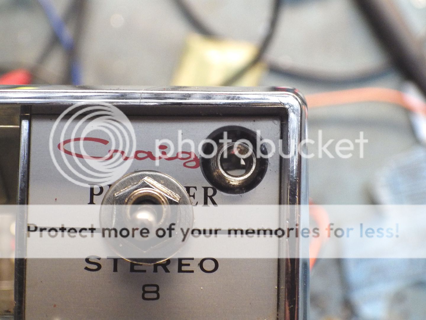

    Aux in jack added for me
    He also added a pair of USB ports for charging cell phones, my daughters nintendo DS, etc...
    And he always films a verification video to show his work. All in all, he had the radio 6 MONTHS and I ended up paying an expedited work fee so I could get my stuff back. His website clearly states "I dont care about your deadlines or car shows. I work at my own pace. Deal with it, or I will send your radio back unrepaired, with a refund minus shipping" LOL

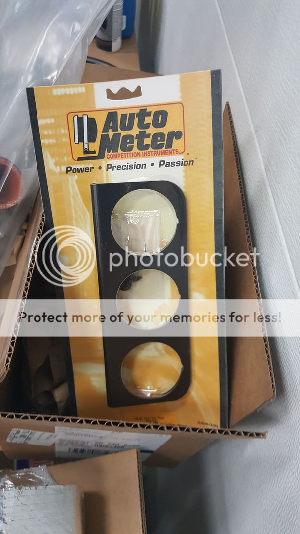

    New Autometer gauges, with electric senders

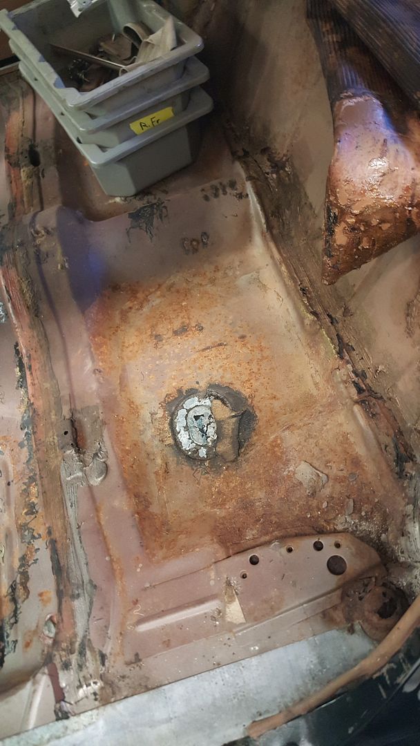

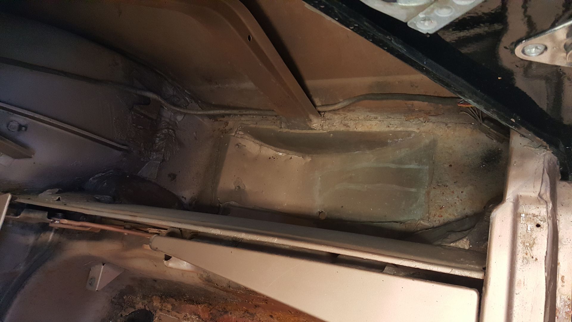

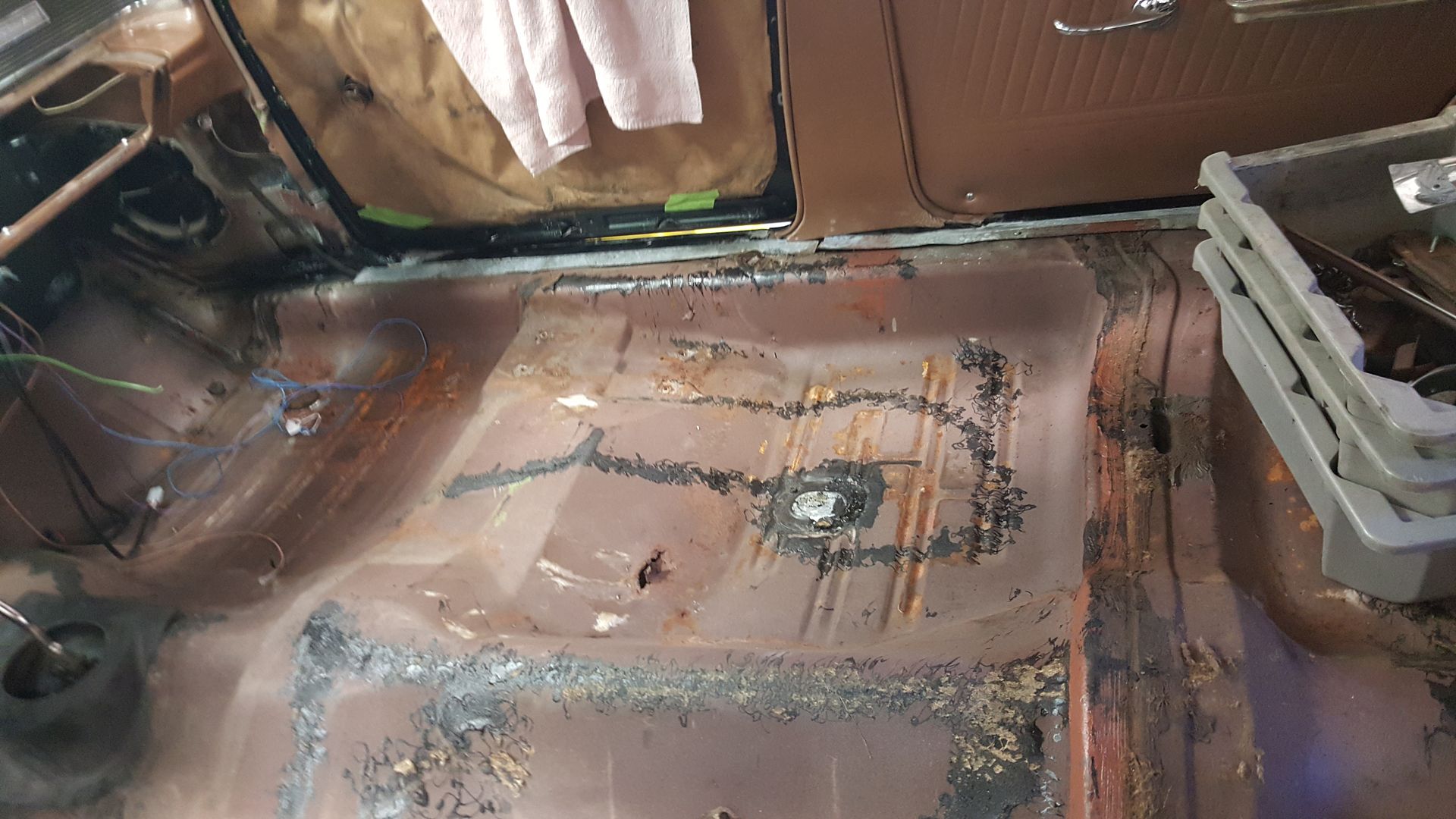

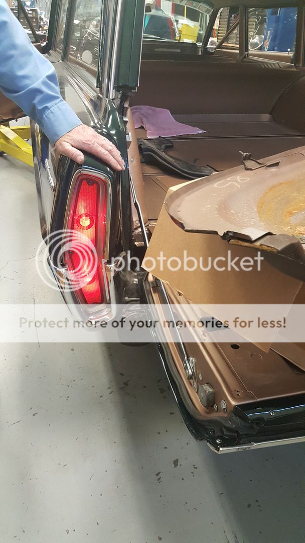

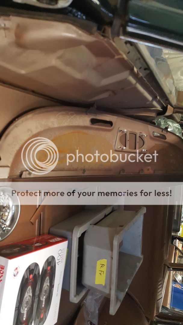

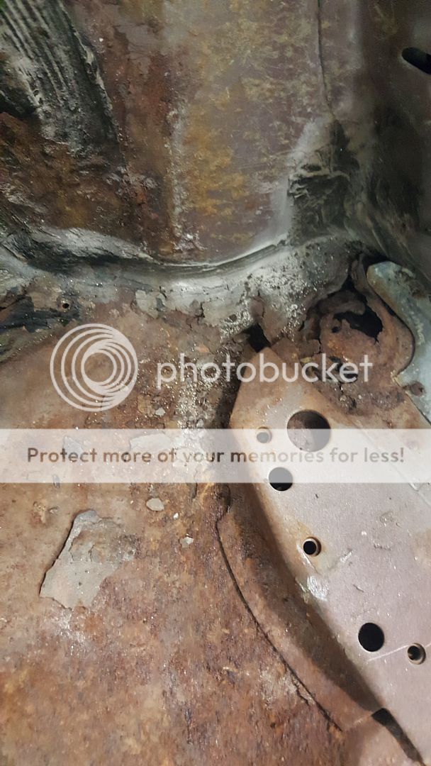

    Upholsterer pulled the rest of the interior out. I was surprised at what was found. Definitely need some cleaning, patches, and a bunch of POR 15
    Third seat area
    Spare tire well. This was replaced by the body shop
    Driver rear floor
    Driver rear wheel arch....definitely crusty
    Passenger front floor
    Crappy pic of my 80 pounds of Second Skin (dynamat knock off) and heat barrier for the trans tunnel

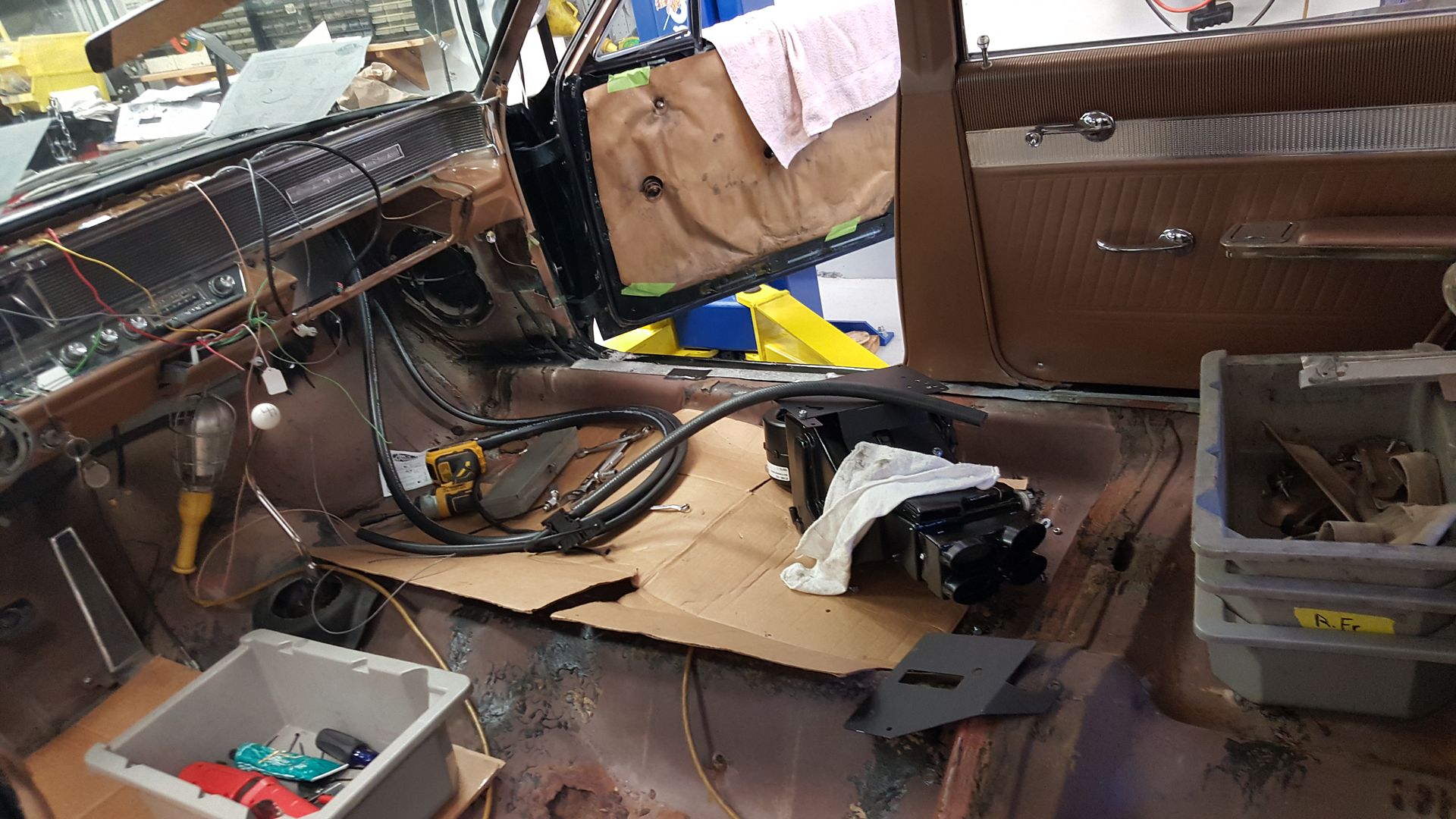

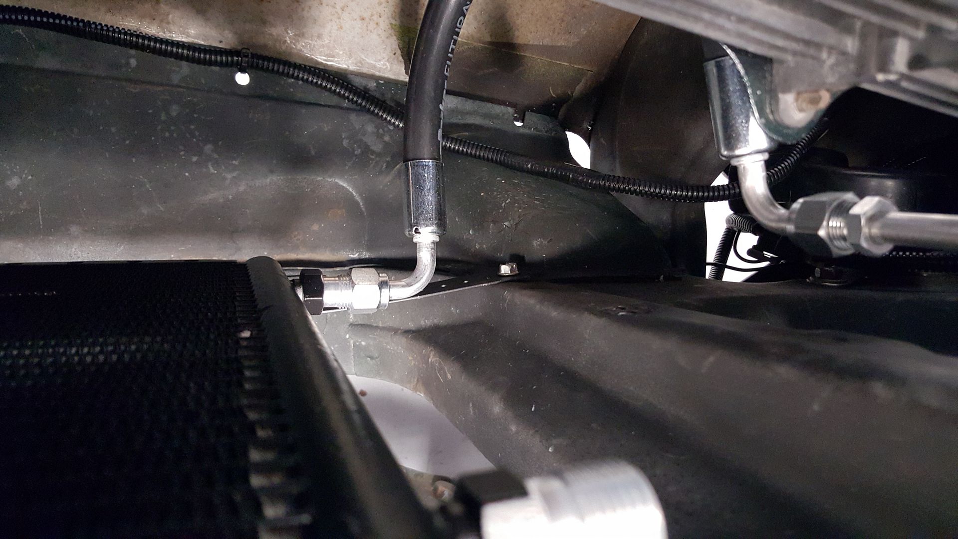

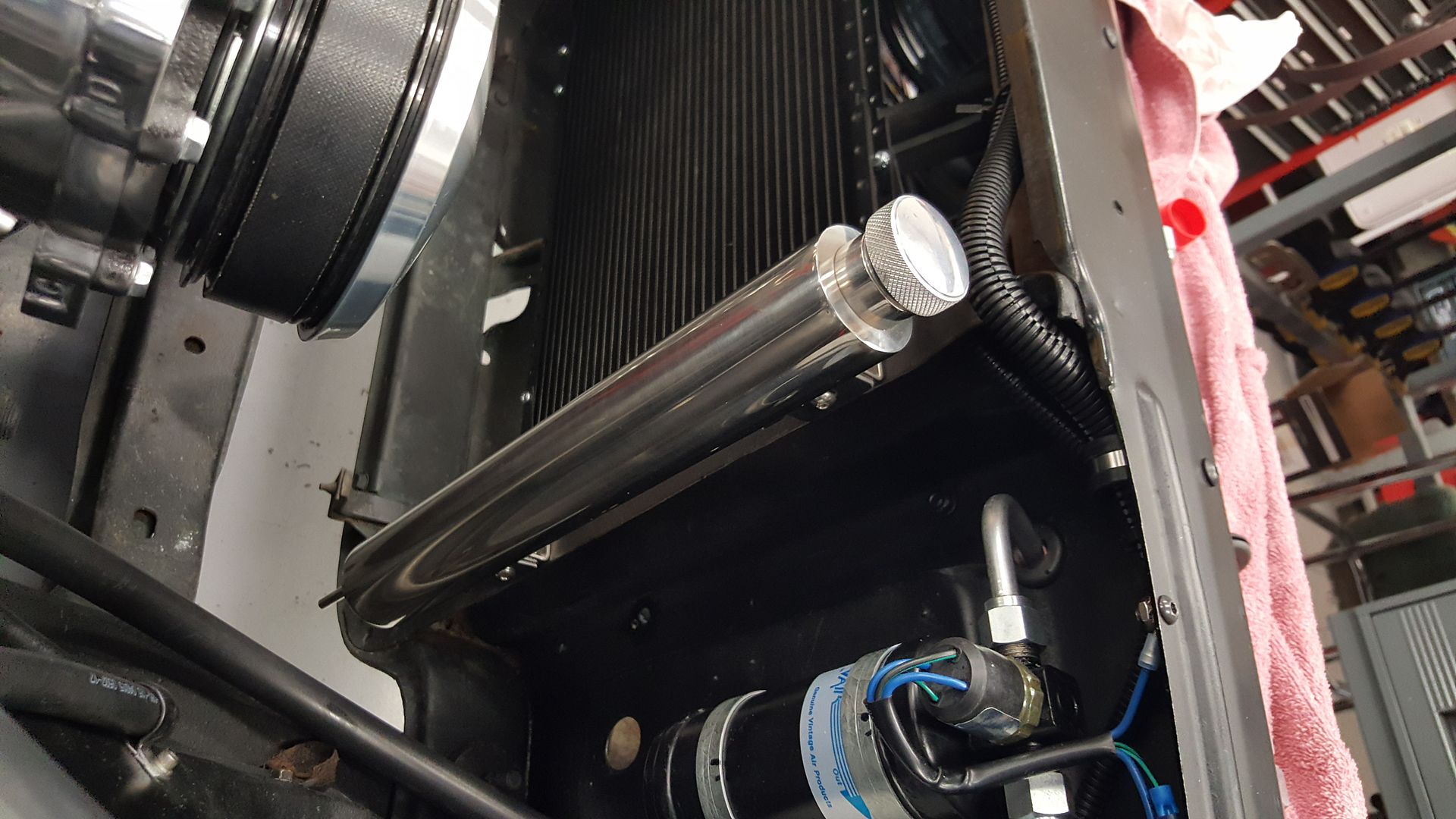

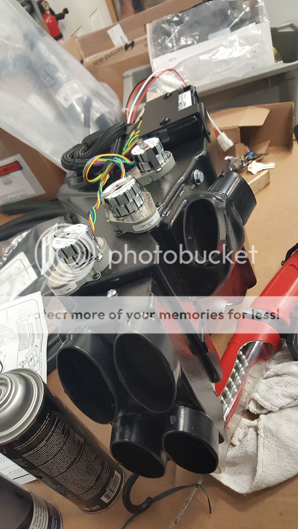

    AC is going in

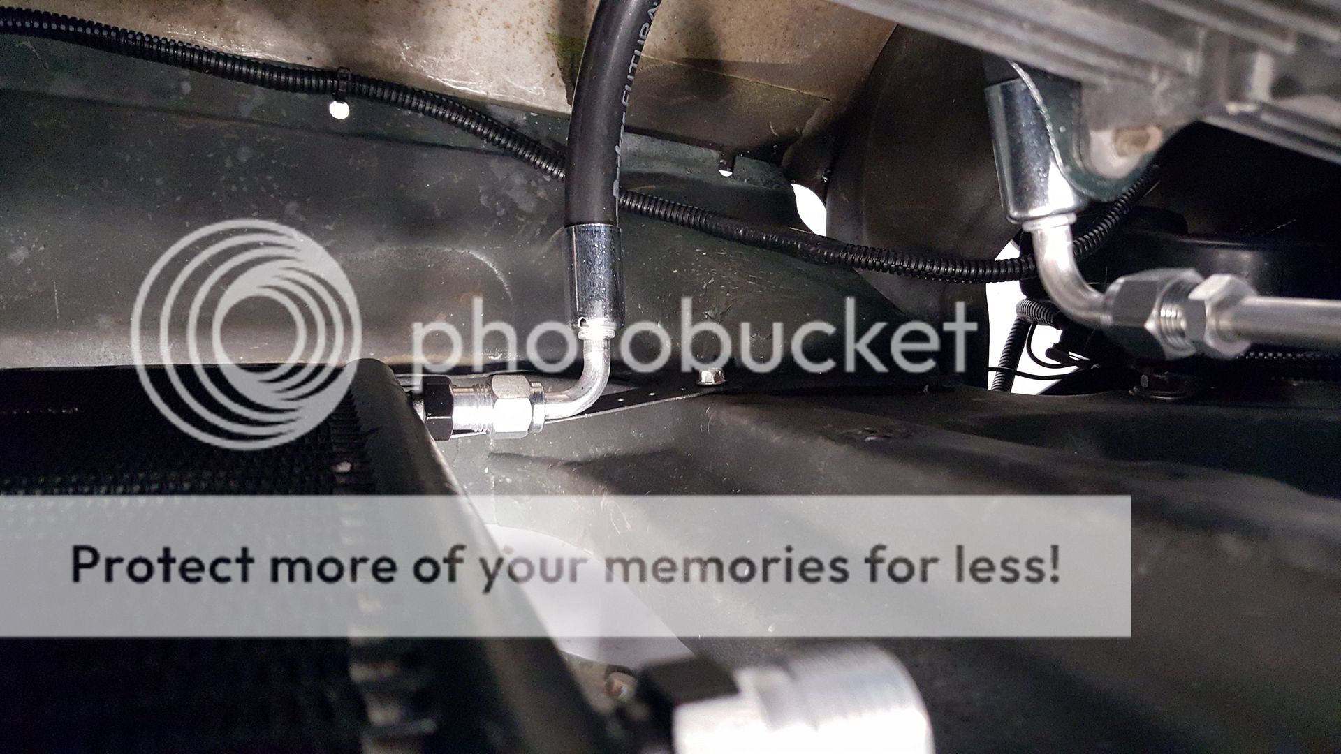

    His attention to detail is really very good. All hand bent and soon to be crimped
    You can see where the hoses will be run through the firewall and heater delete plate
    Coolant overflow tank

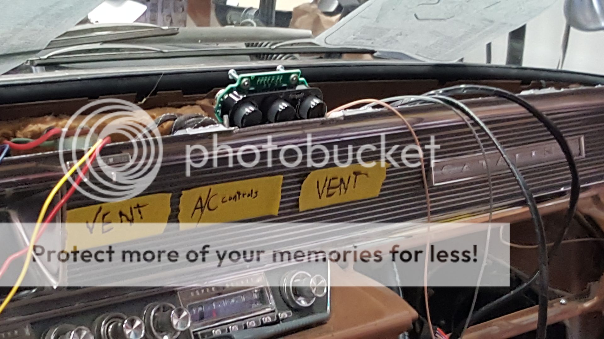

    We ran out of real estate under the dash for everything. To the left of the wheel are some switches. Under the keys is going to be the 8 track player. The gauge pod is next, then the center ac vents. Then the ashtray, and the ac box will be under the glove box. Lots of stuff!
    We had to compromise, and move the ac controls and some of the vents. I hate to cut the dash, but the more I think of it, I think it will look just fine, and work better.

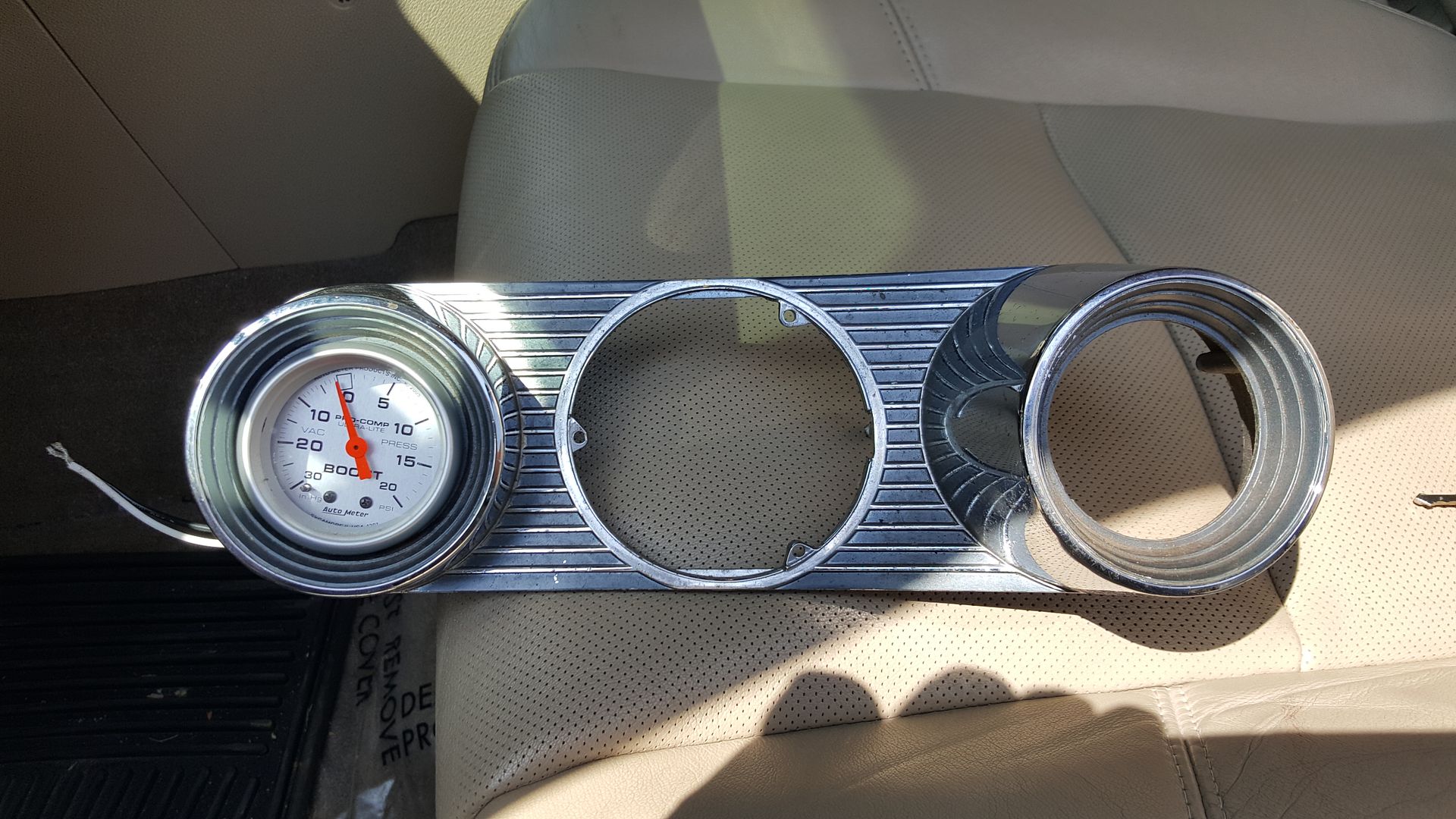

    So we have a solution! I don't need to really cut my dash up as I thought to make way for my AC vents and controls like this
    a buddy of mine told me that Pontiac made a gauge pod that goes on the dash to the right of the steering wheel
    He had one I could use for mock up purposes, and my gauges fit PERFECT!

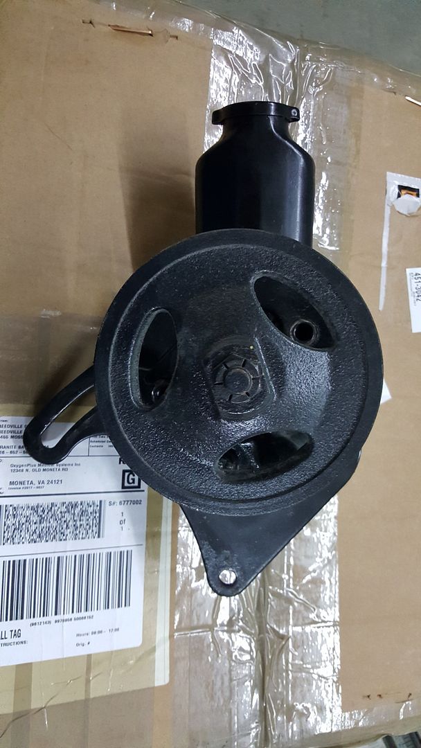

    Luckily enough, I actually found one of these on ebay for $150, all rechromed. I've dealt with the seller a few times. We've traded parts etc. Real nice guy with great quality stuff. This is the piece.

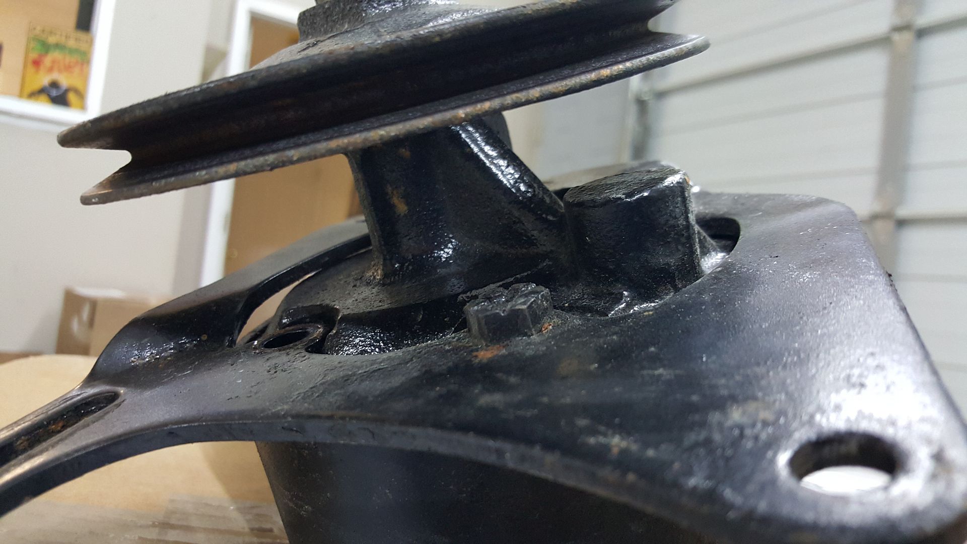

    So, the seller has been buying odd parts off me, like my factory alternator and some other stuff. I couldn't give this stuff away, but this guy wants it all. My wagon was built at the same time as a car he's building, and all my parts have the correct date codes that he needs, and has not been able to find.
    So, I ended up getting this gauge pod essentially for free, because he traded me for my factory power steering pump :)
