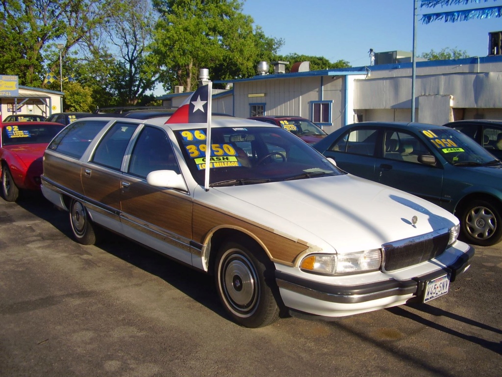

    As-Found in 2007

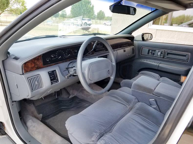

    And now 2019 (well late 2018 in this pic)
