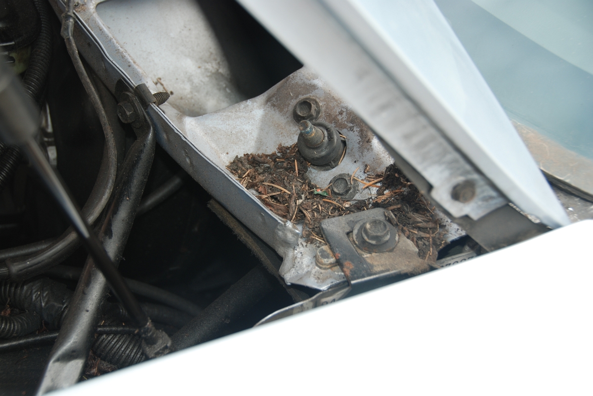

    I had noticed when I got my Roadmaster that the washer line feeding the drivers side spray nozzle had been damaged and the previous owner had inserted a plastic coupler into the line rather than replace the tubing from the delivery hose to the wiper nozzle. At some point over the chill of winter, that plastic coupling snapped and I had planned to replace it. Coincidentally, the factory nozzle on the passenger side had broken as well. Now I was left with no choice but to remove the cowl assembly and repair the delivery hose as well as the tubing in my driver’s side wiper arm.
    I dug through my factory service manual to see how to get at the washer delivery hose under the cowl and was disappointed to find that step one, was “Remove the cowl”. Removing the cowl was the very information that I was after. Since I was on my own to figure it out, I thought I might as well document it a little bit. I didn’t get as many pictures of the process as I should have, but it really is easy, it’s just a matter of knowing the order to pull things out and put them back in again.

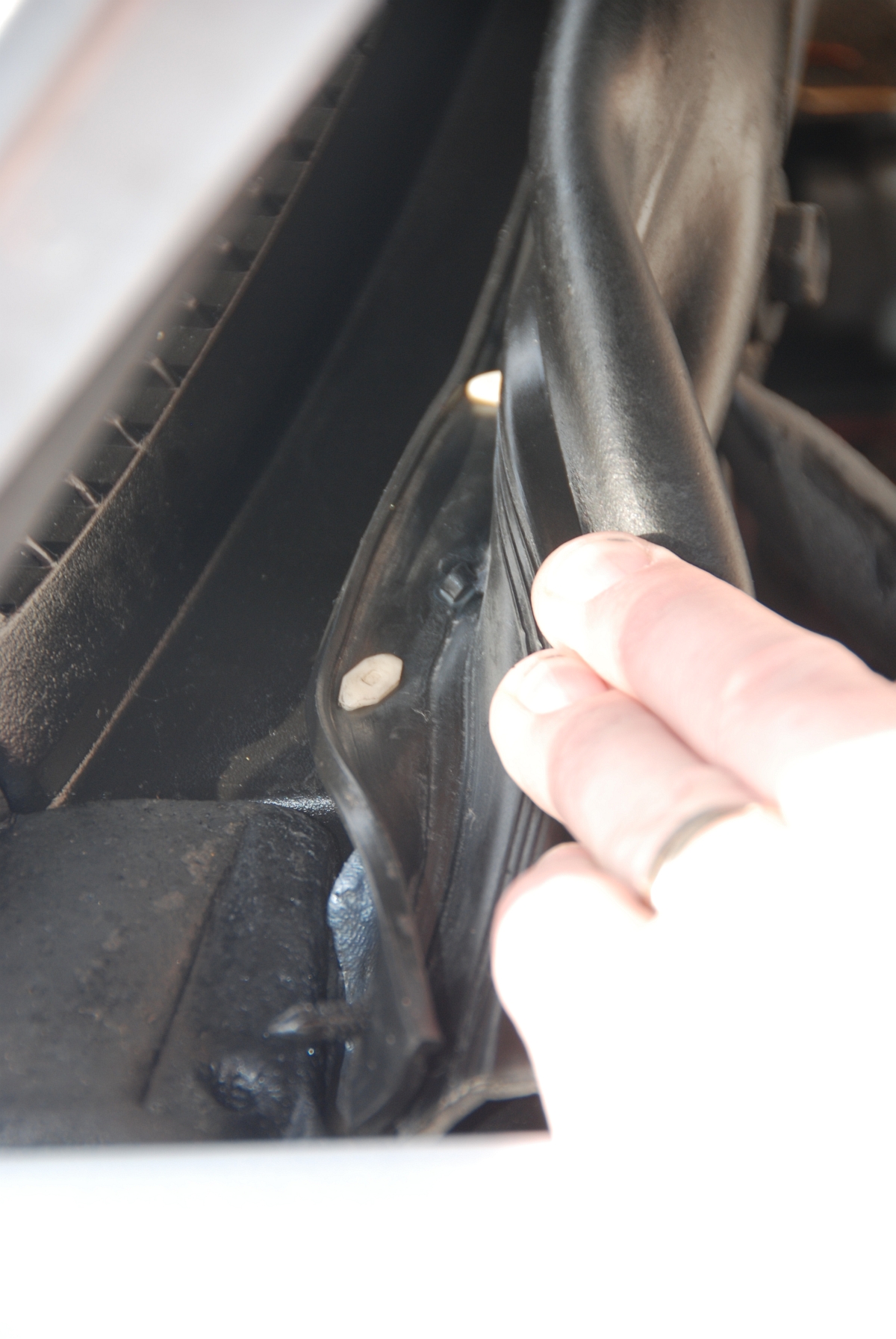

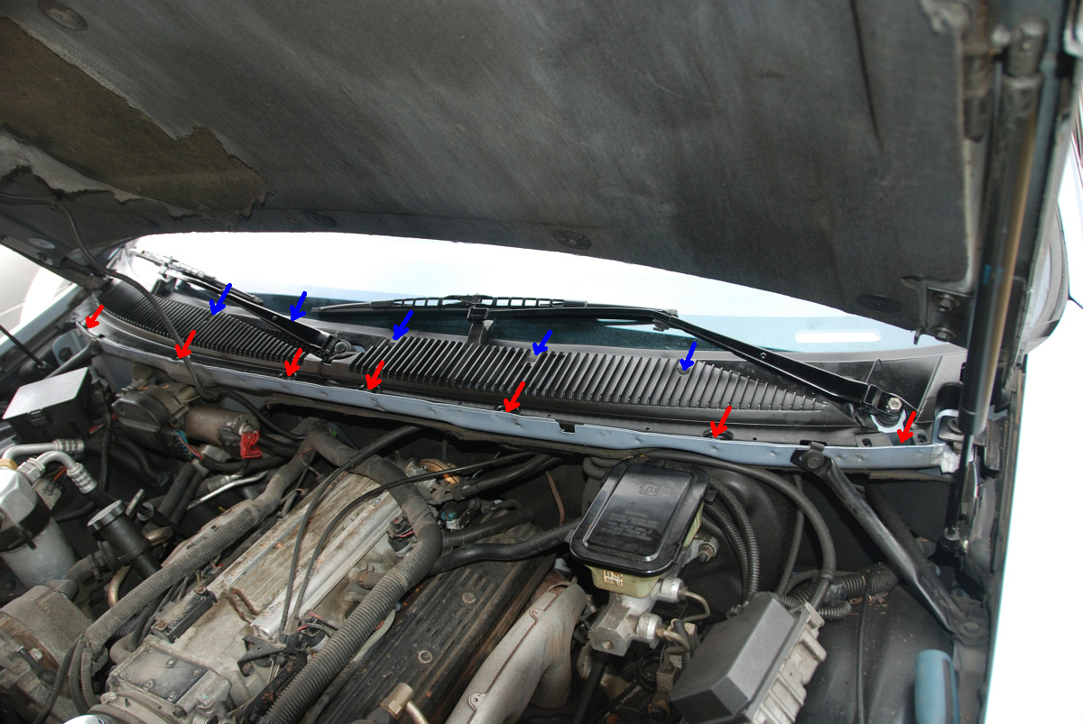

    The cowl assembly is attached to the car with a collection of screws and plastic pins. As most of the screws are concealed, it takes a minute or two to get at all of them. Before starting, I removed the wiper arms and set them aside.
    I pried up on the plastic screw cover to get at the recessed screws on each end.
    I then took off the engine compartment weatherstripping to get at the rest of the screws.
    In addition to the two screws concealed by square plastic covers on either end, all screws and trim plugs must be removed in order to lift off the cowl. The screws are marked here with red arrows and the trim plugs are marked with blue arrows. With all of the screws and plugs out, remove the drivers side of the cowl first.

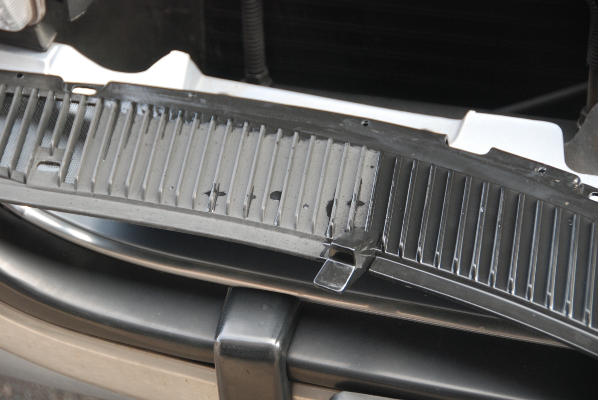

    Once the cowls are off they can be cleaned. In my case there was a mess of leaves and pine needles and whatnot under the cowl vents but on top of the vent screen. As the screen is adhered directly to the cowl it can’t easily be removed. I got all of mine cleared out just with a garden hose.
    The washer fluid delivery system connects to the larger fluid hose (shown by the arrow) that runs up to the cowl space from the washer pump. Disconnect the entire tubing assembly and replace it.
    It’s likely that the cowl tray will have some debris on it as well. This can be swept or hosed off as required. Leaving this mess in there is just asking for rust later on.
    I took the opportunity go over the cowl plastics with some cleaner and protectant while I had it all apart. In my case it was also necessary to repaint the wiper arms so I got those painted while I let the weather seal soak in protectant.

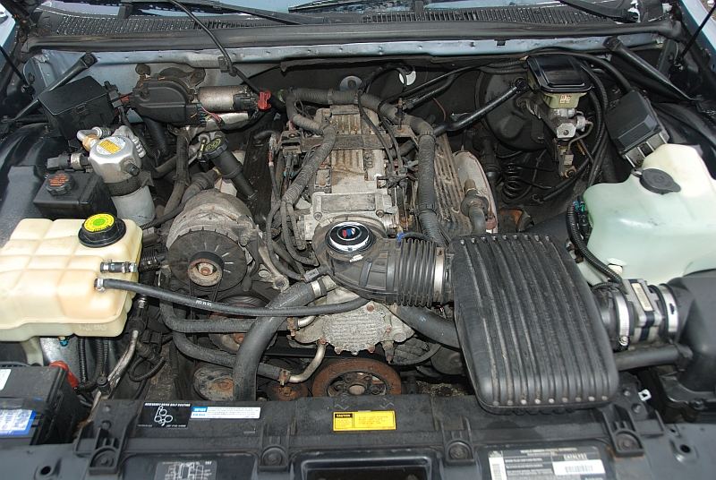

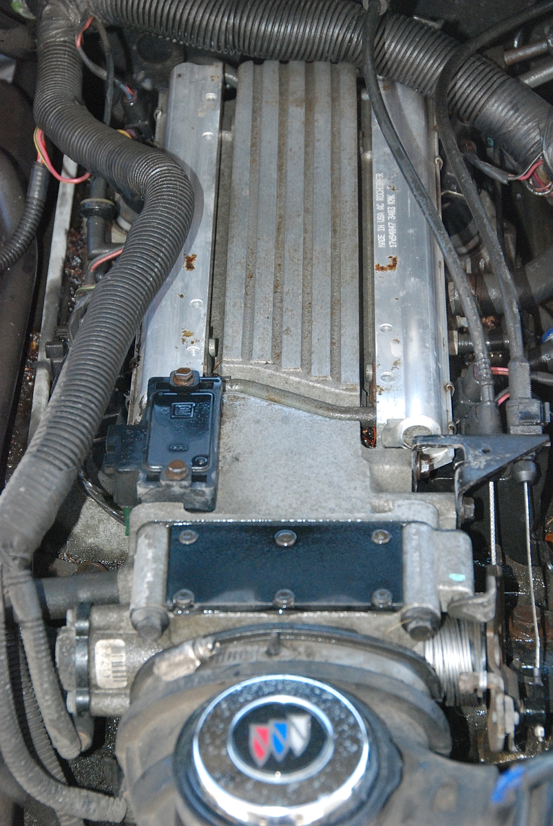

    Judging by the state of the intake, I think I got this post and the previous post in the wrong order. I did everything on the same day so it's sort of run together.
