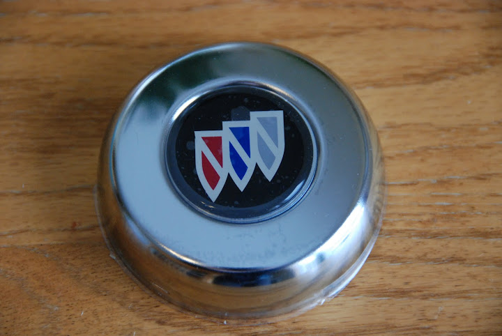

    I'm a big fan of stock vehicles but I'm thinking that I may deviate in some small ways with the Roadmaster. I've been looking at many of the mods, repairs, and improvements that Stewart has done over at http://www.roadmonster.org and reading threads on ImpalaSS sites and forums. While I don't want the car to be radically different from stock, I do want to make a few changes to make the car my own. I thought I would start with the intake system on the LT1 and I have been doing lots of reading in order to start the improvements next year. I figured removing the home plate from the LT1 was a good place to start and I would just "hockey puck" the intake to feel like I've done something until I decide what other changes I want for the car. While the cost benefit of the hockey puck makes sense, it just didn't feel right doing something like that to the car. I found this little goodie on eBay and just had to have one.
    I'm loving the slight change in the exhaust sound and I think, if such a thing is possible, that I enjoy driving the wagon even more now.
