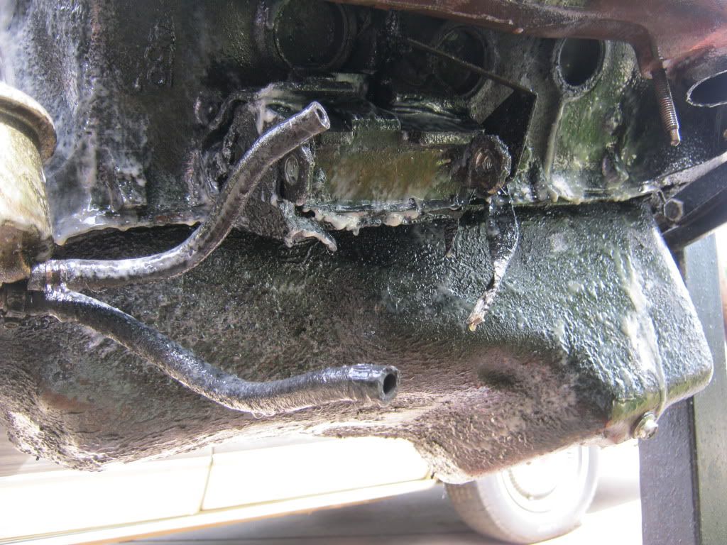

    Oh yeah, I forgot the post the entire reason I started digging through the old photobucket in the first place. I know there have been worse engines (I've dealt with some myself), but look at this greasy mess. This is The Clam's 455 right after I pulled it out.

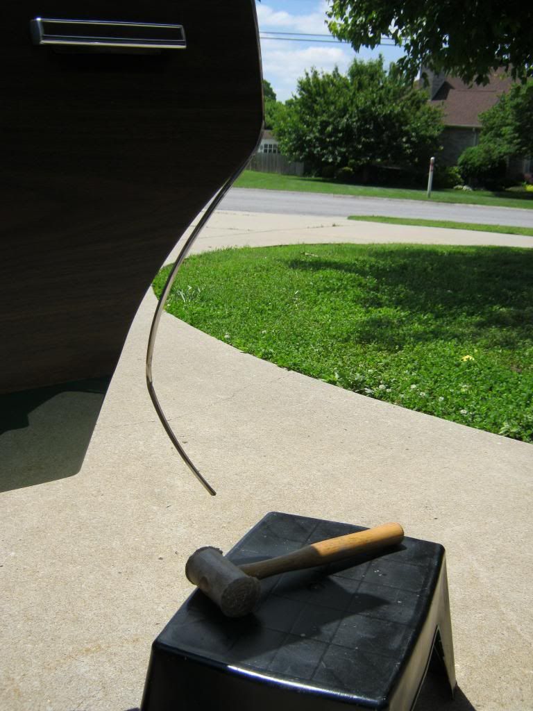

    The door edge guards were bent out of shape and I expected them to be a terrible pain putting them back on. To my surprise, with a little encouragement from a soft hammer, they went right on with much less fuss than I had anticipated.
