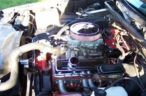

    Oops - just noticed the SBC in your Pu-ick - had two of those with solids, 45 + yrs. ago! Fuel injection cams! Settings of .012 + .018e and the other @ .030 across.
    Want a good cam for your SBC? Get a solid roller!!
