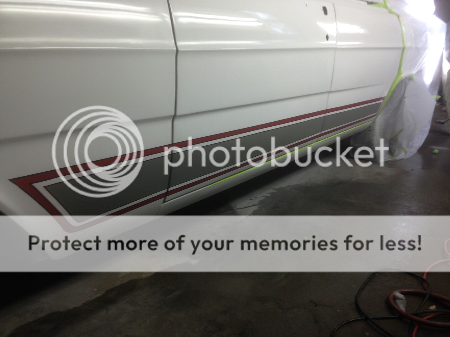

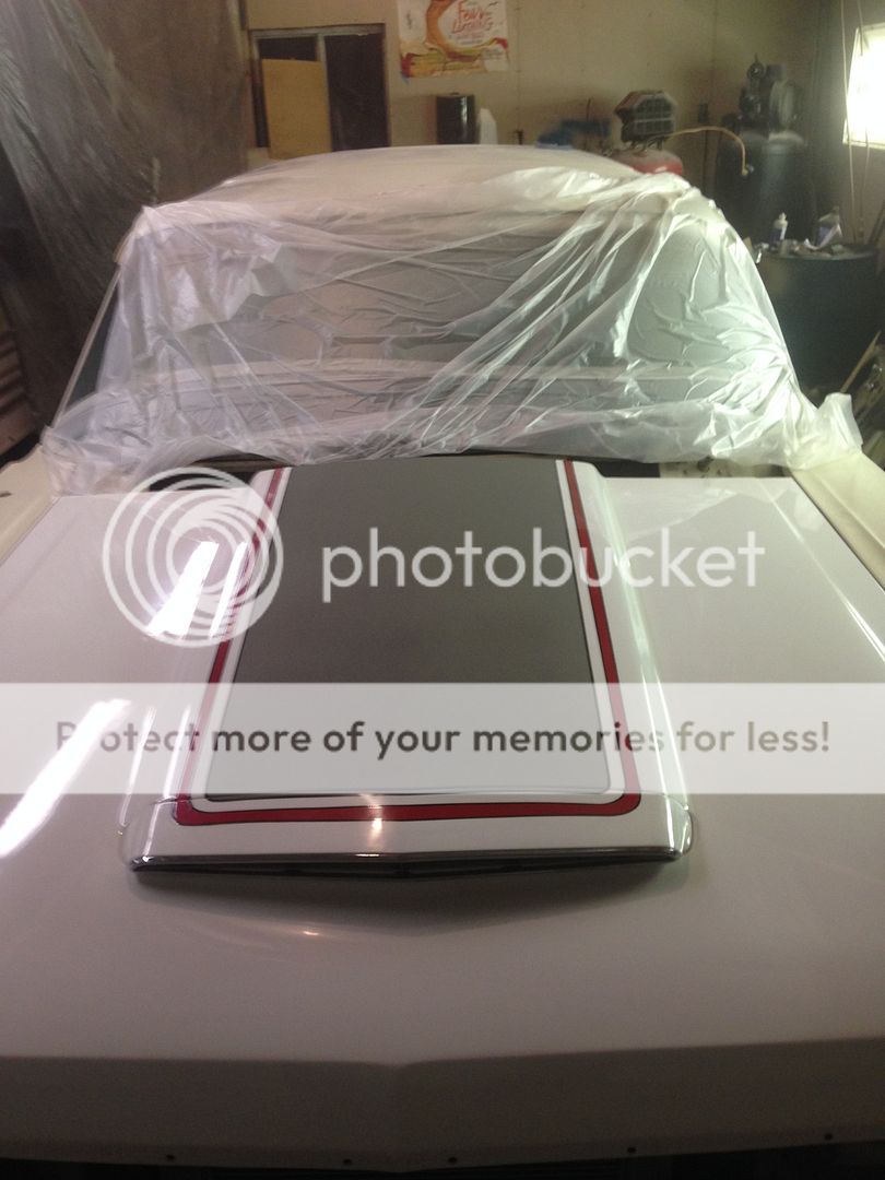

    It has been a while since an update on the wagon. I have made a lot of progress on the bodywork and paint. I got the hood painted with the graphics on the 64 Tbird hood scoop. I also finished the paint on the drivers side and I am currently wetsanding the LONG roof and it is a lot of area to sand and I will be very happy when it is done.
