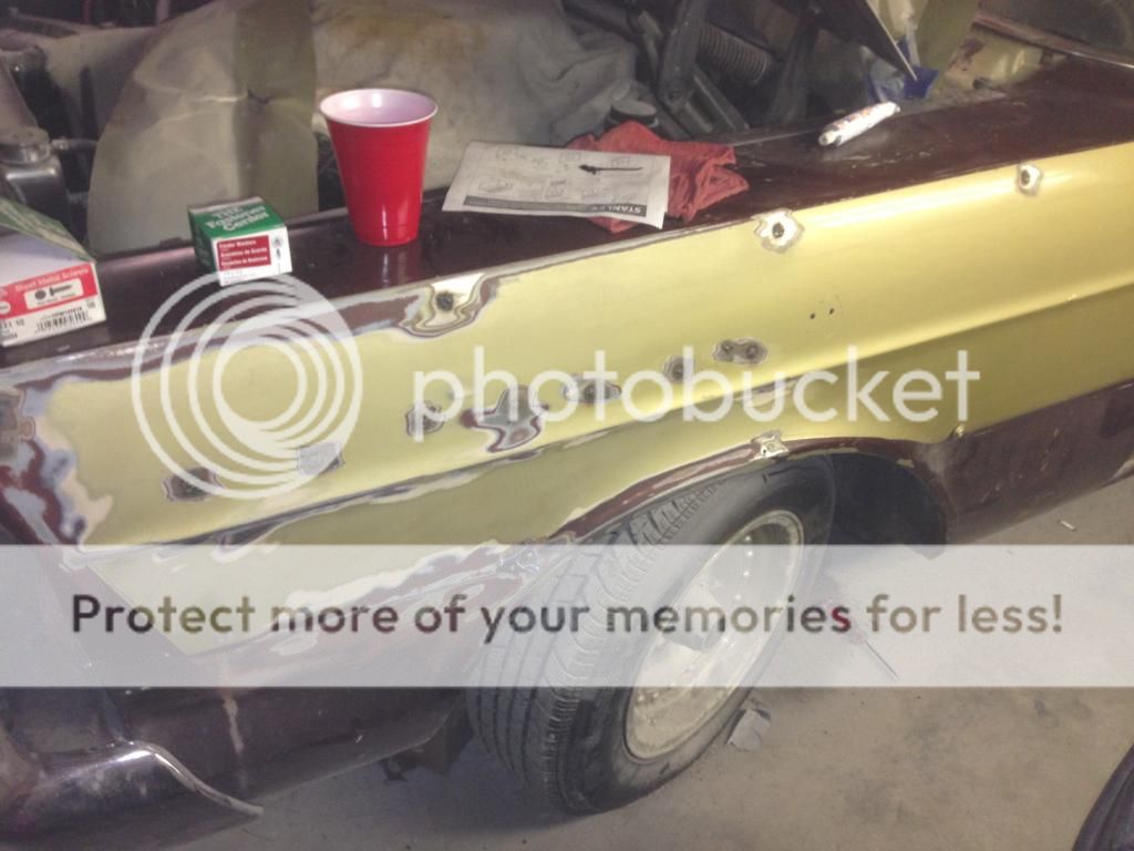

    More holes filled, about 60 holes filled and about 70 more to go :eek:

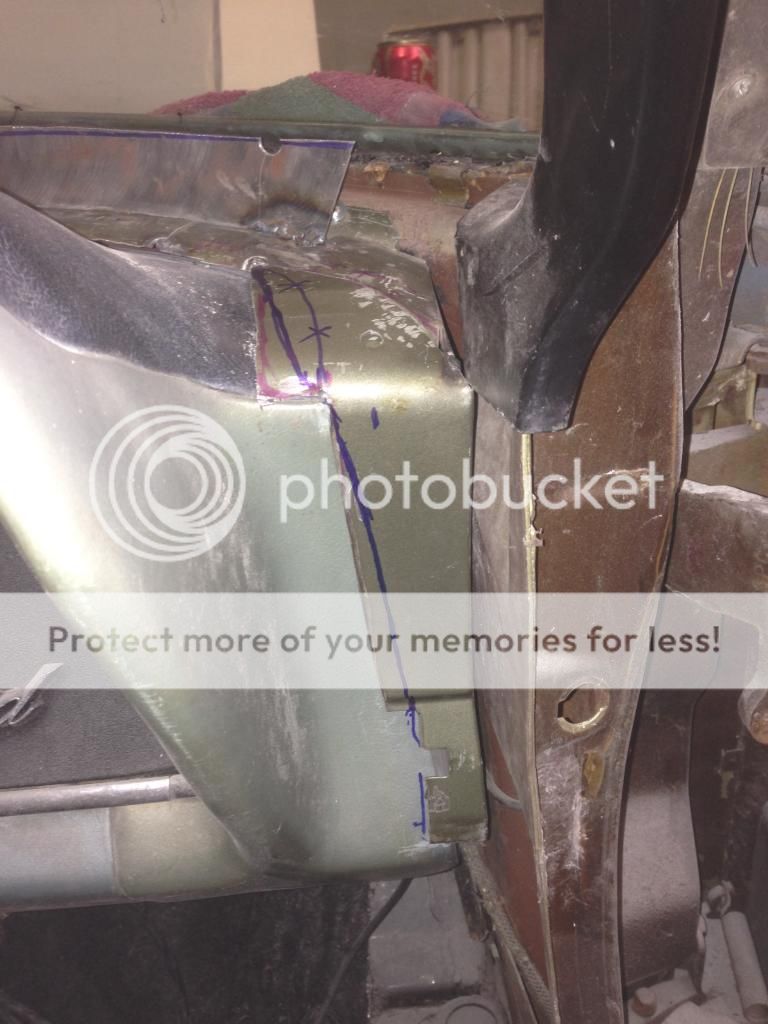

    Many more hours to go on the Thunderbird dash install. The Tbird dash was a little short so I had to cut the ends off the original dash and fabricate them onto the new dash.
    The Tbird dash sits lower and farther from the cowl than the original so I had to fabricate a spacer from the old dash and make a riser to fill the gap and mount the original dash ot cowl trim.

    I thought I would give some updates on my build. I have made a fair amount of progress but never posted anything. I filled in the last of the 130 trim holes. Here is the long roof where I decided I didn't want to keep the roof rack, for one thing it was missing one of the bars for the roof and I am also going for a clean shaved look for this car and make it look a little more sleek.

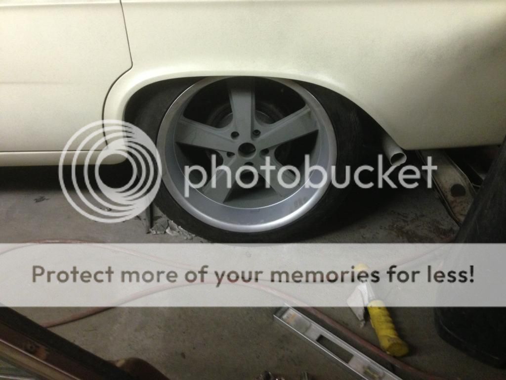

    I decided on a set of American Racing Nova 20" wheels with the fattest rubber I can squeeze in the fender well.

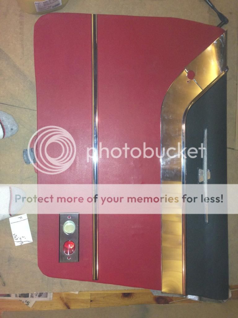

    I finished one of the front door panels using metal trim from the 64 Tbird donor interior.

    Looking great. Love the way the hood turned out. Love those Novas. Back when they were made by a company called KMC, I wanted a set for my Magnum. What size tire? 275-40 would be my guess.

    Good eye, that is correct. I think I can go a little wider if I want to.

    I ran 275-40 on my Magnum, still run them on my wife's Chrysler 300C. I also ran 295-40 and 315-35 on the rear. Fairly easy to find either size, and not too expensive.

    I actually put a set of 20" wheels and tires off my Chrysler 300 SRT8 that I sold a few years ago on my 62 Ford sedan delivery. I was surprised to find that they have the same lug pattern.

    I fit a 295/35/22 on my 64 with room to spare... I think a 285 will fit on the 67 easily depending on how low I take the Squire..

    I picked up a nice used set of 2, 315/30/20 That I am almost sure will fit on my 62 sedan delivery with a little thicker spacer and a slight trim on the fender lip. I LOVE the look of really wide tires from the rear of the car, it just makes them look badass.
