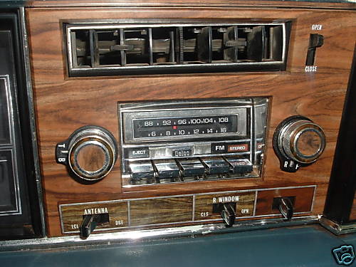

    looks like the same switch as mine
    my radio facia pops off (remove radio knobs, pull gently at tuning and volume holes, working it side to side and out. then the switch comes out the front (will be hard to see from the bottom with the radio in the way)
    hope yours is as easy as mine was

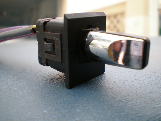

    Removing the switches in a '73 is a piece of cake. The manual says just grab them with your fingers and pull gently, and that's exaclty what you do. Five seconds and they're out. You can pull them forward as far as the wiring attached to the back will allow, and that's easily enough wire to pull the connector off the back.
    I see that by the year of your car, the switches were moved to under the radio, and they're mounted behind the dash with only the moveable part of the switch sticking through the dash.
    The one downside with my arrangement is that the radio gets in the way of seeing up to the switch from under the dash. I'm hoping against hope that I can see where the wiring goes without having to remove the radio. Removing the lower part of the dash (where the ashtrays are) is easy. If I pull on and wiggle the wiring while looking up under there, I can hopefully see where it goes. As I've said, my fear is that it just disappears into a wiring harness, and I won't be able to see where it comes out the other end. If this turns out to be true, I'll say the hell with it and just run a new, separate wire from one of the unused terminals on the accessory block to the switch. Having the lower dash apart will make this relatively easy.
