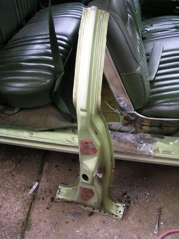

    Jaunty, I bet that front seat was a bear to get out of your wagon.
    The only way I could get mine out was to remove the center pillar! :rofl2:
    David ;)

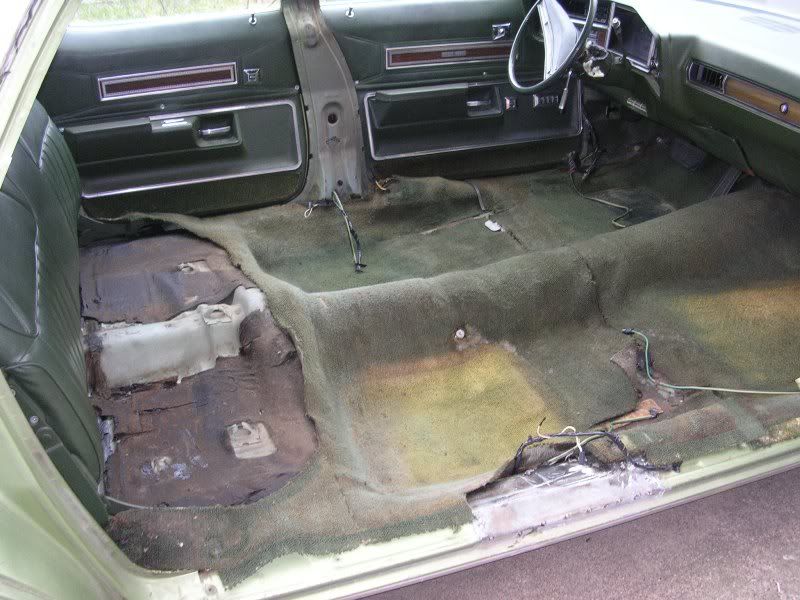

    Actually, it was no trouble at all. I racked the seat fully forward and removed the four rear bolts (two each side), then moved the seat all the way back to get at the four front bolts. Then, with my wife helping me, we lifted the seat and maneuvered it out the passenger side door, tilting it where necessary to get it through. Avoids the steering wheel going this way.
    I wonder if the seat couldn't be gotten out through the rear tailgate if it wouldn't fit through any of the doors.
    Here's a couple of photos with everything out. Looks like I need to spray a little rust stabilizer in the front footwell area. Suggestions?

    Jaunty, I would check out the POR-15 site, or go to your local auto color store, and get some Marine Clean, Metal Ready and some POR-15 paint.
    Clean the floorboards with the Marine Clean, then spray the Metal Ready on the rust and let it sit for a bit, and then wash it off with water. Dry the area, and then put a light coat of the POR-15 on the rust, and let it sit overnight. Then coat it again in the morning.
    Check the underside to see if it is rusty, and coat that the same way.
    If you have never used POR-15 before, know that you have to be very careful to keep it off your skin, because once it dries, it is permanent! Only goes away when your skin cells exfoliate. :49:
