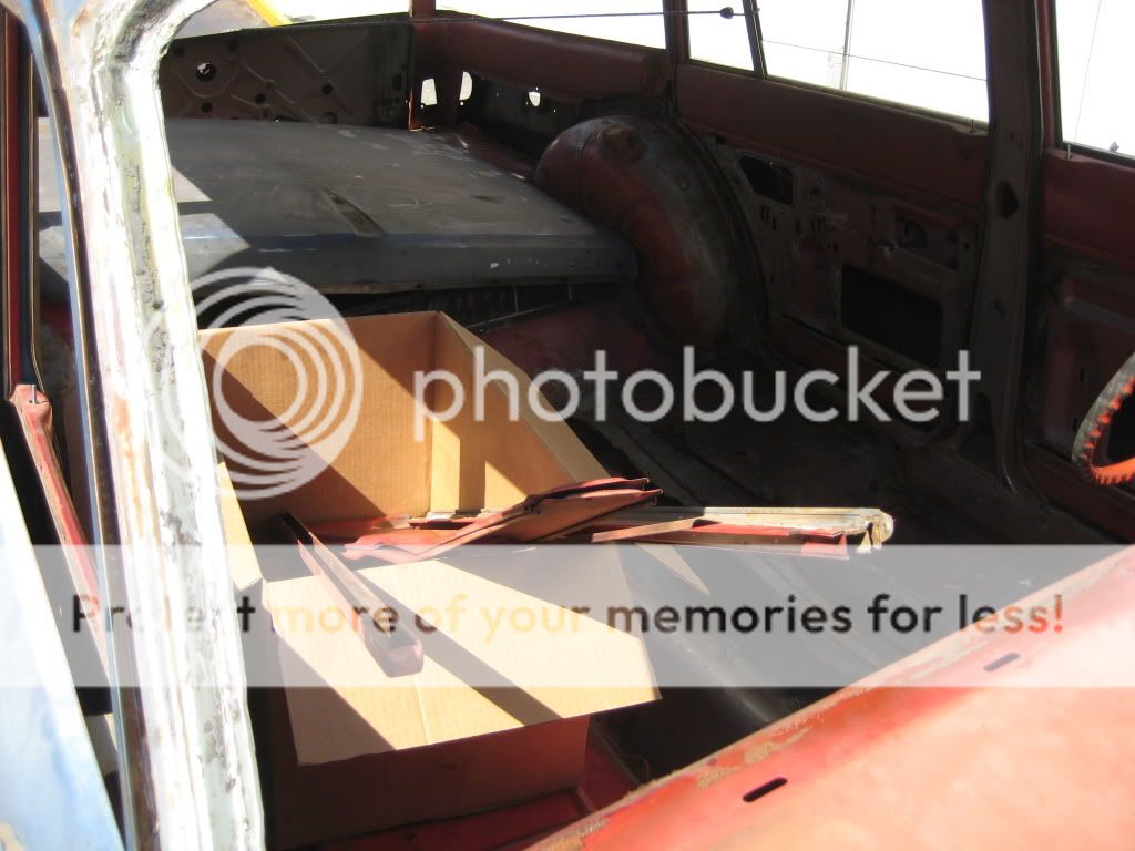

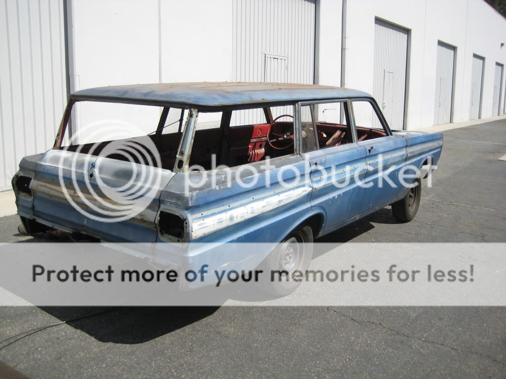

Off to the body shop! Hooray! I got it ready and sent to the body shop today, when I do all the stripping of parts it saves a gang of money, so here she is in all her glory, gettin up on the tow truck, boxes of interior panels to be painted red as well as the hood tucked in the rear.
she looks real good naked! Now the excitement begins for you and when she puts her new clothes on she is going to be a new lady....one fine one for sure!
Man Blacksnake, you have not wasted any time on this baby! Can't believe how far you've come already. Excellent work, my friend. Can't wait to see it on the return trip.

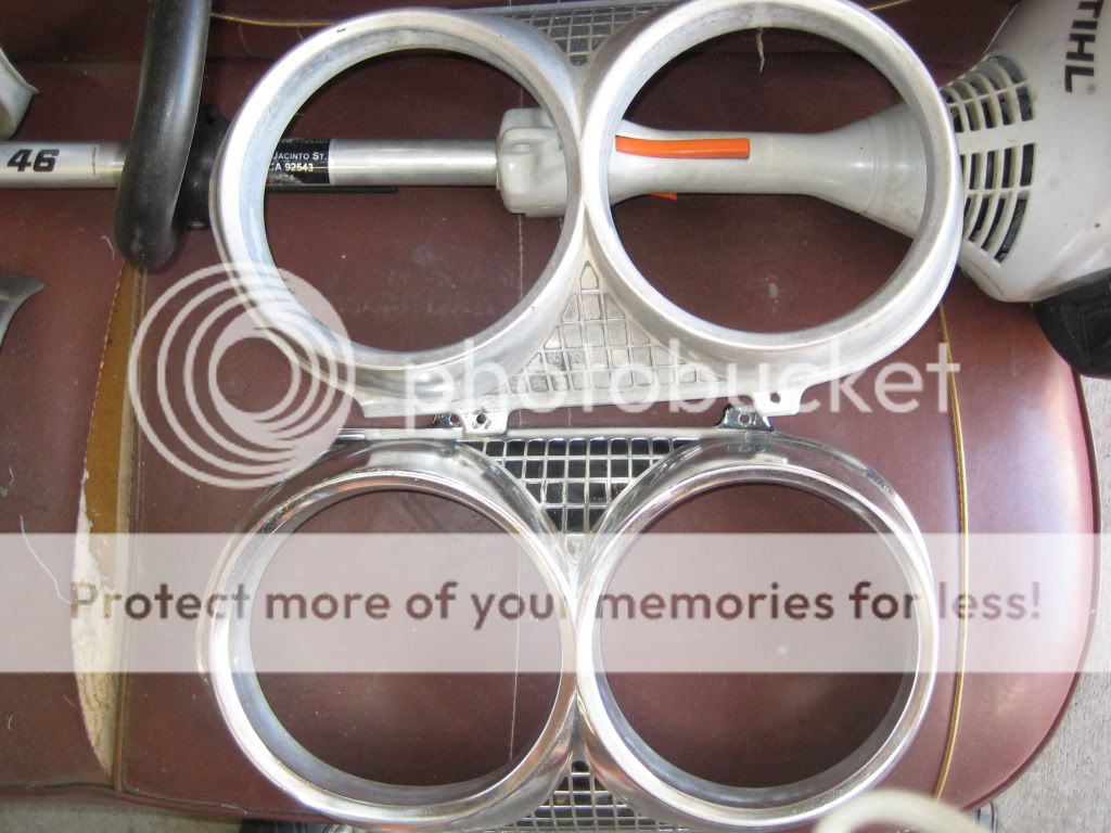

Quick update Stormin thanks for the info, I have the intake sytem in mind, I am more concerned about having high beams amd low beams if I Eliminate the inner headlights. Update: I was sick at home today with this crappy stomach flu, not enough to puke but sure not goin to work, killer body aches too, it is actually the second day (*&)$)(*$&#($*&!!!! Today I couldnt sit in the house all day so I went outside and di some polishing as I could stand it, I took a bunch of breaks...Wow do I have a long way to go. Here are some pictures of the pieces I did today, these are the pieces I did only one of each so the wife would appreciate them.............didint work she doesnt care LOL I actually have four headlight surrounds here are the two i will probably keep, one polished one not yet Here are the large trim pieces on the posts at the back of the wagon oneach side of the glass, one polished one not. This little beauty took me almost an hour to do, and I have at least 20 more pieces like this but they are all bigger, good thing the paint guy said 3 months LOL Last but not least these are the headlight surrounds, I will have to repaint the black, I am not sure how I will do that i guess mask off and get out the exacto knife, I have yet to think about that. Oak
The black checkered pattern is tricky, but you could use a wax crayon from one of your kids and 'mask' off the chrome lines, then spray your flat black. How'd you polish it?
Ref the polishing, I bought a bench grinder and converted it to a buffer. I also bought 2 polishing wheels and some polishing compound bars, that and some good ol fashion time, like I said that one piece got me for over an hour. But I do have 3 mos or so.......... Stay tuned........... Oak
