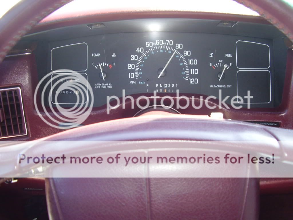

    My 82 Custom Cruiser has gauges, but they are very small and mostly hidden by the steering wheel. My speedo is 3 feet long and 2 to 7 mph off I found out on my trip to TN. (no ticket just the GPS telling me) (y)
    Does anybody know some option for my year/model? I was just going to build a custom dash at some point but if there is a ready to install option I might go with that.

    I looked all over for a set of those small gauges for my '89 Custom Cruiser, but the late 80's wagons used lighter wood dash trim, and I never found a car with matching dash trim.
    I like the little gauges, better them than nothing. My car only had the speedo and fuel gauges.

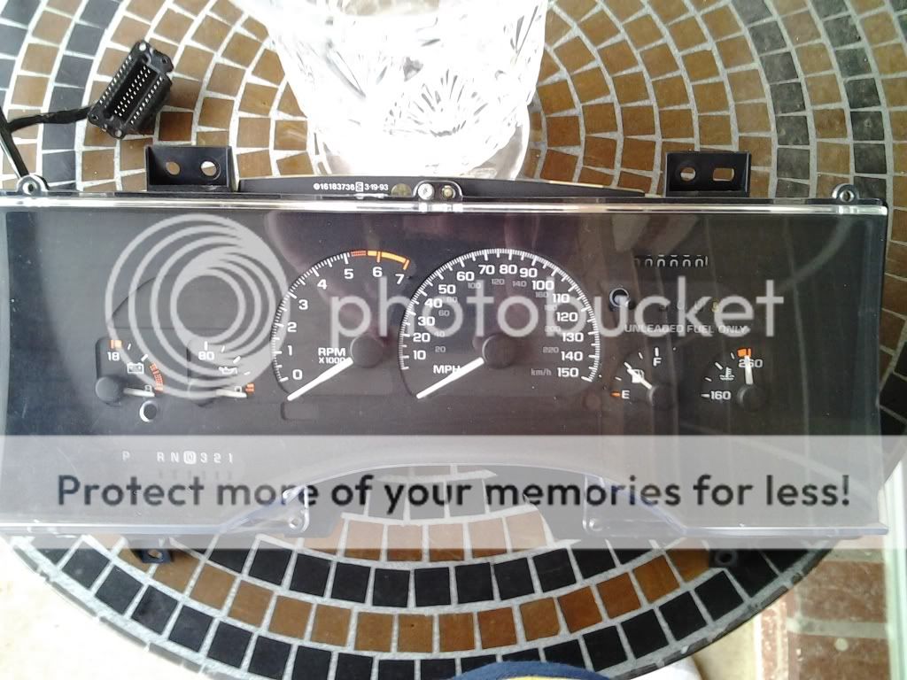

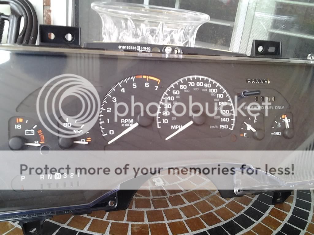

    Went home at lunch and found my early Christmas gift on the front porch.
    Gary did a great job adding the PRNDL and I like the white gauge needles as well.
    I may try to use my old cluster's clear lens as this one has some hazing. It's not bad but I think the one in my car now is better. Also going to plug the unused hole that was for the Roady trip odometer. I still have a few Citation X-11 gauge clusters and when GM added the tach to those they pugged the lens hole for the clock adjustment rod with a little black button. Going to use one of those on the Roady lens.
    I'm a little torn about changing all the bulbs. The PRNDL is going to light up the stock Roady blue/green color. I'm guessing the rest of the cluster would light up white. I know I could install blue bulbs in the cluster and that is supposed to "green it up", but have not decided if I want to have two different colors of green or just leave the main gauges white. Guess I'll pick up a set of blue bulbs and once it's all plugged in and dark make that decision.
    The odometer is set to zero. Nothing like a fresh start!
    Will update the thread when I get started on the install. I have to work this week so will be next week sometime before I tear into this. Can't wait! These gauges are SO SHARP!
    Such fun,
    -Mike

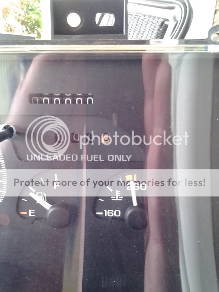

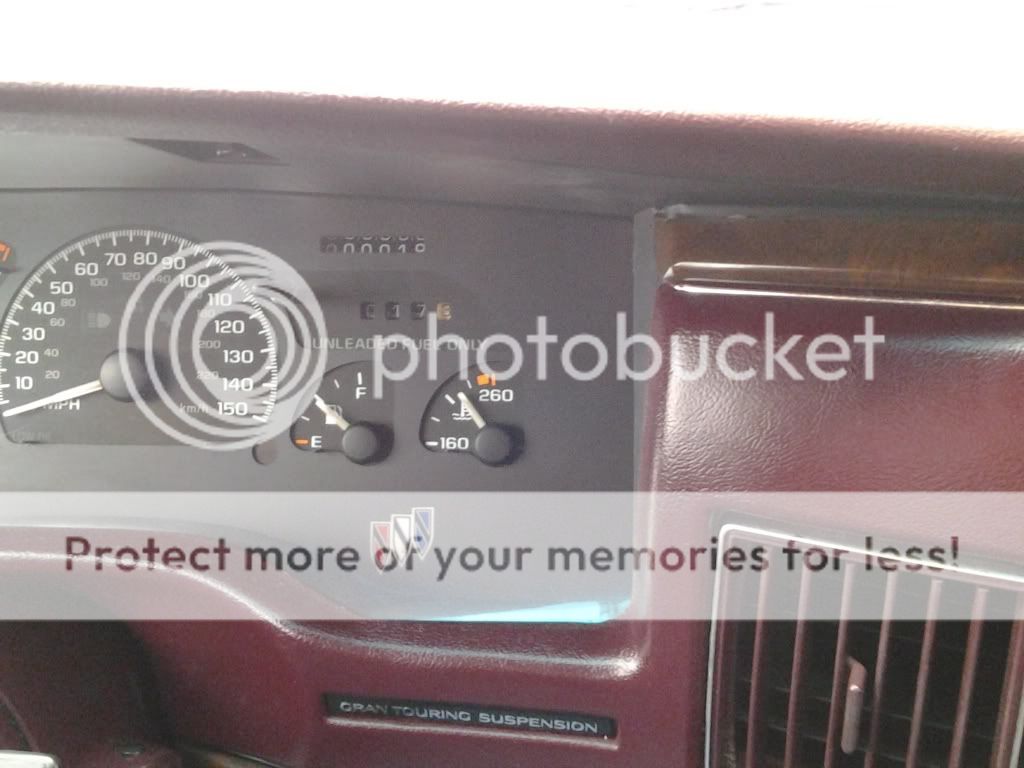

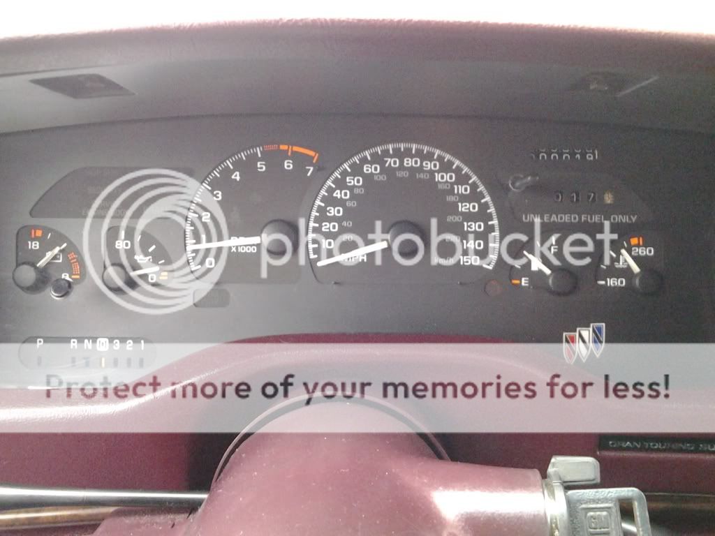

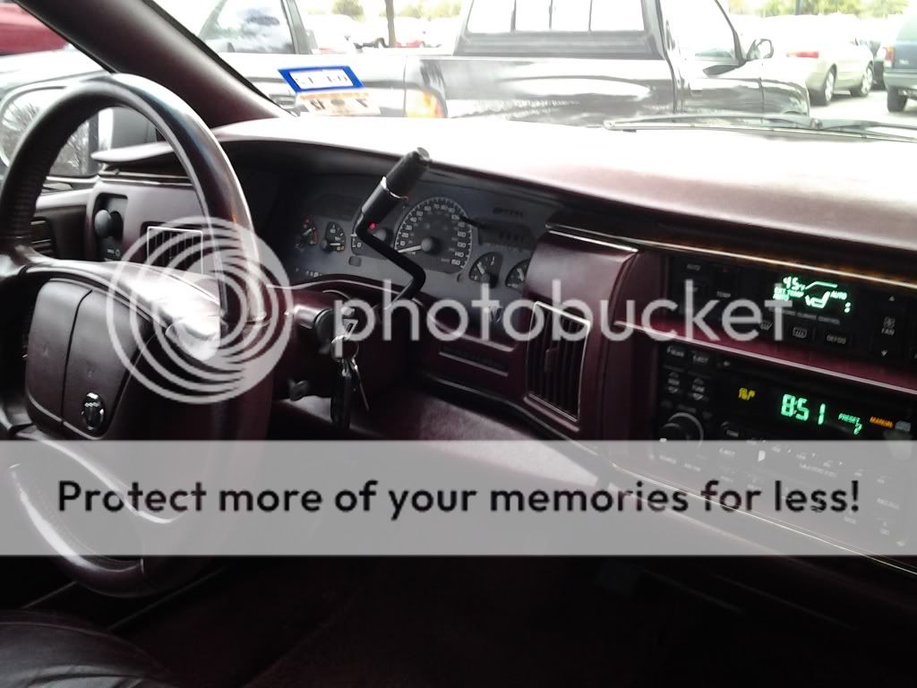

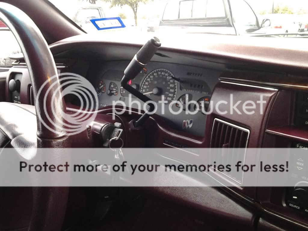

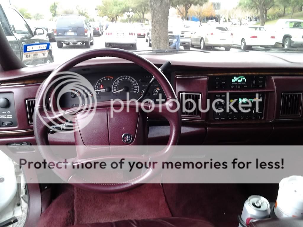

    Ok....guess what I did last night? That was more work than I thought. Had to cut away some of the upper dash to get it all to line up.
    Lets start on a positive note. It looks fantastic and after messing with it a bunch it all lines up well. Took the pics below with my cell phone camera when I got into work this morning, so sorry if they are a little blurry.
    Now for the not so good...and I am somewhat bummed as I've wanted to do this mod since I bought the car.

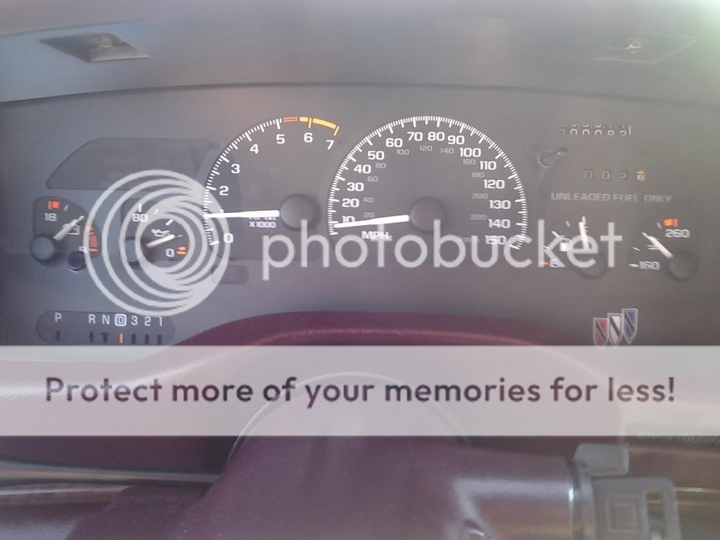

    Here's the deal. The oil gauge is not reading correctly. When fully cold, it only goes up halfway on the gauge, and when warm, it drops to nearly the red area at a stop in gear, and only goes up a bit when driving. I did swap out the sending unit with the one that came with the cluster. I'm hoping there is another sending unit option I can go pick up to correct this.
    Pic is of the car in gear with a warm engine:
    Then there is the temp gauge, which seems to read too high. On the old Roady cluster, which was just a Cold/Hot gauge, my needle never went over half way. With this cluster, it reads well over half way when warmed up. It never goes to the red, but sure reads higher than it ever did on the stock cluster...and it was only 45-degrees this morning.
    This was taken in gear, at idle, after driving 5-miles to work this morning:
    Lastly, I think the tach may be off. I'm worndering if, being a '96 model with OBDII, if the signal is wrong. At cold start it goes to 1000rpm and then reads 800rpm in gear. In normal driving it shifts just under 2K rpm and I got on it once and it never went above 2800 rpm before shifting. At 70mph it's reading 1800rpm. I've not done the trick with checking the gauge against the digital readout using the climate control screen. Honestly after all the expense of this, and all the work it took to install, I was pretty down in the dumps last night.
    On a positive note, the PRNDL looks and works perfect. All the gauge lights work, signals, high beam, seat belt, security, all work just as they should. I had put blue bulbs in at first but didn't like the look so went back to white before buttoning it all up.
    The speedo reads perfect, I ran it against my Garmin. Fuel gauge seems to be fine, and both the regular and trip odometers work fine. My car has 18 miles on it as I type this now.
    So that's it. If anyone has ideas on why the gauges read what they do, I'd love to hear them. I for sure want to/have to fix the oil gauge....reading just above red is already driving me nuts.
    I suppose the temp gauge could be correct....maybe it's the difference of going from just a hot/cold gauge to one that is based on an actual number. It never gets up to the red...it just seems high.
    As for the tach....I have no idea, but it sure seems like it should be in the 2000's before shifting, especially when pulling into traffic. It sure sounds like the engine is going faster than what it's reading.
    Arrghh... I'm know I'm crazy, but I was really looking forward to having this, and now that I do, it does not seem to work right....
    -Mike
  6. silverfox
    silverfox New Member
    Feb 18, 2009
    16,780
    Wisconsin
    The temp gauge looks like it may be correct to me.
    OK...the oil pressure gauge has been problematic on these cars.
    FIRST: try both available sending units....disregard that one is for a light and one is for a gauge. If that does not work....
    SECOND: you will have to do the "fix" by finding the correct wire in the harness up behind the glove box and bypassing the resistor in that wire. Not as bad as it sounds. Here is a thread that will help. There are others there, too. They have pictorials so it should be a cake walk.(y)
    http://www.impalassforum.com/vBulletin/showthread.php?t=227401

    It almost looks like 750 rpm in the pic, thats not to far off from what it should be. Also how deep into the throttle were you when it changed gears? Like they said borrow a guage or in this case a stand alone tach to find the base line.
    I think it looks great by the way. Easy to read. I like it. :thumbs2:
    Keep at it, it wont take long.

    Just got REALLY done with my Z28 cluster install in my Roadmaster wagon. Want to thank Gary very much for all the help. He got right back to me and answered all my questions, and is helpful and great to work with.
    I had that issue with the oil pressure gauge reading too low when I first installed my cluster. It caused some frustration but the fix was easy. Originally I installed an O'Reilly aftermaket sending unit for a 9C1 Caprice. I swapped that for a Delco sender for a '96 Z28 and it fixed the problem. Sender was $45, so a little pricey, but well worth it. Make sure to pick up a sender socket as well, about $10 at most parts stores.
    Oil Pressure is FINE now!
    Before the mod....Bye-Bye Granpa!
    A couple other good things to know. The temp gauge gets it's signal from a different location on the engine than the readout on the climate control when in diagnostic mode. In my case the gauge reads a little higher, but that's just because of where it gets it's signal.
    A really good upgrade is to swap the Z28 bulbs for 194 bulbs. The Z28 cluster is dimmer than the Roady cluster. Putting the 194 bulbs from the old Roady cluster made the Z-cluster much brighter.
    Roadmaster gauges are backlit blue/green, and the Z-cluster is white...unless you get the PRNDL option, which lights up blue/green. I tried adding 194B (blue bulbs) first but it just looked wrong, so I went back to the clear white bulbs. It looks odd the first time you drive at night but after 5-mins you'll be used to it.
    The dash panel behind the cluster does need a good bit of trimming to get the cluster to sit correctly, but Gary builds the Roady units using older Roadmaster clusters, so the mounting points are all the same, and once the dash is trimmed correctly, it sits perfect and for all the world looks factory.
    This is a great mod and well worth the effort!
