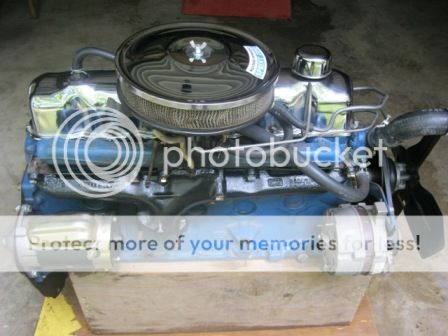

    I LOVE old straight 6 cylinders, love their sound, look, just love them. And at $4.00 a gallon they make sense.Of course you can modify it if you want and that's ok too. But, have you noticed at car shows, the cars that people look at are the different ones from the norm-the norm being V-8's. Most Novas ,Camaros, Mustangs, Coronets, and Falcons have been switched to v8. I could see converting the 6 to throttle body efi and it would be a great driver. Just what my opinion... I love the old Falcons- Did I mention I also love straight 6's ??

    Then this link is for you 7tvista.
    But you have to like Fords!
    http://www.classicinlines.com/PhotoFordSix.asp
    These show some of the possibilities for the straight six.
    Nothing for this engine is a bolt-on like say, the 302.
    If you want to modify it it will usually require some creative fabrication.
    Fordsix is about the only place that has any performance parts for the I6.
    There used to be Clifford, but that's sort of gone by the wayside.

    http://www.myrideisme.com/Blog/green-gas-runnin-ford-falcon-turbo/
    Will and Kelly McLearran have a '63 she drives at the drag strip.
    Probably one of the most heavily modified small sixes ever, a turboed 250.
    She is a breast cancer survivor and races for the cause.

    There's a nice 200 with a 170 head for sale, $1200.
    http://fordsix.com/forum/viewtopic.php?f=86&t=68777
