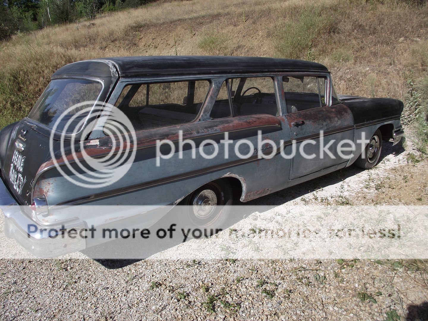

    While the mrs was out I pulled the 58 out and soda blasted off more of the old primer.
    It's taking about 5 kg of soda per panel and 2-3 hours and doing the door and 1/2 the fender
