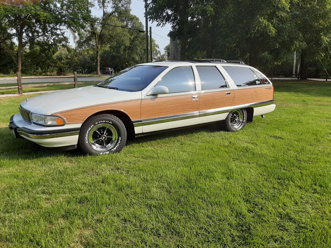

    upgraded my late son Tim's wagon with some new tires and some old school wheels.
  6. Silvertwinkiehobo
    2,995
    That looks sharp!
