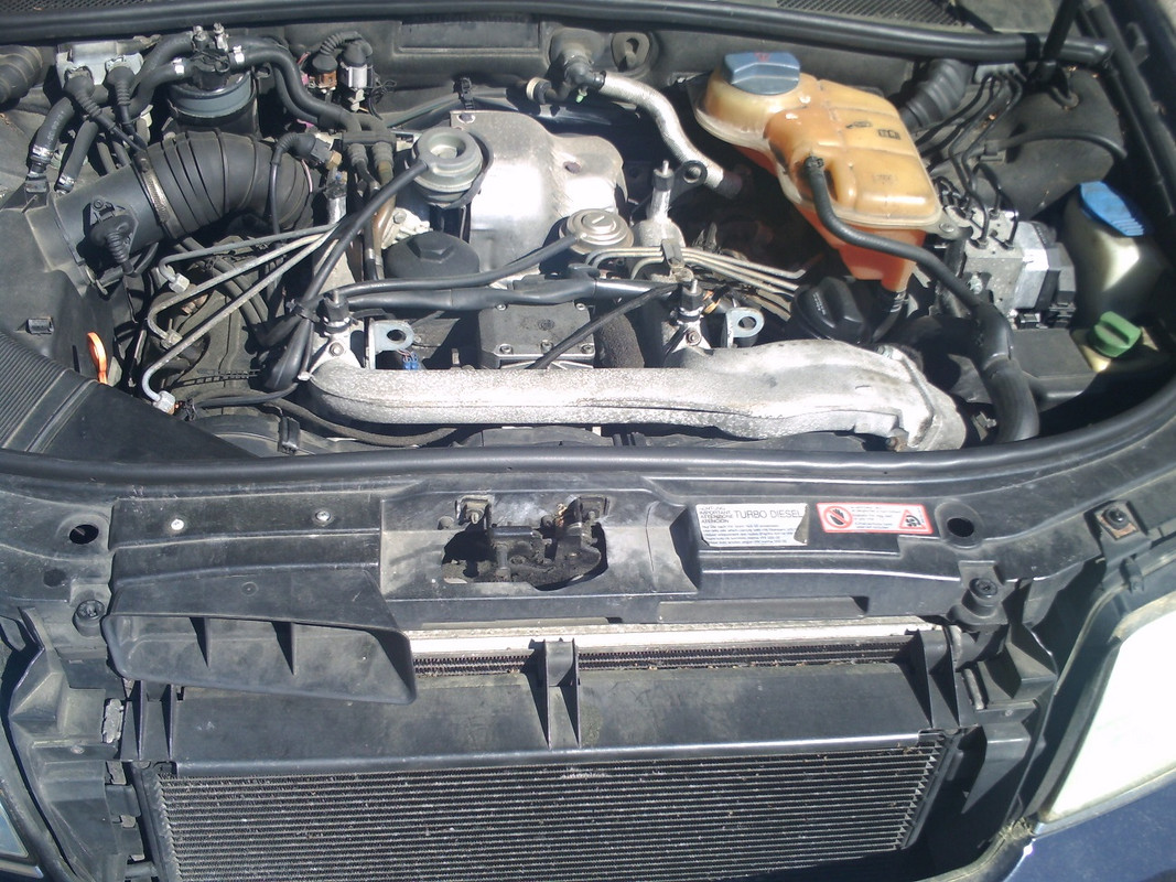

    I went out and got a polishing kit with enough in there to do two headlights. I spent hours trying to undull the one. But, am sceptical about it getting through inspection. I also removed the engine trim. Nothing looks ballsy, under there. It all looks more like refinery plumbing. Maybe, that's why they covered it all:

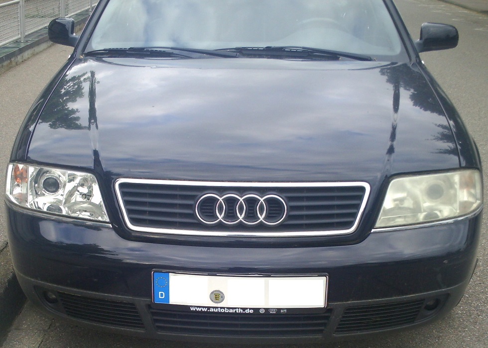

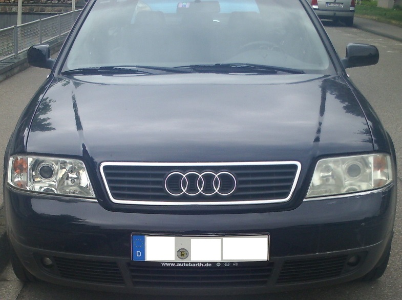

    Before and after. I'll have to park it in front of a wall, at night, to see if there's a great difference:
  4. Silvertwinkiehobo
    2,993
    It's better; go buy a higher-intensity bulb for it.

    I think the difference is quite impressive.
    It's the little details that make a car stand out from all of the other hum-drum vehicles to be seen at any given time.
    Grizz likes this.
  8. Poison_Ivy
    It's those details which worry me, when I carefully watch the inspector's thumb, to see if it'll point up or down. I pulled up into a parking space which had a wall in front of it, last evening. As soon as it got dark, I went out to see if there was any major difference between beam patterns. Unfortunately for me, ivy was growing on the side of the wall where my right hand beam was projecting. I could still see the beam division, projected by the left hand beam, which might not have been visible before the polish job. The car has had its last inspection only two years ago. I can't imagine the headlight suddenly dulling out that bad, since then, and I have no records of the right hand lamp having gotten replaced. Since I just recently found out that they even make these from plastic, I'm not sure as to if it's possible for one of these to look brand new, after 19 years of service. In a worse case scenario, I might have to go get a new headlight which begins at 130€.
    Today, it's not going to be the fun part. I'm driving it up on ramps and will see about removing the entire exhaust system, to get at the soot filter. Just like how it looks under the hood, the floor pan looks like it's stamped around the exhaust and not the other way around like it used to be on vintage American cars. If it looks feasable, I'll get it apart and then take the filter to the quarter car wash, in order to try blasting the soot out of there
