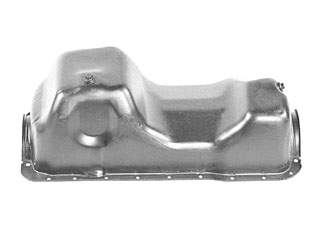

    It wasn't a water valve or anything like that, I looked in one of my books about the car and it showed an oil pan with two drain holes and oil did come out of this second hole shortly after loosening it.
    My Dad did say it could be condensation from storing it over the winter. Again, when I flushed the radiator last year you could say I super-flushed it because I kept on doing it until I got clear water out of it consistently then I ran it for a while before ultimately adding the coolant. I only drove the car yesterday for the first time this year after going clear from November storing it, though I did idle it in the winter just to keep things flowing.
    I didn't notice rainbow drops. I did run the car for about five minutes before I started to change the oil, but by the time I got to opening it the oil wasn't warm nor was the engine. And, the water only came out of the sub-drain hole - I doubt it was as much as half an ounce but it was certainly more than ten drops. But, a person may think that cars just shouldn't have any water in the crankcase. I can't go measure the water now as I cleaned the pan.
    You know what, the funny thing is when I flushed the radiator (fewer than 290 miles ago) I did see water coming out of the tailpipes as I had a garden hose attached to the flushing system and every time I start the car I see water come out of the drive'r side tailpipe, but it does have a fairly new exhaust system and maybe a catalytic converter too. Ironically, if a head-gasket is leaky (I'm not saying it is) then I may have steam-cleaned the pistons.
    As for the thermostat, When I was in Autozone I thought a failsafe one would be nice but it wasn't set for the right temperature. If it was set to stay permanently open about thirty or forty degrees higher, then it would be fine. But with staying open at 192 degrees when the heater opens at 193, it's just a disaster waiting to happen if I don't change it.
    Oh and another thing: It appeared as if this sub-drain hole hadn't been opened for quite some time, if ever. But thinking twice, the pan looked a lot cleaner than other parts of the car so I wonder if it's even the original pan. When I opened the sub hole there was also sludgy oil coming out, so it's possible that the previous owner just took it to a shop that never opened that plug and that may have gone on for 20k miles' worth of oil changes. However, the sub pan hole is higher up than the primary one and holds much less oil. Here's a photo of what mine looks like:
    It's upside down, but you get the idea; Primary oil drain on the left, secondary on the right.

    Now that I see the oil pan I realize some Fords had an extra front sump to clear steering. That is your second drain plug.(y)
