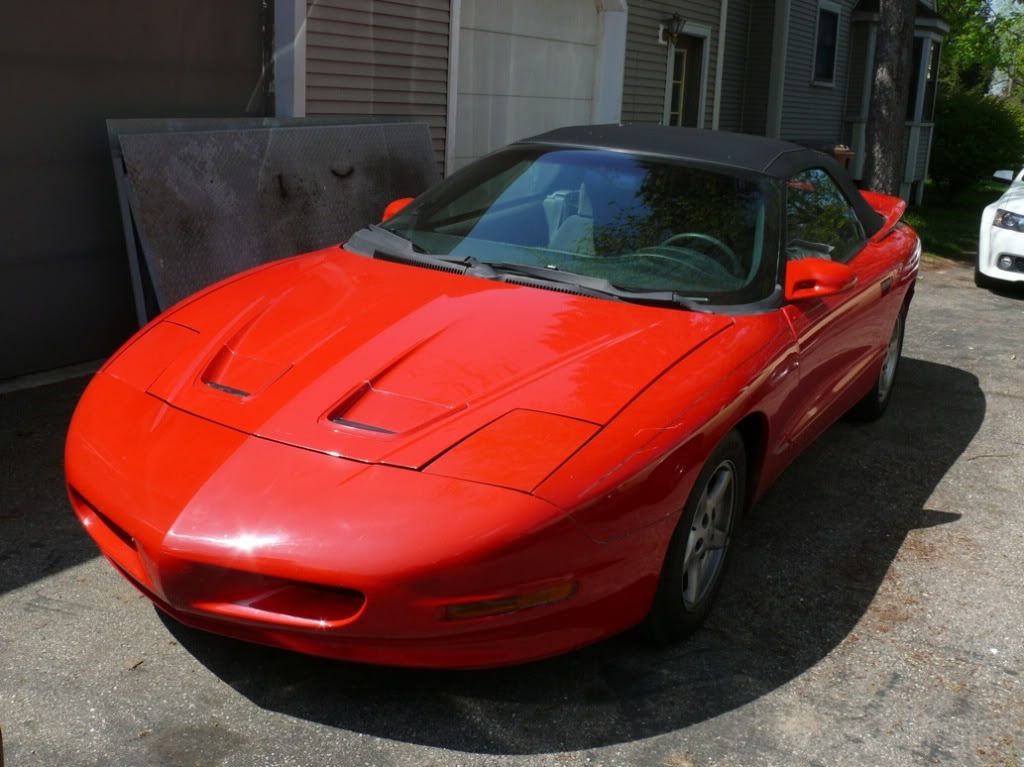

    (1) 1969 Firebird Sprint, now with a stroked 301 OHC-6, T-5, and 4.10 Posi 12 Bolts. Fun Car.

    (4) 1997 Firebird Convt, 3.8 V-6, T-5, 3.23 Posi
