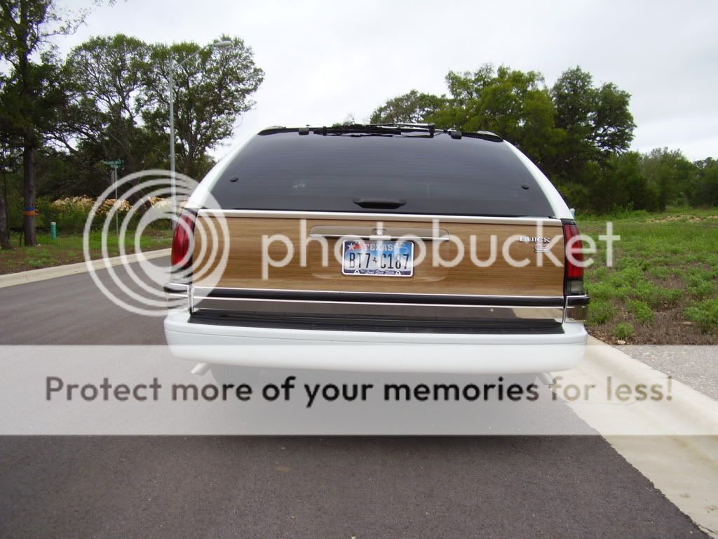

    Mine was in fine mechanical shape, but needed a little cosmetic help:
    Before - As Found:
    Today:

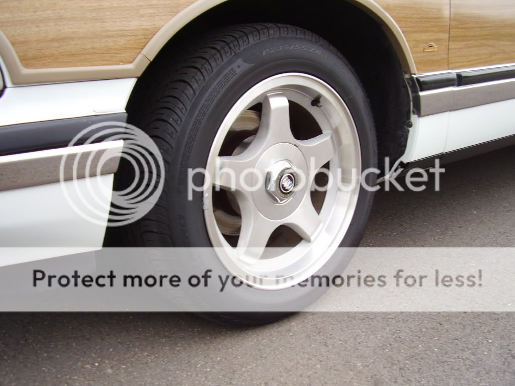

    Thanks for the wheel comment. Was one of my first mods. I also went further with custom center caps decals:
    Impala SS wheels are still fairly common. Look in the auto parts section of Craigslist.
    If you get a set and the clear coat is discolored or peeling, go to the parts store and buy a jug of Tal-Strip Aircraft Stripper. Don't get the spray, buy the large jug, pour some in a paint pan, and use a brush to paint it on the wheels, and then once the clear bubbles rinse it off with a garden hose. May take 2-3 coats to get all the clear off. Once the cleat is off use some good wax on the bare wheel, and that's it. I've had mine on over a year stripped of the clear and they still look great. Just keep them clean and wax them now and then. Oh just wax the smooth part, not the rough-texture part, it's fine unwaxed.
    ALSO, here's a great tip. Someone on the Longroof forum suggested I try 235/55/17 tires. These are not as wide as the Impala SS tires were, they're also a little taller, but still much wider than the original Roadmaster wagon tires. Was told these end up being the same height as the 255/50's so the speedo would read right, and with the taller sidewall the car will ride smoother and not "road-walk". I was concerned they'd look funny, but was sent a pic of them on a Caprice wagon. They looked fine in the pic.
    Now the good part, the new standard 2010-11 Mustang GT tire is the Pirelli P-Zero Nero size 235/55/17. What's the first thing many new Mustang owners do? Get bigger wheels and tires! SO there are a ton of new Pirelli take-off's out there at the used tire places. These list new for $159 each at Discount Tire. I got a full-set of new take-off's from a Mustang for $60 each, and it cost $40 to have them mounted and balanced. Woo-Hoo!
    These ride SO much better than the 255/50 Michelin tires that were on the wheels when I got them, and they don't tramline in the highway like those wide Michelin's did. They look great, and if I do have a flat on a trip these are stocked by most tire stores since they are OE Mustang. The Impala 255/50 size is getting hard to find.

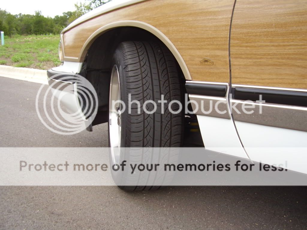

    Another tip, the black lower body side trim has a bad habit of coming loose and falling off the stainless chrome trim. REALLY common issue on Roadmasters.
    This is not a hard fix. Either pull back the trim if it's still mostly attached or remove it all if it's nearly off. Remove as much of the old mounting material as you can, and then clean both the black trim and the stainless side moldings REALLY WELL.
    Next go to the auto parts store and buy a roll of 3M grey mounting tape. This is the grey tape with the red backing. Buy as wide of tape as you can find, and then cut to fit the moldings.
    This works MUCH better than any glue, and all mine have been fixed and stayed fixed for over a year now. My tail gate trim and passenger front door trim were in the 3rd seat well when I bought my car, and the remaining trim was sagging.
    Before:
    After:

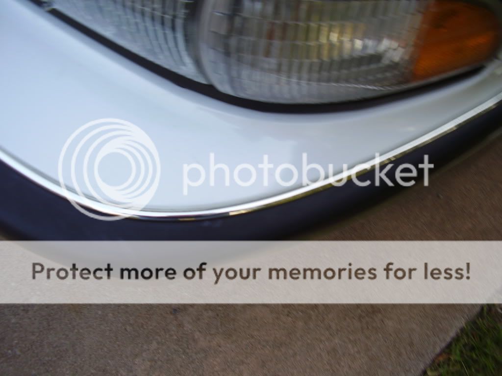

    Since I'm on a roll with tips, here's another. Cheap Upper Bumper Chrome Trim Fix:
    I went and got a roll of the chrome StyleGuard 3/8 inch Wheel Molding (part # T3605C) at O'Reilly Auto Parts. Was $14.
    Well here's my thoughts. It's better than what I had.
    The molding on my bumper was mostly yellowed and the clear had come off the chrome, and was sticking up in many places. Pretty ugly, really took away from the car.
    I was able to pry out the ends of each of the three pieces from the metal endcaps, and then pull the old strips off. I then used a razor blade to scrape off the remains of the old mounting tape, and then cleaned the leftover dirt and glue off the bumper where the strips had been.
    Mounting the new chrome molding was easy, the molding comes with 3M tape already on it, and I just cut the strips to length. The width is correct and I had no problems getting the ends tucked back under the metal end caps.
    Now as to why it's just "better" and a not "great" repair. The issue is anywhere the new strips had to curve or bend to follow the bumper contours, they wrinkled. Not huge wrinkles, but not smooth chrome anymore either.
    It does look a lot better though, see pics below:
