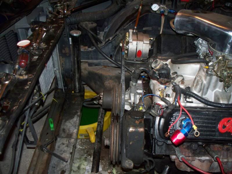

    Ok time for an update. My relocated altenator is almost done. I had to switch crank and water pump pullies as well as switching to a power steering box with 2 droove pulley. Only thing taht is really a problem is my oil fill tube. the aluminum rod I am using as a brace is in the way.

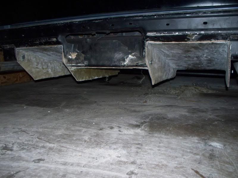

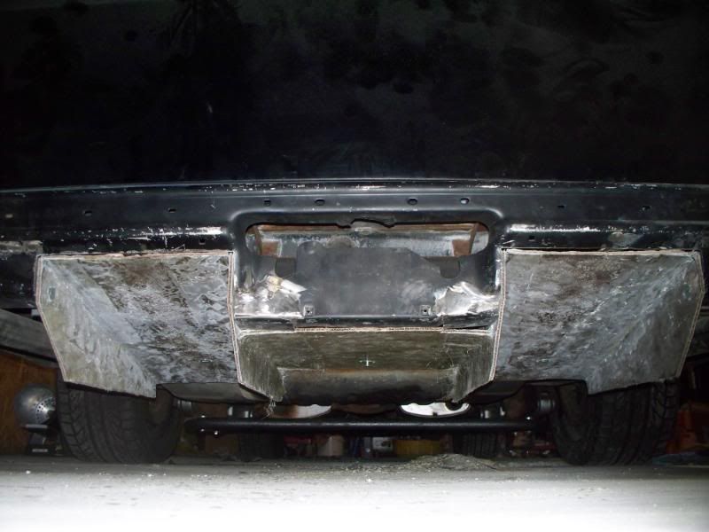

    I am also getting alot done on the diffuser. Both tunnels are pretty much done. they will simply need a final trimming and clean up. But for now they can stay like they are until I can mount them so I can make a center section to join them. At that point it will be one large piece that can come in and out as needed. I am really liking this look.

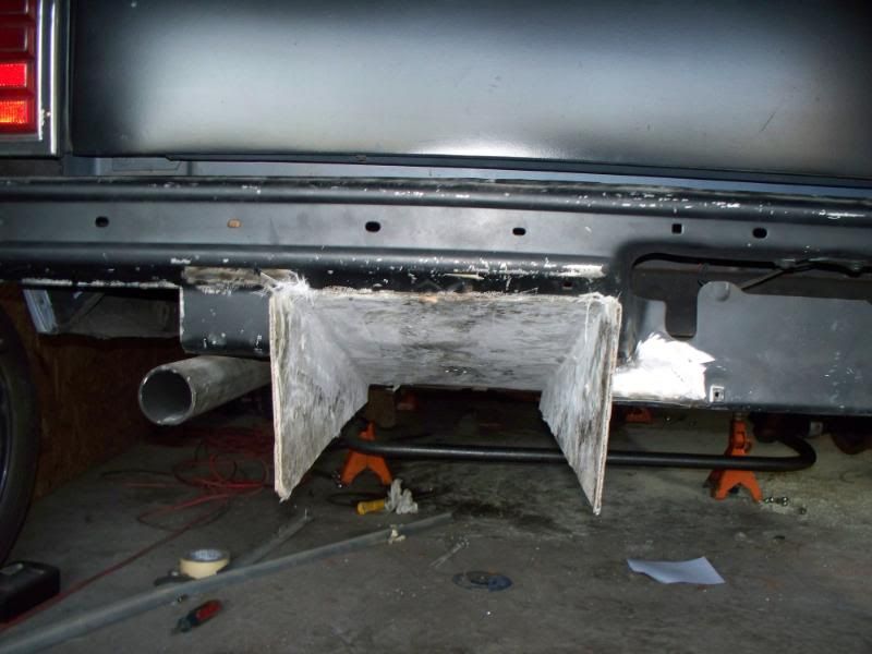

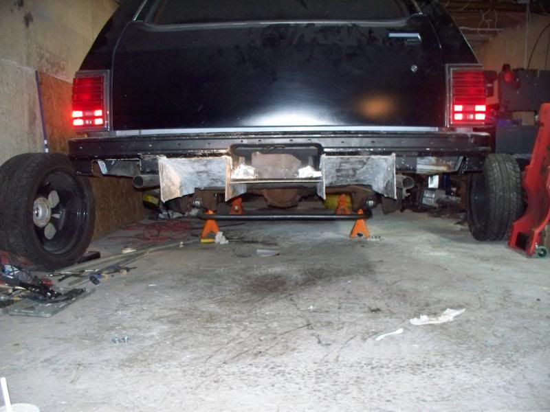

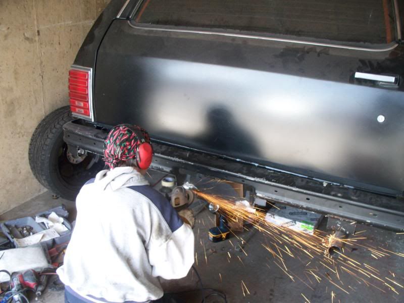

    Ok here is what got done today. Worked on the diffuser. Had to weld up the license plate holder. It doesn't come straight across so we fixed that.
    Oh and my welder cleaning up her welds lol.
    Finally real progress. One tunnel mounted with Dzus fasteners for easy removal.
    And both tunnels and center section mounted.
    Now all three sections need to be glassed together. And there is still alot of trimming and prettying up to be done. But I think it looks great. Not sure if I can get away with leaving the tunnels that deep. Also not sure about leaving them that far off the bumper. I kinda like it that way as it has a European Touring car look. Will have to see.

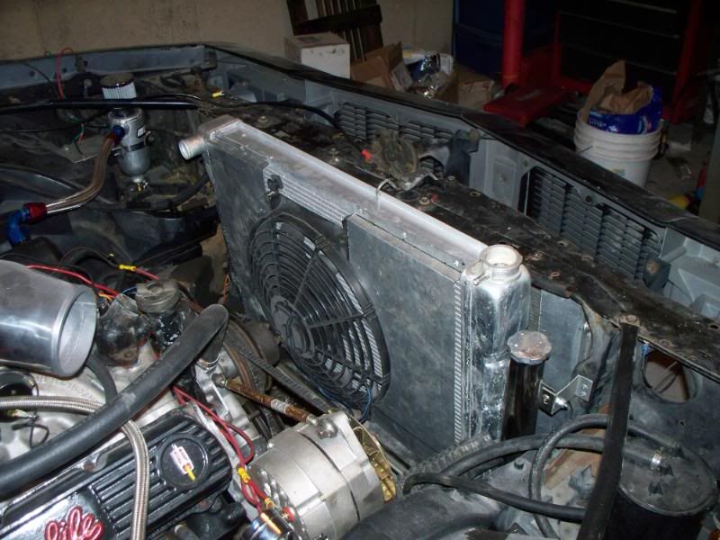

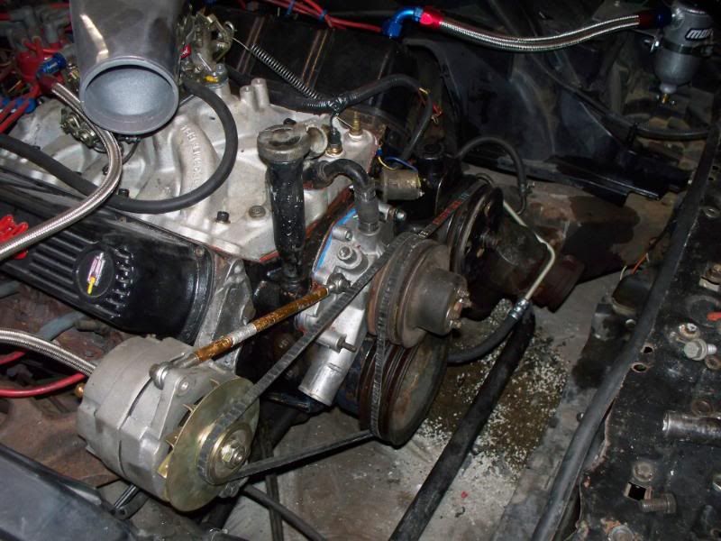

    OK I got some stuff done already today. The new passenger side altenator mount is done. Other than the aluminum tube that needs to be redone It came out nice. The belts are all lined up and the mount is sturdy. For those of you that don't know what I am taking about Olds motors can be tempurmental about having the accessories all on one side. I took off the A/C and relocated the altenator over to the passenger side one to make sure I had no problems and two so it has a more balcanced look and feel. I used the stock drivers side aluminum mount and simply flipped it drilled a hole and sanded the back down some as well as adding the aluminum tube as an upper brace.

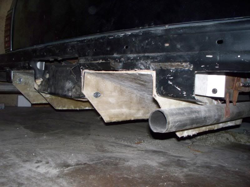

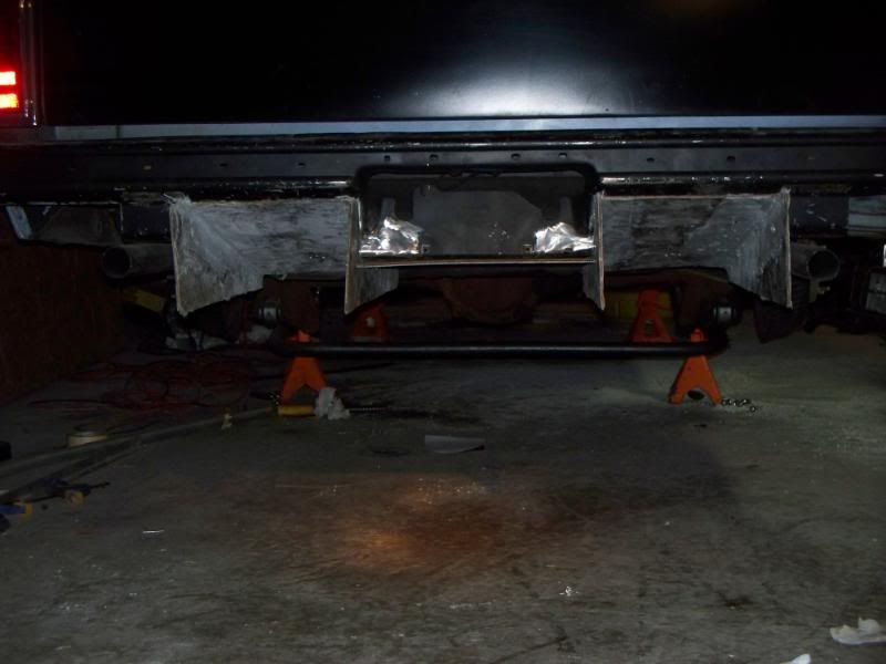

    Here are some pics of the diffuser after some trimming. It's starting to come together. It is by no means finished but it's getting there. I have 6 inches of clearance with it. I thought I might have to trim the bottom side but it looks like I can keep it that low.

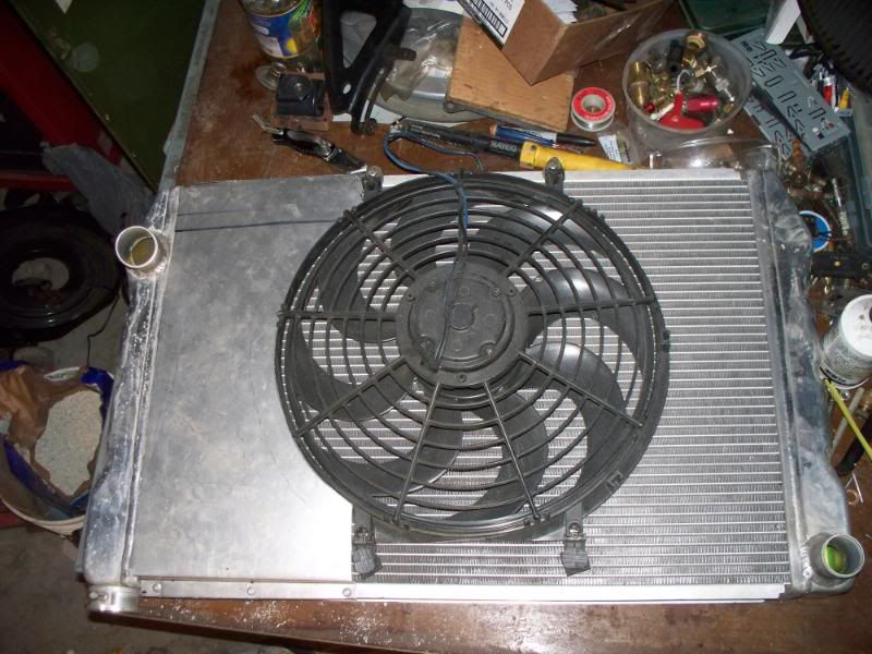

    Ok I have beed told I should have some kinda radiator shroud. So I made one. Just a quickie but looks ok.
    I also wired up my fan temp switch, lengthened the wires for my altenator to reach the other side. I hope to have her running maybe tomorrow. Also did a shakedown run of my hauler and everything seems fine.

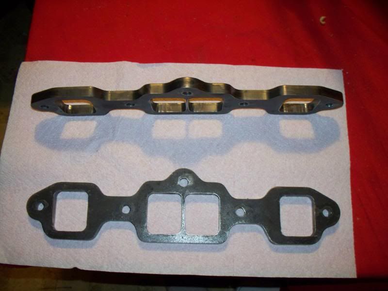

    Well I got my flanges in for the manifolds. Have to say they are pretty darn nice. I will be getting the weld els probably next week. So one step closer to my turbo manifolds.

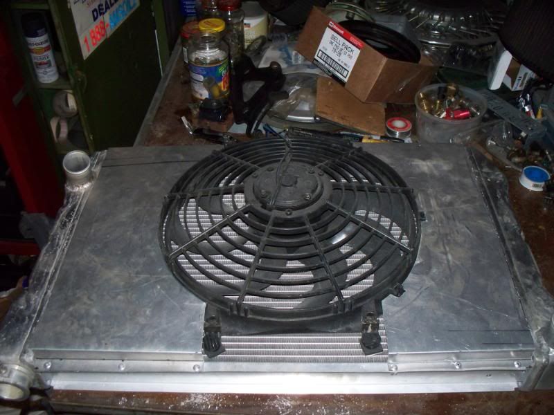

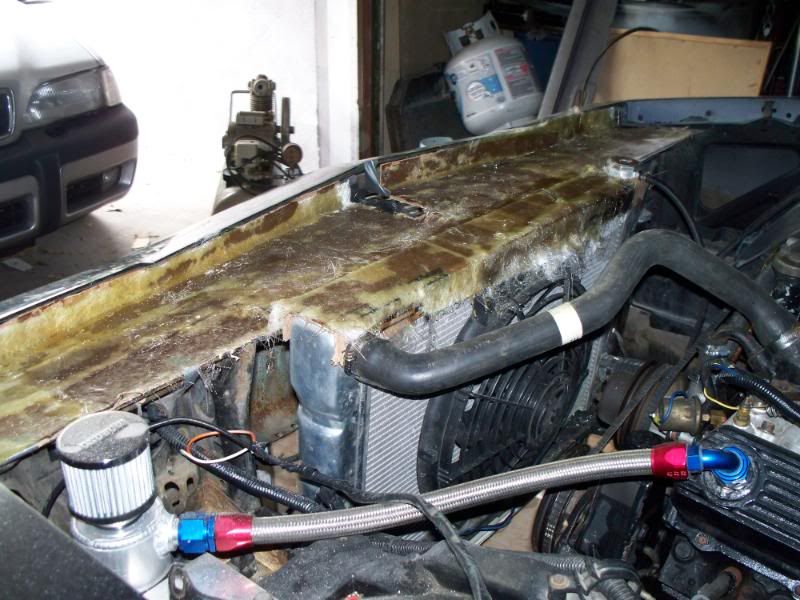

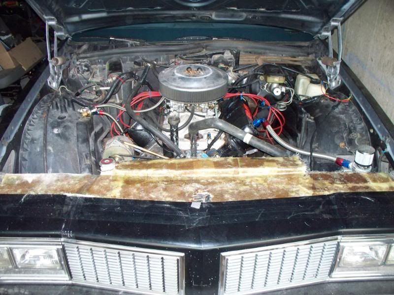

    Look what I did today. This is just the start of the piece to fill the gap between the nose and radiator support, cover the top of the rad support, and cover and support the top of the radiator.
    I also removed my passenger side door panels. Stripped my door cards. And then put some fiberglass on them to stiffen them. I am going to have to decide how I want my door panels to look soon.

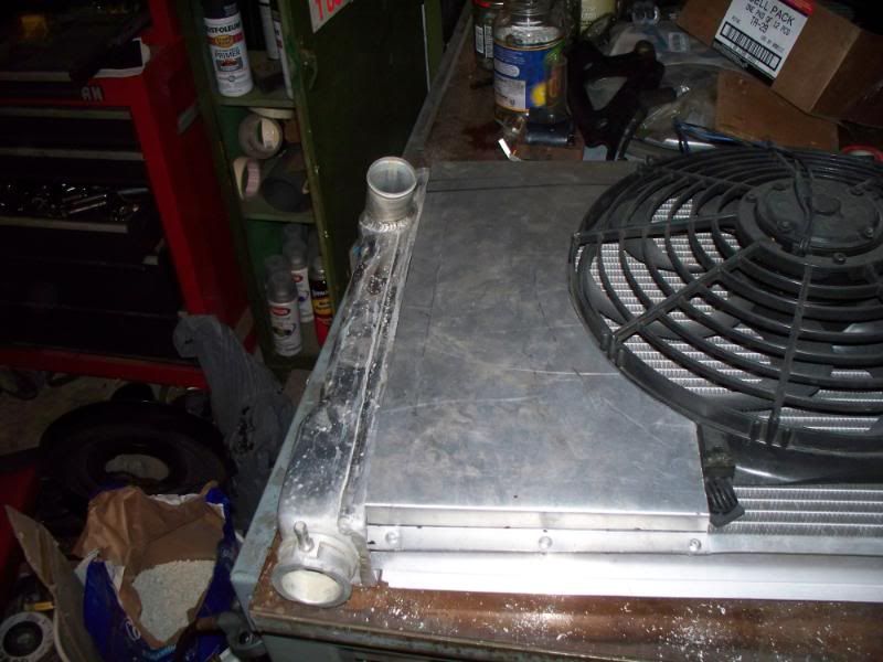

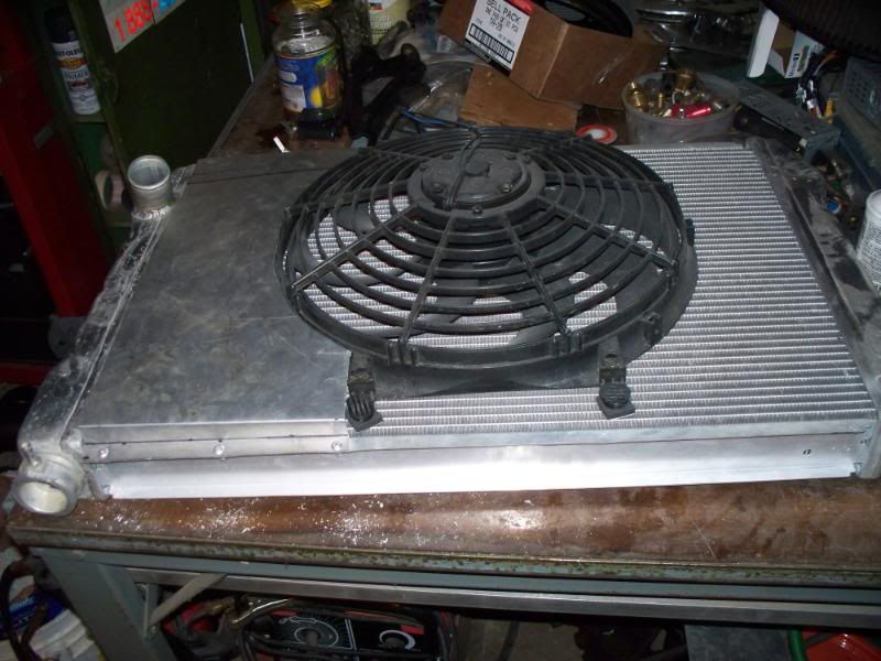

    I got a little more done to the radiator support cover. It is really coming along, Today I got the top part of the radiator done. There are a few spots I intentionally didn't do. I will get to them in finer detail when it's off the car. Once this sets I will remove it do some trimming and put a layer under it and then it should be plenty strong.
