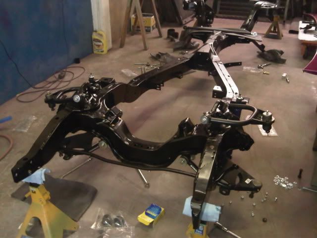

    Anyway, if the Rev can keep it down for a minute, I have a little update.

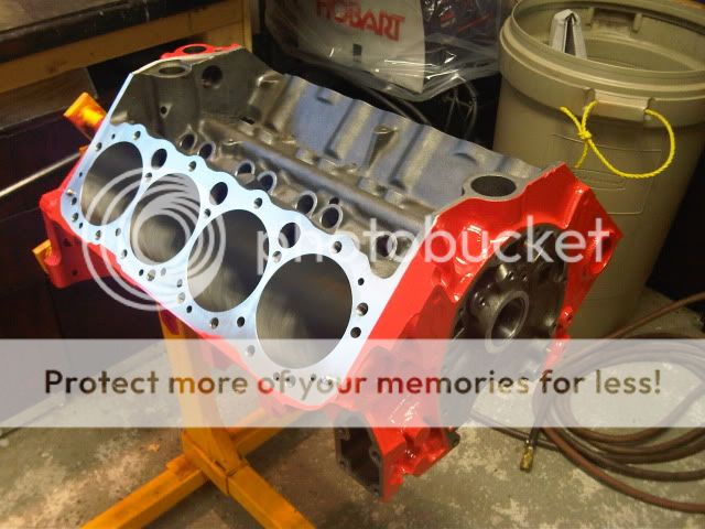

    First, got the engine back from balancing and blue printing. It's a 327 out of a 1965 Corvette. Rollerized, Dart Heads, Eagle Rods and Crank, Kieth Black pistons. It being built with alot of torque so I can tow my boat, or maybe a cool camper trailer in the future, and be confident in doing it, motor wise.

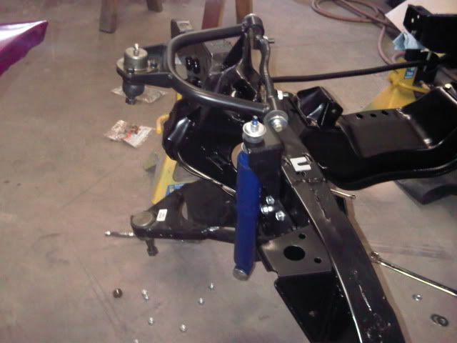

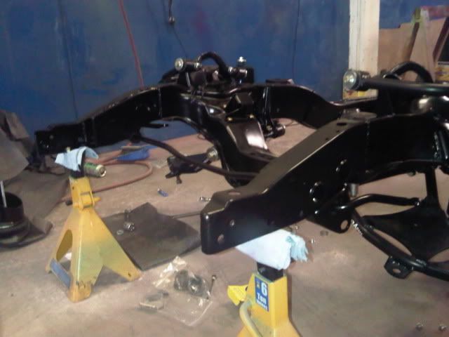

    I also got my frame back from the powdercoaters. The upper and lower, front/rear tubular control arms from Air Ride Technolofies have been installed, and the frame has been reinforced in the back, so that towing will be a safe propsition.

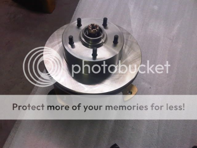

    Also have the Stainless Steel Brakes front set up going on. May do the rear as well, at another time. But I figure it will be a little safer with the kid in the car, while towing.

    They had side rails too, but I guess that's done or replaced too. This wagon is gonna outlast me at least. Extreme Resto. My respect. Awesome.:bowdown:
  11. tbirdsps
    May 26, 2006
    5,340
    Ridgecrest, Ca.
    How fantastic is that? The engine and frame are....art!:cheers:
