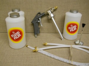

    Yes, the car should be at least on jack stands and you could brush it on or you could spray it. If you spray it, I have to once again say you really should not breathe it. The first time I breathed it, I got a hefty dose and my mood went all over the place then I dreamed that I murdered Gomer Pyle by spraying him with Fluid Film. And no, I'm not kidding; I did dream that.
    Here's the gun I used:
    It comes with tubes that can attach to the end of the nozzle; assuming that older (pre 90s) wagons have plastic inserts you may remove, you could insert the tube and spray the fluid film in quarter panels and rocker panels from the inside where you don't have access otherwise. I did this on my Suburban and Explorer. If rust is present, it won't stop it but Fluid Fllm does prevent water from staying.
