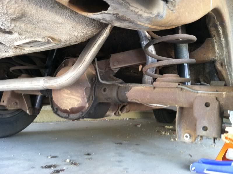

    Oh and for you rust belters..
    I wanted to make sure nothing was leaking from the brake system. Calipers and drums are clean as a whistle!

    The new radiator is in, along with new hoses and thermostat. The hoses didn't come off with out a fight thought! Oh and the original radiator was pretty nasty.
    But now it has developed a whine that follows the engine RPM. Not sure what it could be, haven't time to check it out.
    Also I have noticed the rear passenger side is sagging/sitting lower than the drivers side. Could this be a bad spring? Or something else?

    Any ideas on why the rear is sitting uneven? It's kinda buggin me...
  12. DanR63
    DanR63 Well-Known Member
    Feb 25, 2012
    298
    23
    50
    Mchenry,IL
    Due to the age of the car the rear springs could probably use to be replaced. as well the as the shocks. Doing rear springs and shock on one of those should be pretty easy. Lift the car and put jack stands under the frame just before the rear tires. next use the jack to lift the car by the center of the axle and slightly lift the axle. Unbolt the bottom bolt(s) for the shocks and very carefully lower the rear axle (pay attention to the postion of the coil spring before removing). Once the rear axle is lowered the springs should come out. with the springs out it should be rear easy to get in there and finish removing the shocks. I would install the top of the shocks and then install the new springs. raise the axle and reinstall the lower shock bolts then lower the car. I am guessing new springs should be around $70-$100 you will most likley have an option to get standard or trailer towing springs. The difference will be spring rate (trailer tow will be heavier). The heavier spring will give the car a bit of a rake and be a bit stiffer. I peronally like a heaver spring in the back of these old wagons to get the back end up so they don't scrape pulling out of steep driveways. also you can get a bit more weight in them without sagging.
