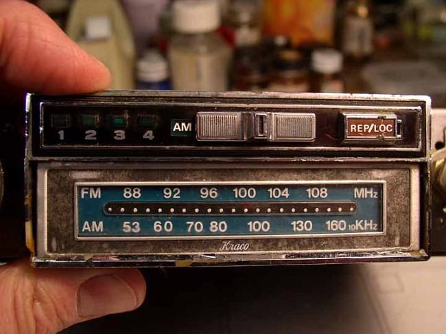

    This player is one of the cheap ones, a Kraco, and was free to me. Sometimes free is good and sometimes not so good.
    The first sign of worry is noticed right after pulling the cover off is the drive belt has been replaced with a rubber band. This is not acceptable as the rubber in a rubber band is too soft and stretchy. While the player will work, the sounds tend to speed up and slow down as the tension gives and takes. Better solution is to find a correct replacement. To do that take a string or strip of paper and wrap it around both pullys to form a loop. Measure that loop's length when squashed flat and that is the size you want to purchase. (or measure the length of paper strip and divide by 2). Best source I know of is NORVAC electronics. I have one in town and they have a whole rack of rubber drive belts for everything from mini tape drives to video recorders to telephone answering machines.
    The second sign that someone else had been here before was the tuner shaft shows signs of repair with a badly done solder joint.
    But... lets say those two are fixable, which they are if the brand was worth saving.
    Some other things to consider are the lights. Each indicator requires either a light bulb or LED. If any of those are burned out, the face plate needs to be removed and the light source repaired/replaced. Not easy but again fixable by carefully removing the offending item and searching out the correct replacement from NORVAC. At this stage a required tool will be a small pencil type electronics soldering iron and some electronics solder and none acid flux.

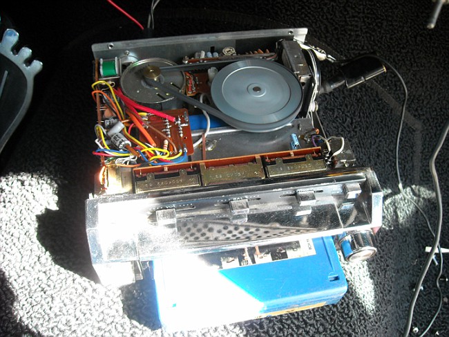

    Inside we see the camel that broke the straws back. In other words if all the other stuff was in perfect shape and this was the only thing wrong... I still would have trashed it. The head is damaged. (B)
    See how it points to the ground? Either someone was messing with the screws or something foreign was jammed into the player. A worn or damaged head can possibly be replaced but alignment is very difficult.
    (A) is the sensor which changes the tracks when the sense tape slides past closing the circuit. (C) is the capstan drive connected directly above by the large pulley.
    I rarely see either of these damaged or too worn to work correctly. Dirty... yeah, but never too worn. The red arrow is pointing to a piece of trash not belonging to this player.

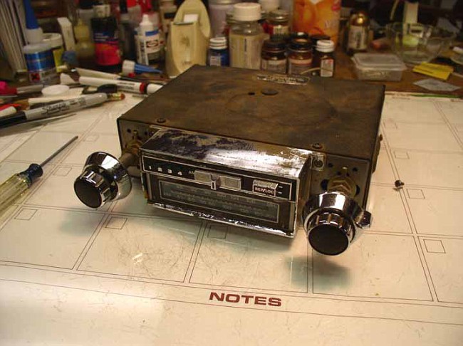

    Been a while since I posted here. So thought I would add some more info for those who want to repair their vintage tape player back to operating status.

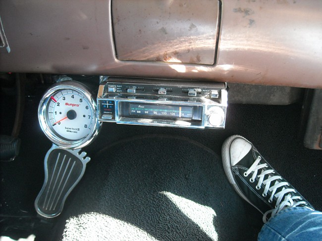

    The 8-track player in the '58 Surf Rat stopped playing, but I still had the FM radio so lived with it for a few weeks before breaking down and repairing what I thought was a broken belt. * (the cause of most 8-track failures)
    Started out by removing the player from the dash....
    ... then removed all the screws on the outside case. That is the case-half that appears to be the most prominent... and THAT's usually the primary half which encloses the belt drive. The other half can remain in place.

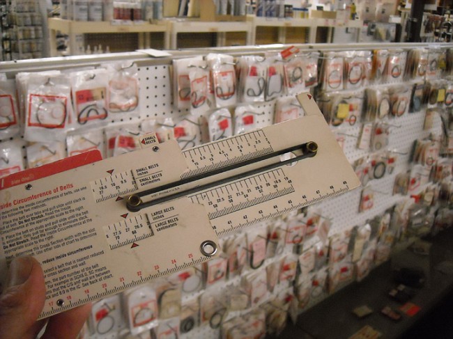

    Remove the belt and take it to your local electronics store.
    My store is NORVAC Electronics which I feel blessed to have such close access to. The isle at the store containing the belts at first seems a little overwhelming...
    ... but what you need to find is this little tool.
    What that tool is, is a device to measure your belt both width and length so you can find the right one out of the hundreds on the rack.
    Mine was 9.7 long and about 3/16 inch wide so finding a replacement was a cinch.
