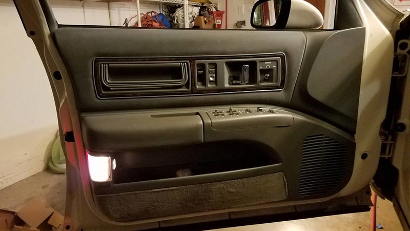

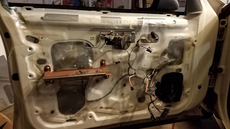

    I don't like dealing with rivets, so to re-install the regulator assembly and arm rest mount, I use 1/4 inch bolts, with round washers and lock washers, You will need a total of 11 bolts to do this job.
    You will want to re-stick/tape the plastic dust cover on the door panel before installing the arm rest support. Reach up from under the plastic to install the bolts. The arm rest support mounts over the plastic dust cover. I then cut off the excess bolts using my whizz-wheel.
    Carefully re-route the wiring through the plastic dust cover, and then re-install the speaker. Don't forget to plug in the new power window motor and the power lock actuator.
    About to re-install the door panel. Wires run, speaker installed, all new bolts trimmed as needed, and tested operation of all electrics.

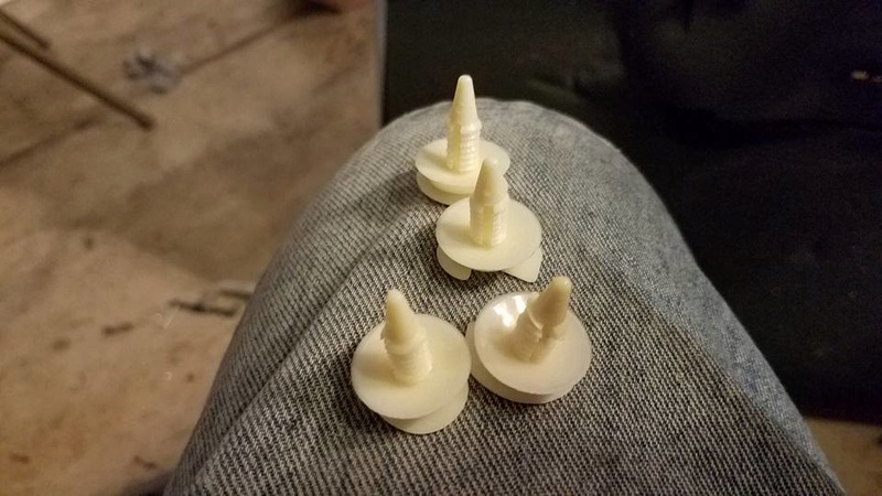

    Once again, I install new Christmas Tree clips from Napa on the door panel before snapping it on. Want no loose panels, and these really only hold tight the first use. Wrth $5 to get a new package.
    Door panel re-installed and wires run to correct locations.
    Note, now is a good time (before installing this bezel) to check/replace the tiny bulb above the door handle that illuminates with the headlights to shine on the power window switches below. Dark here, see next pic with new bulb lit and working.
    DONE. Panel is tight, window works like new. NOT a fun job, but can be done in an afternoon if you take your time and think it through. Hope the step-by-step helps someone else!

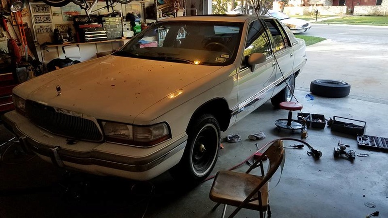

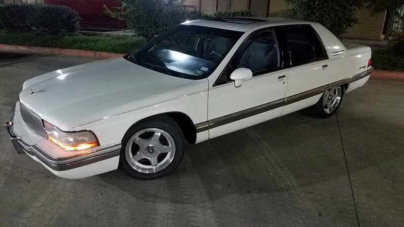

    While I worked on replacing the driver's front power window motor, my son Eddie jacked the car up, painted the brake drums and inner fenders black, and installed the gorgeous refurbished Impala SS wheels with Buick center caps and brand new 235/55/17 tires.

    9/4/17 - Made some good headway on the 92 Roadmaster Sedan project this holiday weekend. Headliner done, exhaust done, window motor replaced, and new wheels and tires installed. Still have to do the radiator flush, thermostat and idler pulley, and need to paint the bumper trim and install the new side moldings, and car still needs a top-to-bottom detailing, but it's looking a lot better now and it drives TONS better with new tires, shocks, and great air conditioning. COMING ALONG!

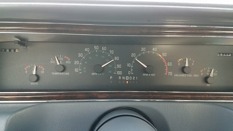

    The rear-end gearing on the 92 Roadmaster Sedan is hilarious. Look at the tachometer at 80mph. Hahahahaa!
    This car is just geared way too high with the 2.56 axle. I had the same motor in my 92 Custom Cruiser, but with the 3.23 tow pack rear, and it felt like a rocket in comparison...and the transmission didn't have to downshift for every incline either. I've got 2.93s in my 96 Roadmaster Wagon...but it actually IS a rocket in comparison, ha! The wagons both turn in the low to mid 2000-rpm range at 80mph. This sedan is just hilarious...and additional forward motion on the highway requires a downshift before anything happens. It's no wonder the 2.56 cars lose transmissions much sooner than tow-pack cars. That transmission is constantly working against those gears.

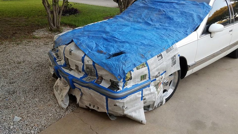

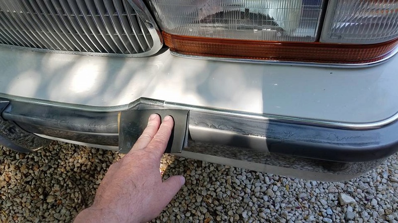

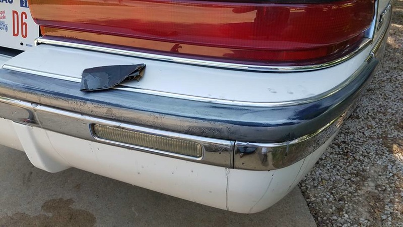

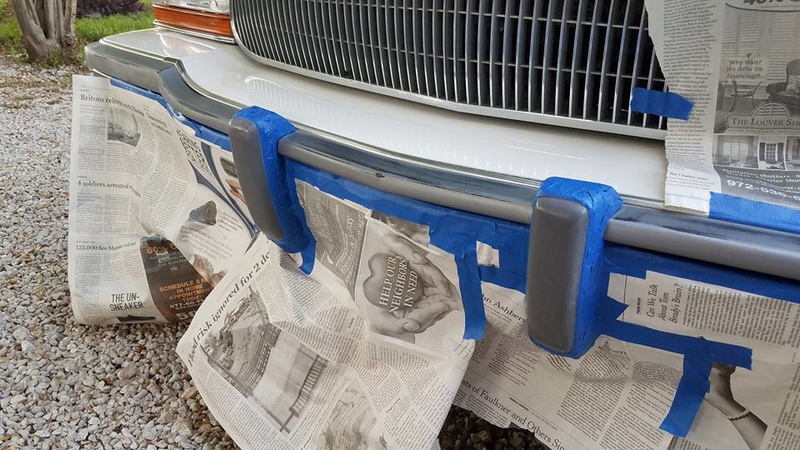

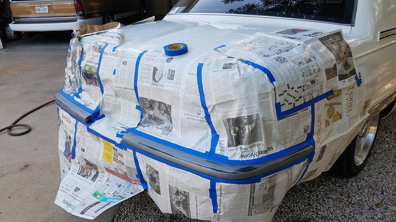

    9/6/17- Evening project, wet-sanding faded silver bumper trim for new paint. Changing color to black.

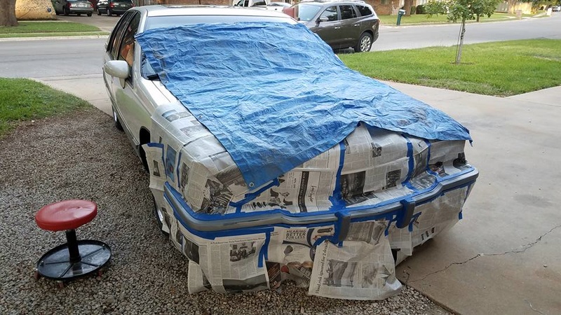

    9/6/17 - Masking the Roadmaster Sedan for black bumper trim paint.

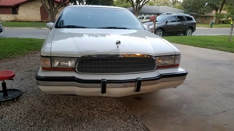

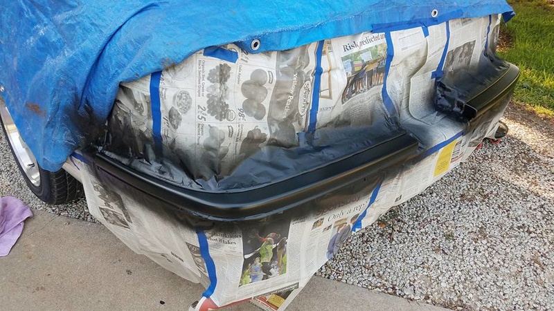

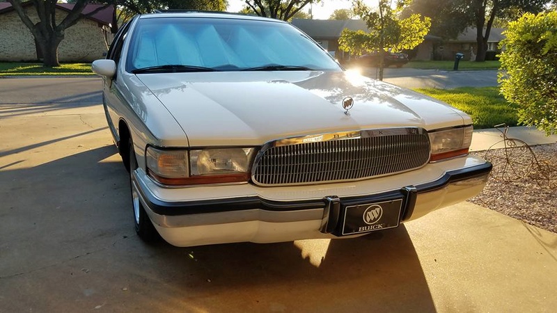

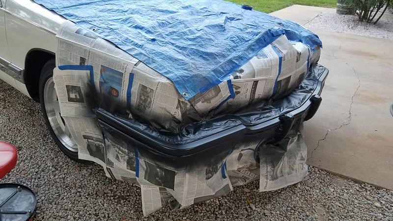

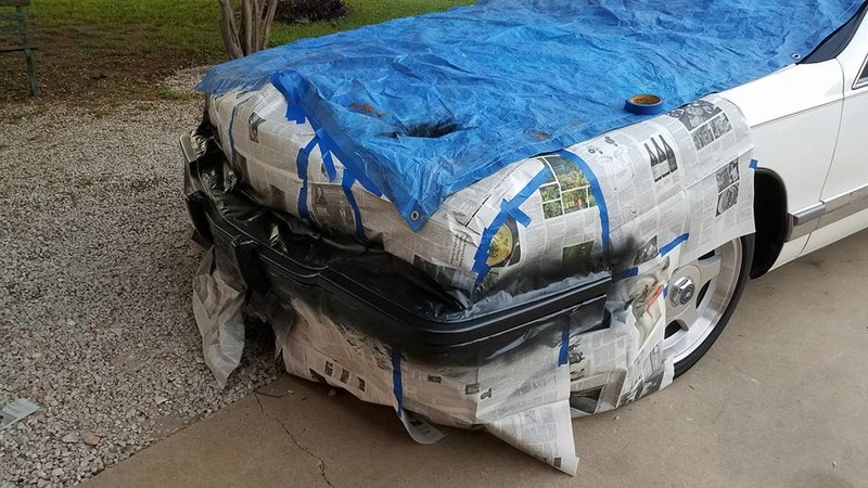

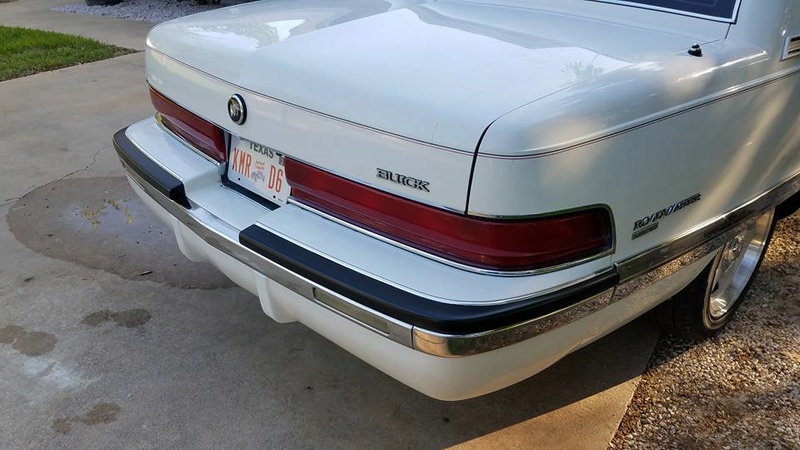

    9/6/17 - Painting the Roadmaster Sedan bumper trim black.
    9/6/17 - Freshly-painted black bumper trim. Just unmasked the car. LOVE the black so much better than the silver! Next project is to install the new black bodyside trim.

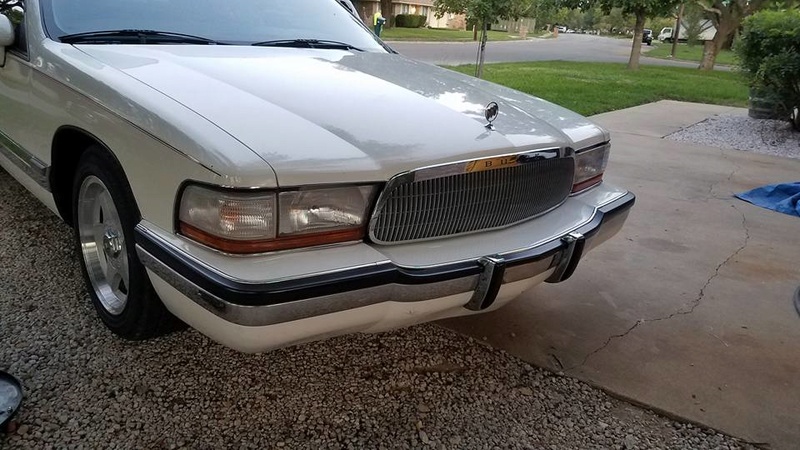

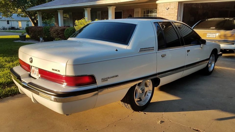

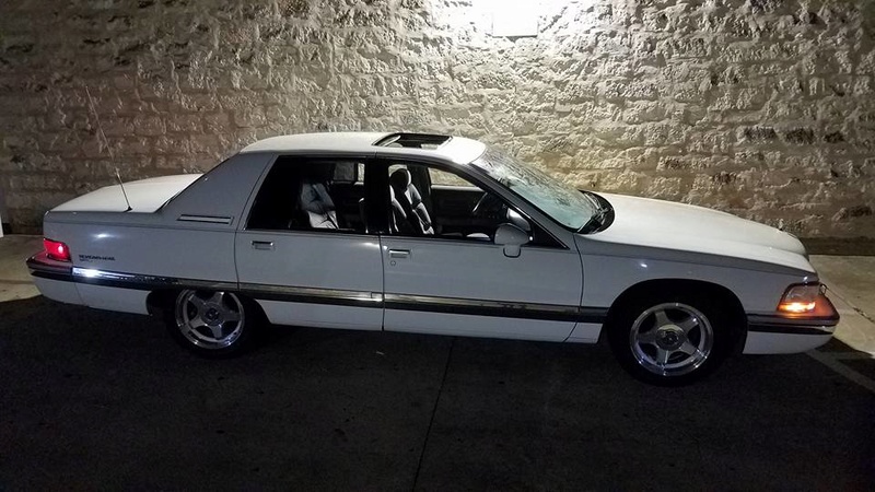

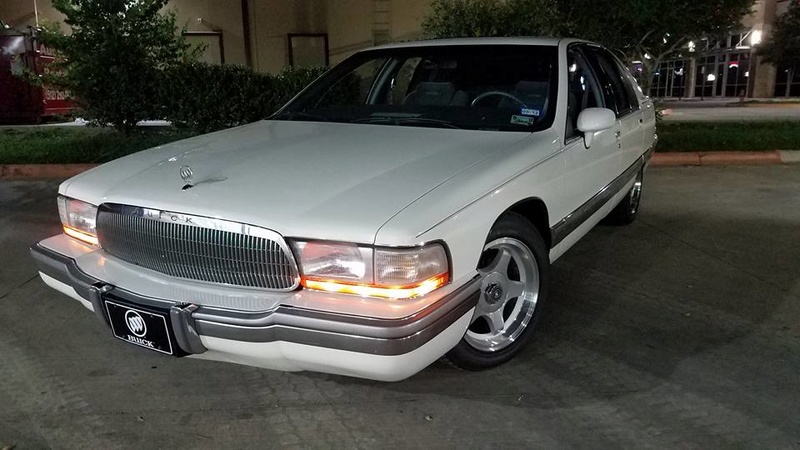

    9/6/17 - New bodyside trim for the Roadmaster Sedan. ES1382402-S Body Trim Molding. This stuff is great! Perfect size, cuts easy and not heavy like the stock trim was.
    9/7/17 - First daytime views with black-painted bumper and bodyside trim done. Car looks 1000-percent better! Also removed the dealer emblem from the trunk lid, and the stickers from the front and rear windows. Still need to compound and wax the car, but MAN it's looking so much better!! Can't wait to see it waxed.
