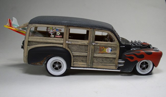

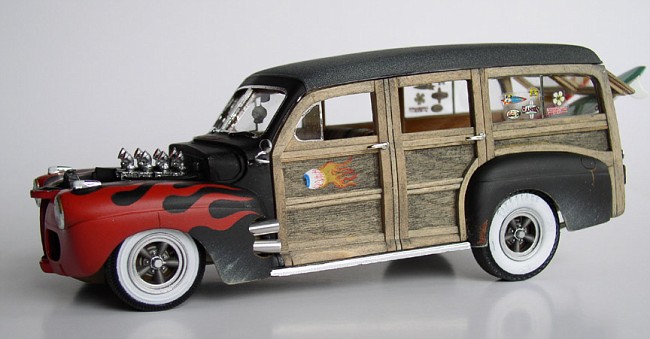

    I have been a model car builder since 1968. Starting in 1986 however, I began a line of woody models with the plan to build one example of every Ford woody in 1:25th scale. To date I have a 1928, 30, 32, 36, 38, 40, 41, 48, and 49 either done or nearly done. Some are spread to the winds, most were constructed prior to the advent of the digital photo storage system so it will take time to post pictures of them all. But... here is the first!
    The 1941 Wagon began as an article I wrote for Model Cars Magazine back in 1999 explaining how to build a real wood woody using the then new AMT model kit as a basis. All the plastic cast wood has been replaced with real model rail road basswood strip including the roof slats. The bits never got finished initially because they were only for explanation of the process for the article, so in 2005 I finally finished the model kit and built what I call "Driftwood". A semi drag, semi surf/rat rod along the lines of the '33 wagon featured in the movie "That Darned Cat".
    All the wood you see in this build is real wood.... albit slightly weathered.
    Not all the Woodies I build are like this. Most have shiny coats of paint/varnish, but all are built in very different ways and all to date use real wood for the box.
    Unclear here is the engine, but what is installed is a late 50's Desoto Hemi running eight single barrel carbs.
    The model currently resides in the collection of Virgil 'Dr. Cranky' SuÄrez, a noted author and model car builder.
    And an illustration of the model done in '02 or '03 which inspired me to build a model of it.

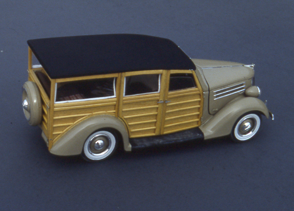

    Anyway, here is the 1936 Ford wagon built in 1985. It was also my very first all-wood woodie.
    These pictures are scanned slides. No interior photos exist sadly. I have a few black&white slides in storage taken during construction. Might try to find those later. So the pictures were taken on the hood of my '69 Mustang in the bright sunlight with an old SLR with a set of Macro lenses. Which meant that I can only get so close to the subject due to the tiny focal length.
    After these were shot I cleaned up the kit rear bumper and had it re-chromed and mounted. The kit part had bumper guards and most of you wagon guys know... you can't have guards if the tailgate is to fully open... So currently the car has it's rear bumper proudly displayed sans guards.
    This car was my third build to feature working lights. Head lights, taillight and dash lights all glow when the car is placed on it's display stand. There are small contacts in the rear tires which close the circuit when placed on the like-contacts on the stand. I do this when there is no room for batteries in the vehicle.
    The model is based on AMT's 1936 coupe kit built and displayed as a 3 to 5 year old car. So the running boards feature some dirt and the chassis is lightly weathered and the exhaust has some rust.
    Chassis, fenders, cowel and running gear are straight out of the box with addition of brake rods, fuel line and basic engine wiring. All the side window glass on the 1:1 car are canvas and plastic curtains which snap into place. I wanted my car to look realistic so I added same with sandwich wrap and paper curtains. The rear panel is actually folded and stored under the roof just as it would on the real car so I could open the tailgate. I wish you could see the roof slats... but the roof is built up with ribs and slats covered with tissue paper and model aircraft dope.
    All four doors, tailgate and hood open with home made hinges, with nothing but friction holding them closed unfortunately. I experimented with latches later.
    The car is currently residing in the Salt Lake City, Utah Model Car Museum. Been there for more than 25 years now... I think.

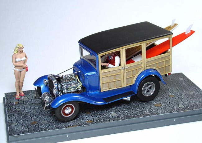

    About a year ago I built another woodie, making it the most recent. But instead of fully detailing the chassis I went another route and built one from this old magazine.
    Incidentally, yesterday I said it was a '30.... well, now that I look again it's actually a '31. (oops)
    Don Emmons is still around and I met him at a model car show a while back. His articles always inspired me and this article about building a "Tooling Woodie" got me going. I won't go into the full construction thing because that was posted on Model Cars Mag forum and if anyone is interested, click on the link.
    Here are the wood panels being constructed into a box. The sides start out as thin model aircraft plywood with various sizes of model railroad basswood attached using 5 min., epoxy one piece at a time.
    The roof is built up same as the original 1:1 car with cross ribs and wood slats, incidentally also made with basswood. That means the 1:1 car utilized Basswood for the slats... check it out!
    The chassis is a scratchbuilt brass rod and plate space frame. No great tricks. The motor an unmodified 'padlock' style Kemtron.
    The car was not fast but fairly easy to drive around the track.
    The finished roof was fiberglass instead of just tissue and dope this time with the plan to go for greater strength. Not to mention a smoother look.
    The surf boards are nine foot vintage style long boards that I carved from balsa with mahogany spars. They were coated with fiberglass resin and painted.
    The whole assembly also has a nice display stand and now resides in the collection of a noted East Coast Architect and slot car nut.

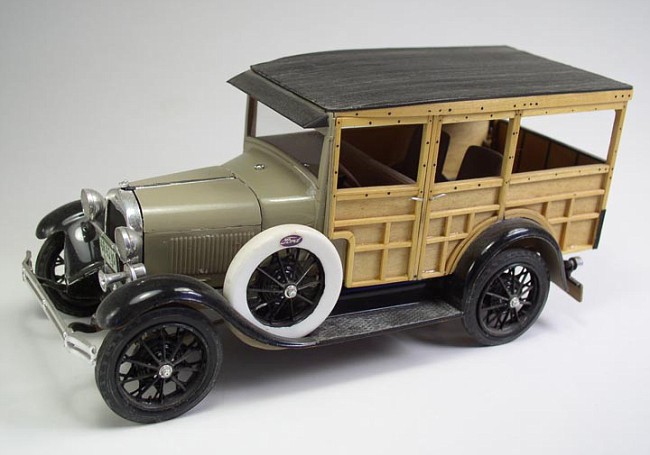

    The first and the last Ford woodie!
    Today I will post a model of what was Henry's first woodie station wagon.
    Up to 1928 prior to the introduction of the Model A, all wagon models were known as "Depoe Hacks", i.e. a commercial transport vehicle employed by hotels to move customers to and from the local train station. That is because trains back in the turn of the century were noisy affairs with soot, smells and busy activity. So proper Hotels were usually a distance away so the guests could enjoy a quiet rest.
    At any rate... early station wagons were mostly hand built all over the country by various artisans who also constructed.... furniture! Bare chassis were delivered by train to the furniture builder and bodies were constructed and sold by the individual builders. Henry felt he could do a better more consistent job, so starting in 1928 with the intro of the Model A, Ford also released the first Station Wagon! (who coined the name is unknown, but 1928 marks the first advertisment by Ford where the name is in print) All wagon bodies were built, starting in 1928 at Iron Mountain Michigan using nothing but Ford grown and harvested lumber. This would be the standard practice for the next 20 years and Henry could maintain supply and quality control.
    You see, prior to 1928 All the Ford cars utilized quite a bit of wood in the body and roof bow construction. Henry had purchased huge tracks of land and established the Iron Mountain facility years previous in order to control supply costs and maintain quality control. As Ford slowly weeded out wood as a structural component in body construction the need arose to keep the industry employed during the mid 20's. So... it was a natural fit.
    The last Ford automobile to have any wood used structurally was 1948.
    The last Ford wagon to have any wood on the outside was 1951 and then it was only decoration.
    The last structural woodie built by a major manufacturer was a 1953 Buick Roadmaster Estate Wagon.
    I built this car as a replica of that first heady year based on a Revell model kit. The original kit was a Pickup truck so everything from the firewall back was left off and like the 1936 wagon... scratchbuilt from basswood and plywood right up to the wood strip and tissue paper'n dope roof.
    Like the '36 all doors and hood open with nothing but friction to keep them latched. This car was built in about 1987 and was my second woodie. But no working lights included with this one.... :)
    Even the tailgate drops on this one and the restraining straps are scale chain wrapped, just like the 1:1 car! (I used tissue paper where the real wagon used leather). To complete the Depoehack/Stationwagon look, I also originally built a nice steamer truck for the back... but unfortunately when I sent this car to a contest.... it came back with a broken front axle and lost steamer truck. (Damn baggage handlers!)
    Next post I will show the "Last true Ford built all wood woodie, the 1948"!
