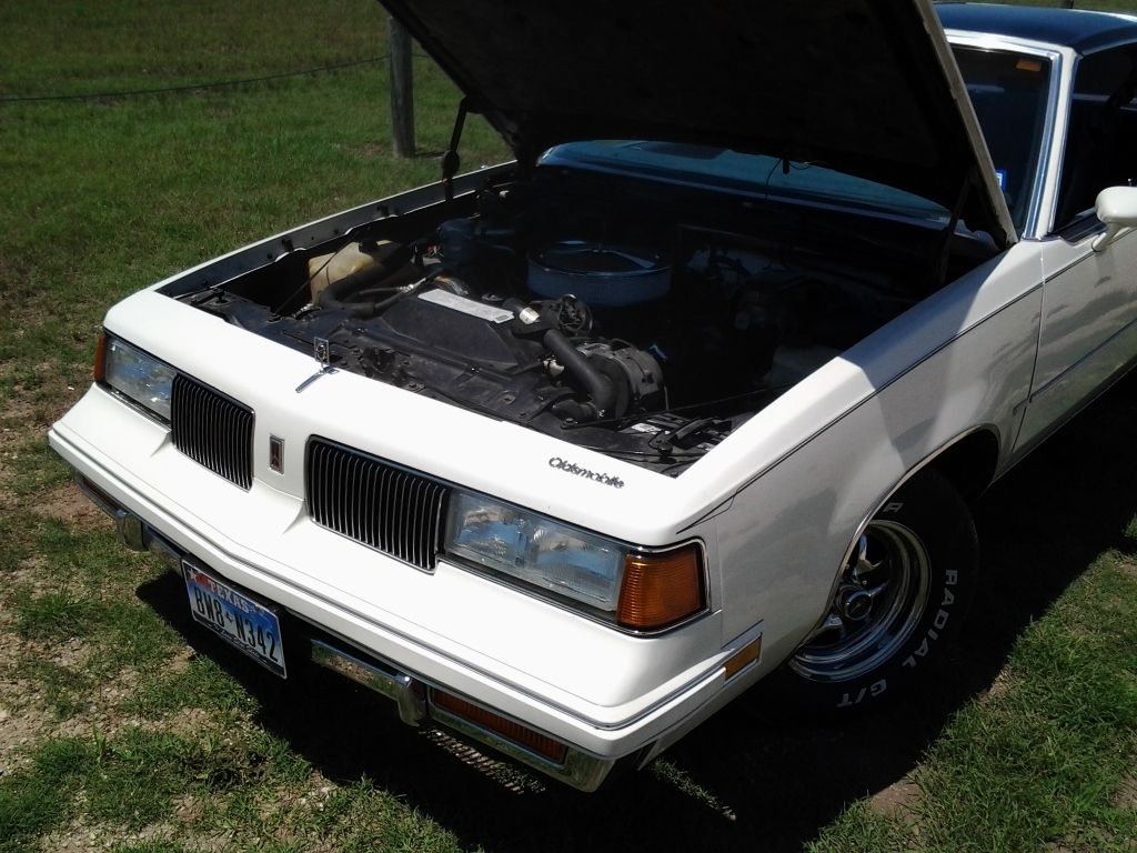

    Just had a HOT (96-degrees here today) but happy drive in my Cutlass! IT IS ALIVE again....only took....well...a year....
    Pics below....please understand I've not so much as wiped off the air cleaner yet. Will be cleaning and detailing under the hood this weekend...but after a year, figured it was time for pics!

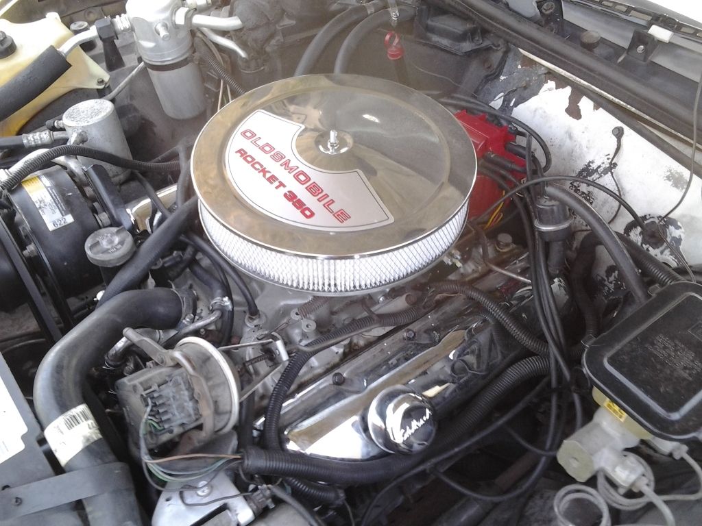

    So here we go. Neil gave me a good walk-through of what he did. ECM and wiring are in a pile in the trunk. You can SEE the engine under the hood now!
    It runs, idles and drives GREAT. Much more power than the 307. Still not a monster, but the single exhaust and rear gearing suck. Will fix those soon!
    He showed me the old distributor...and it was shot. Weights stuck. My fault, tried to go with used parts. New distritutor is in. Timing is set at 12 and advances to around 28. No ping, no hesitation. Starts easy, even hot.

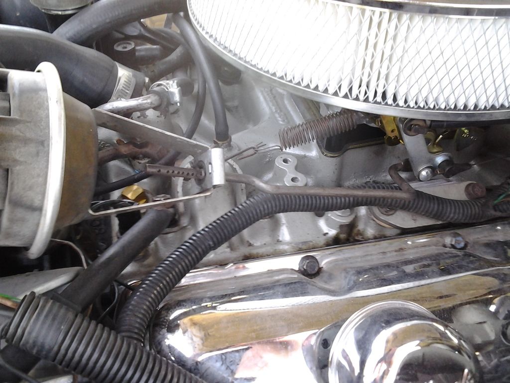

    Cruise control arm modded and and mounted to new carb. Wiring modded to work without the computer. Works like new. Set cruise at 70mph....holds fine!

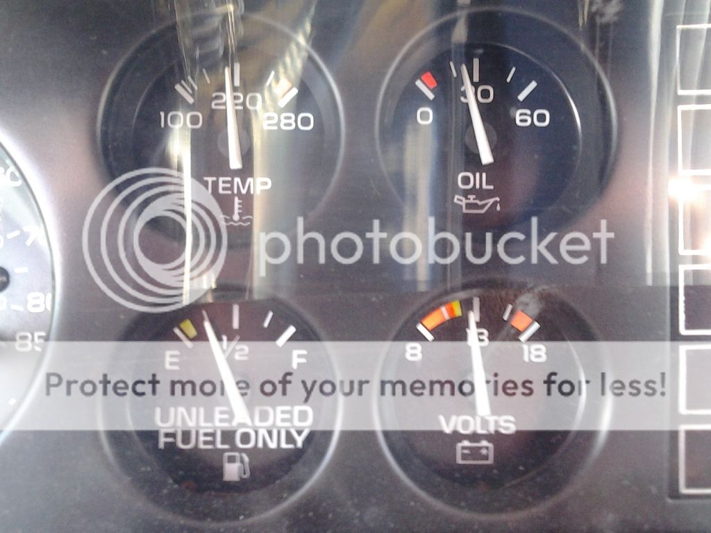

    Only a couple of outstanding issues (beyond how dirty the engine bay still is). I still have to order a lockup kit for the 200R4 transmission, so driving home I had to keep it in 3rd gear, and the other issue is it ran a bit hot going down the road. Averaged 220-240, and I know I have a 195 thermostat in it, and it has a new water pump. With the 307 it never went up to even halfway on the gauge. Was too hot to check the coolant when I got home. I hope it's just not topped off. Will check tonight.

    On the road again!

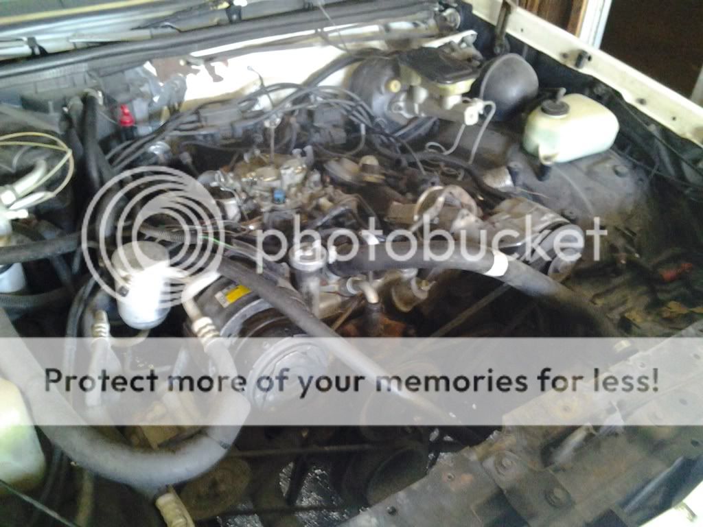

    Nasty old 307
    Plan A. 350 installed....trying to keep the 307's carburetor, ECM computer, wiring, hoses and smog stuff. Ran like garbage, could not see the engine for all the hoses and crap. FAIL!!! Yanked it all off.
    Plan B. 1971 Rocket 350 installed, NO computer/hose mess anymore, new Edelbrock carb and vaccum distributor. You can now SEE the new engine!

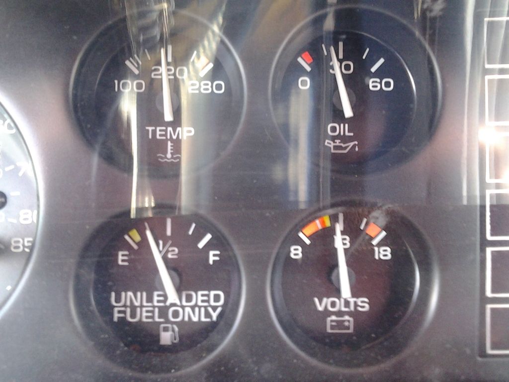

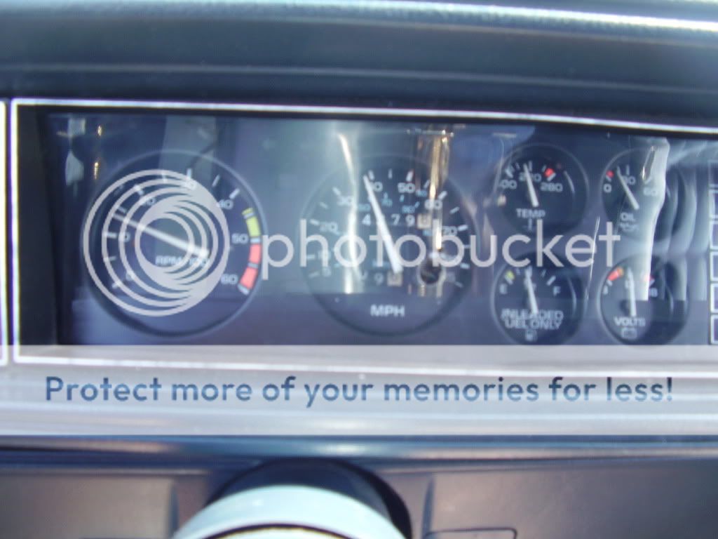

    Old '88 307 at idle, in gear. No oil pressure
    New 71 350, Oil pressure at idle in gear
    Old 88 307 oil pressure while driving
    New 71 350, Oil pressure while driving :D

    That said, the idle is still a little low...feels almost like it's going to stall when stopped in traffic waiting to get out after the show. Never did stall, but felt close. Also, I checked the coolant and it wasn't low. Tonight it never got up above about 210 on the gauge....but it is nighttime.

    What temp sending unit is being used? Perhaps the one from the 307 is different than the 403?
    Glad you are happy. Bump the idle up a notch and have a great weekend with the car and family.

    I used the temp sensor from the 307. Just moved it over to the new 350. Maybe there is still some air in the system...?

    I don't know about the air in the system. I've not had that problem. Do you have an extra temp gauge laying around you could hook up under the hood just to see if the gauge in the car is reading accurate?

    No, but that's not a bad idea. It never got close to overheating today, but seeing it over the halfway mark on the gauge was new. It never got that high with the 307....but I guess the 350 may run hotter.

    That 350 will run hotter than the 307 and if it was a 455 it would run even hotter.

    Took the car to the Cedar Park cruise-in tonight (pics in the Events section) and the gauge never got hot, stayed around 180-205.....good deal! Guess it just has some air in the system that had to work itself out. Will check the level tomorrow.
