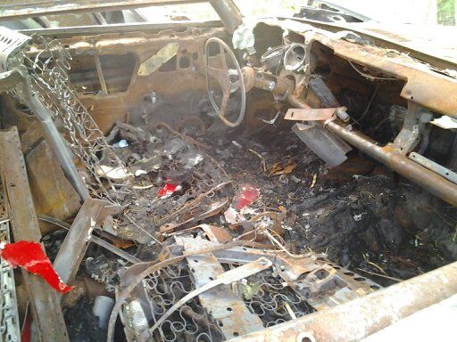

    Oh and posted pics of the burned 71 Cutlass up a few posts back. SAD!

    Any word on the culprits that did your buddies car in?

    No news on the 71 Cutlass fire. Neil has the car now and is going to part it out.
