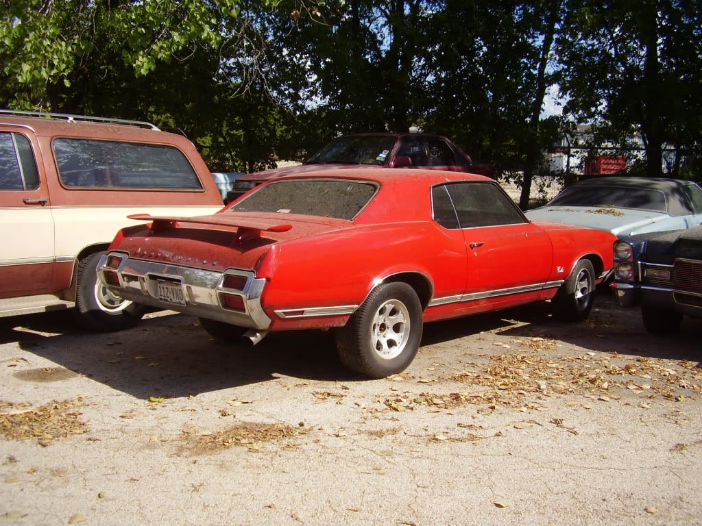

    This was the donor car for my "new" '71 350, and belongs to a local club member named Terrence.
    After all the work put in to it (a totally BUILT 403 engine, something like 400hp), it was home about 2 days, and after a day of fine tuning, it was put away for the night and Terrence took his wife to dinner.
    Someone broke into his house, got the keys took the car for a joy ride, parked it in a field and burnt it to the ground afterwards. :cussing:
    The new engine drivetrain survived and is now looking for a new home in another Cutlass or GM product. I got a call from Neill, the guy that built the new 403 put the engine in the '71, and he said Terrence is just beside himself.
    Really Sad Stuff!
    -Mike
