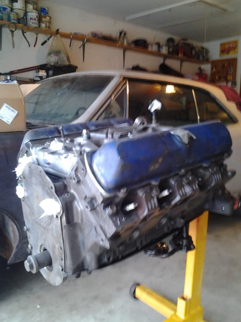

    This weekend I'm planning to yank that 307 like a rotten tooth! Going to pressure wash the engine compartment and re-paint the firewall and some other stuff before dropping in the "new" '71 Olds 350.
    As for that 350, been getting it ready to go as well. Pressure washed it really well, and then pulled the intake and oil pan to give it a look-see.
    The inside of the motor looks GREAT! :cheers: No sludge in the oil pan, valley between the heads was clean, no gunk in the oil pickup screen, and I can see it has a double-roller timing chain. Crank and cam are clean, looks like it was a good rebuild and can't wait to hear it run in my Cutlass.

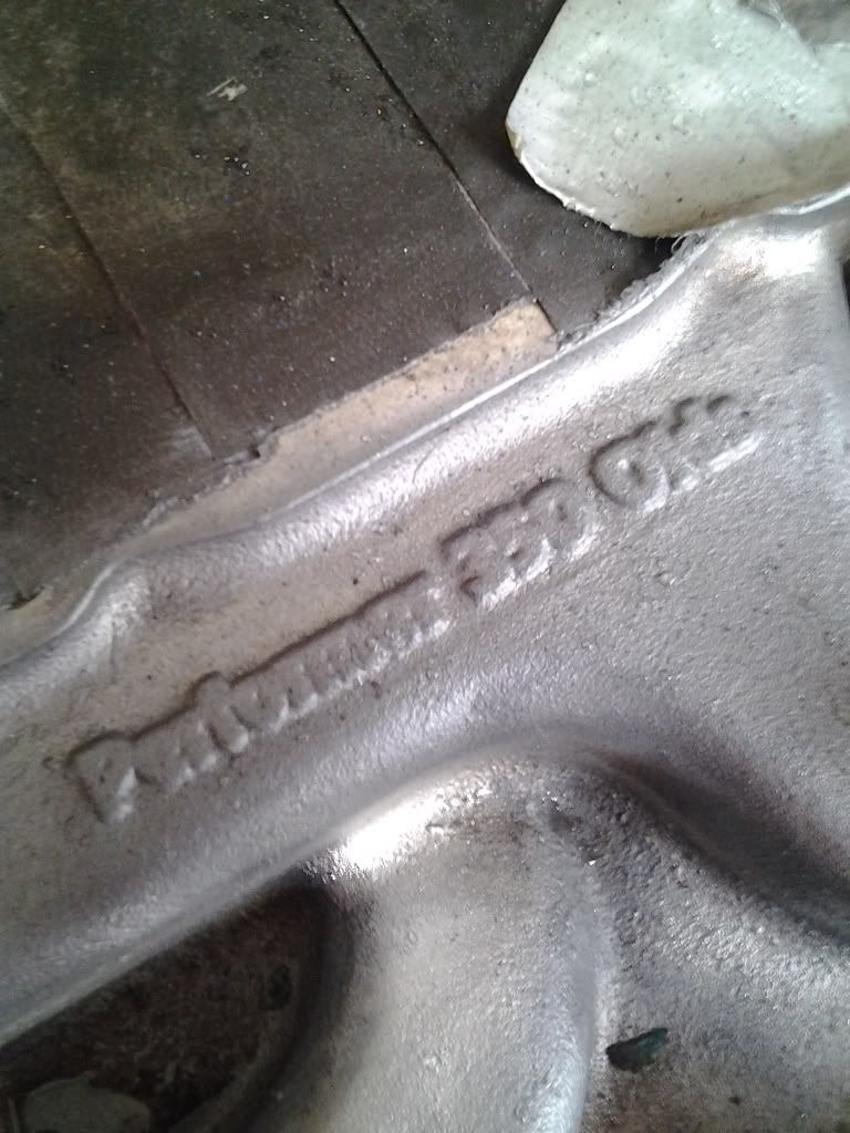

    Here's some pics I took this morning. I re-bolted the intake on, put some junk plugs and some salvage yard 307 valve covers on it, getting it ready to paint the block. I'm in the middle of sanding down the oil pan. Planning to put a coat of paint on the oil pan, then bolt it on and paint the entire engine, which will be a 2nd coat on the pan.
    Engine is going to be semi-gloss black...I could not find the correct gold and do not want it to look like a bright gold nugget under there....which is the only Gold engine color the local parts stores have, so black it will be. I already have chrome valve covers for it, and will use the factory air cleaner with a chrome lid and Rocket 350 decal. :)
    Going to take the Edelbrock intake off again after painting the engine black, and paint it with high-heat cast-coat aluminum paint. I only bolted it back in for now to keep overspray paint from getting in the motor.
    I've already painted the front brackets I nabbed black, and the exhaust manifolds are now black as well. I'm using a 1979 Trans Am 403 exhaust manifold on the driver's side to get rid of the heat riser, along with the 403 crossover pipe. On the passenger side I'm using an early 80's cast-iron 307 manifold. Have to use that to retain the single 02 sensor, it has the bung in it. It honestly looks as large as the 403 manifold, and besides, after emissions next year I many just yank it all for headers and duals. This is just to get the engine up and going in place of the factory 307.

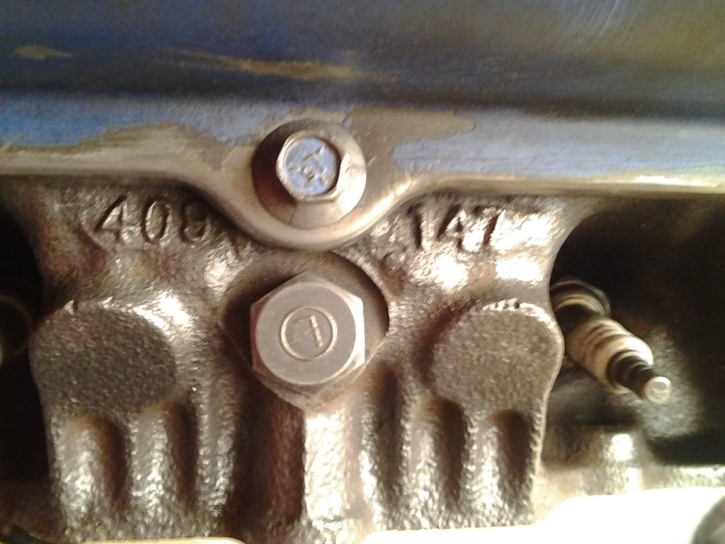

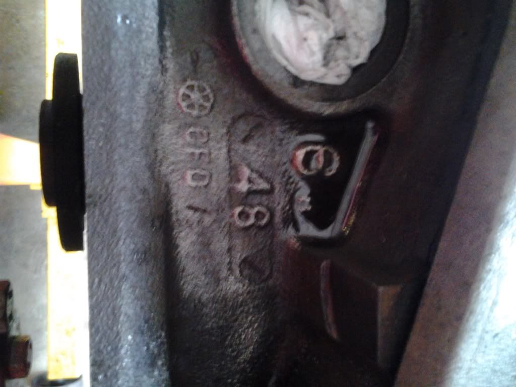

    Here's some pre-paint pics of the 1971 "Rocket" 350. I also took some pics of the numbers in case anyone wants to tell me exactly what I have. I do know it has #7 heads, which are supposed to be among the better ones to have on these, from what I've read.
    De-greased, pressure washed and waiting for it's first coat of semi-gloss balck!
    Edelbrock intake. Will be painting it cast-coat aluminum color.
    #7 heads, and some other numbers on the heads:
    Numbers on back of the block by the distributor hole
    Numbers on the front of the block
    Will post updated pics as soon as the motor is painted. Coming along!

    Hmmmm.. According to this link the block is from a 68-70 model, even though it came out of a 71 Cutlass. ID code 2, '68-'70, 350, Casting # 395558 - http://www.442.com/oldsfaq/ofblk.htm
    Looking up heads... http://www.442.com/oldsfaq/ofhed.htm#Heads
    #7 model 409147, 64cc Combustion Camber, 1.880, 1.995 Intake Valve, 1.567, 1.624 Exhaust Valve
    All 1971 350's use #7 heads. Valve springs were different depending on application. Rotator style spring retainers were used on ONLY the exhaust springs. Induction hardened valve seats for use with unleaded fuel.
    Sounds like I'll have a nice setup!
