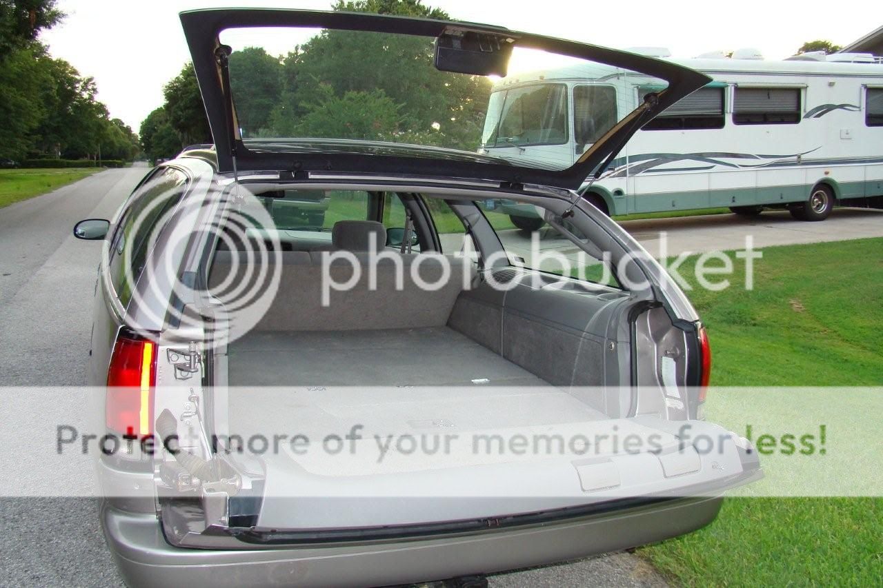

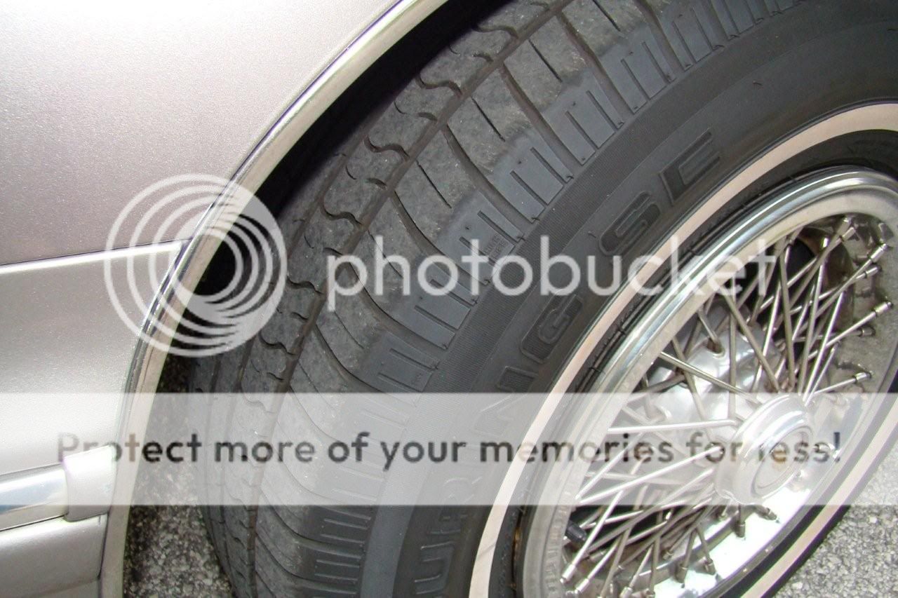

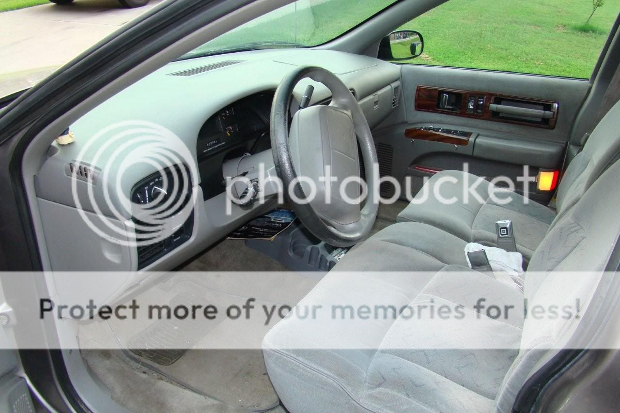

  13. Crownvic
    Crownvic New Member
    Jun 12, 2010
    120
    Vermont

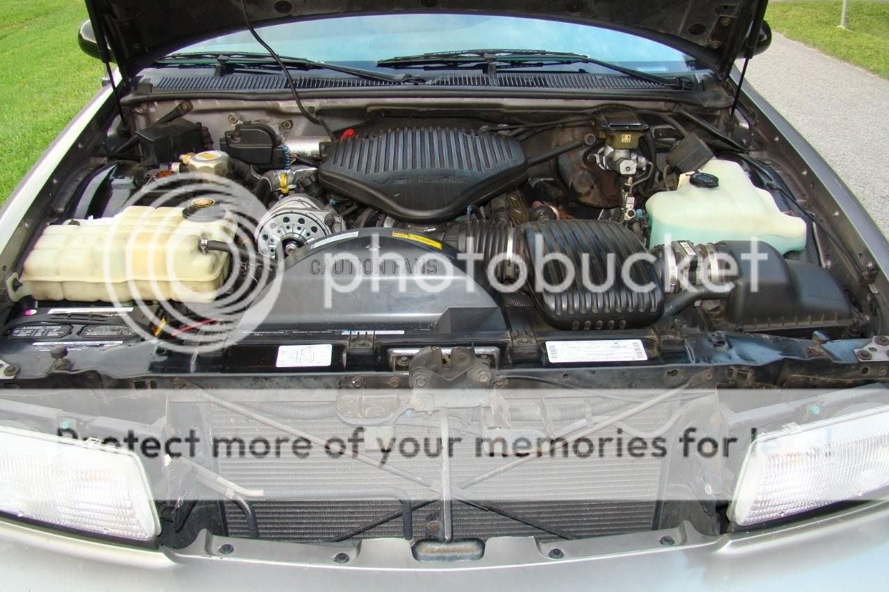

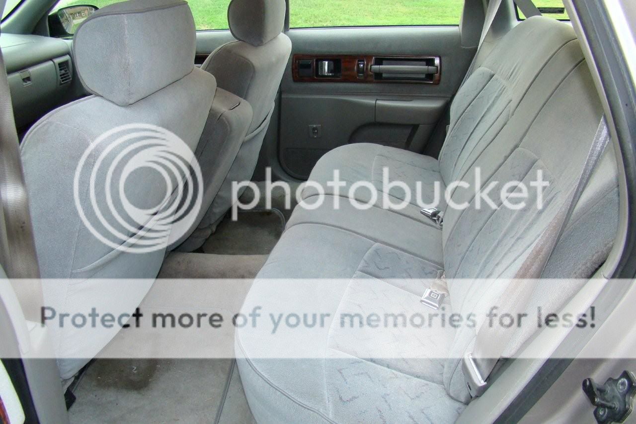

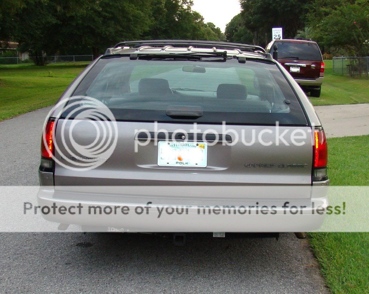

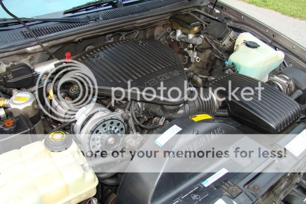

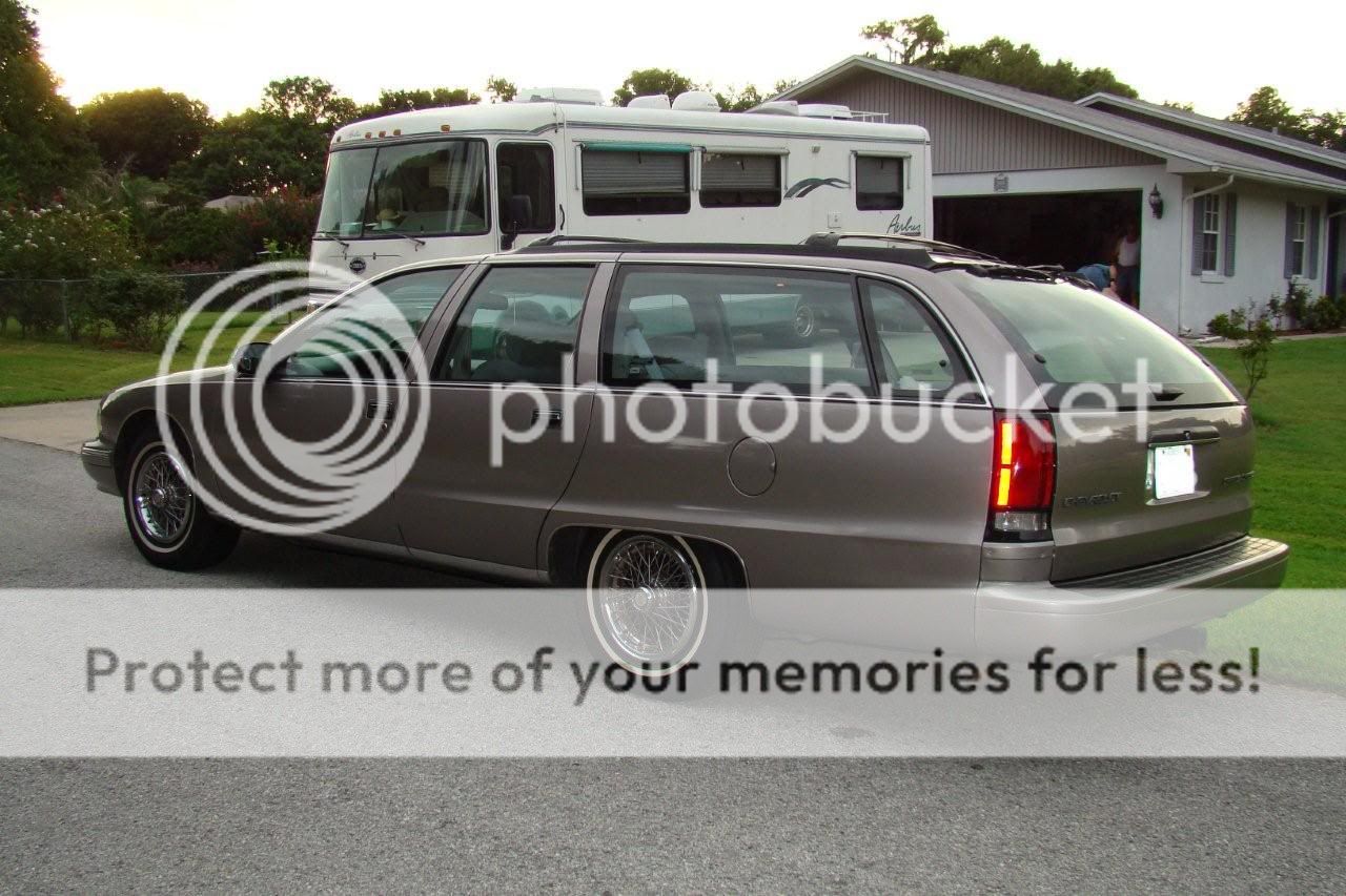

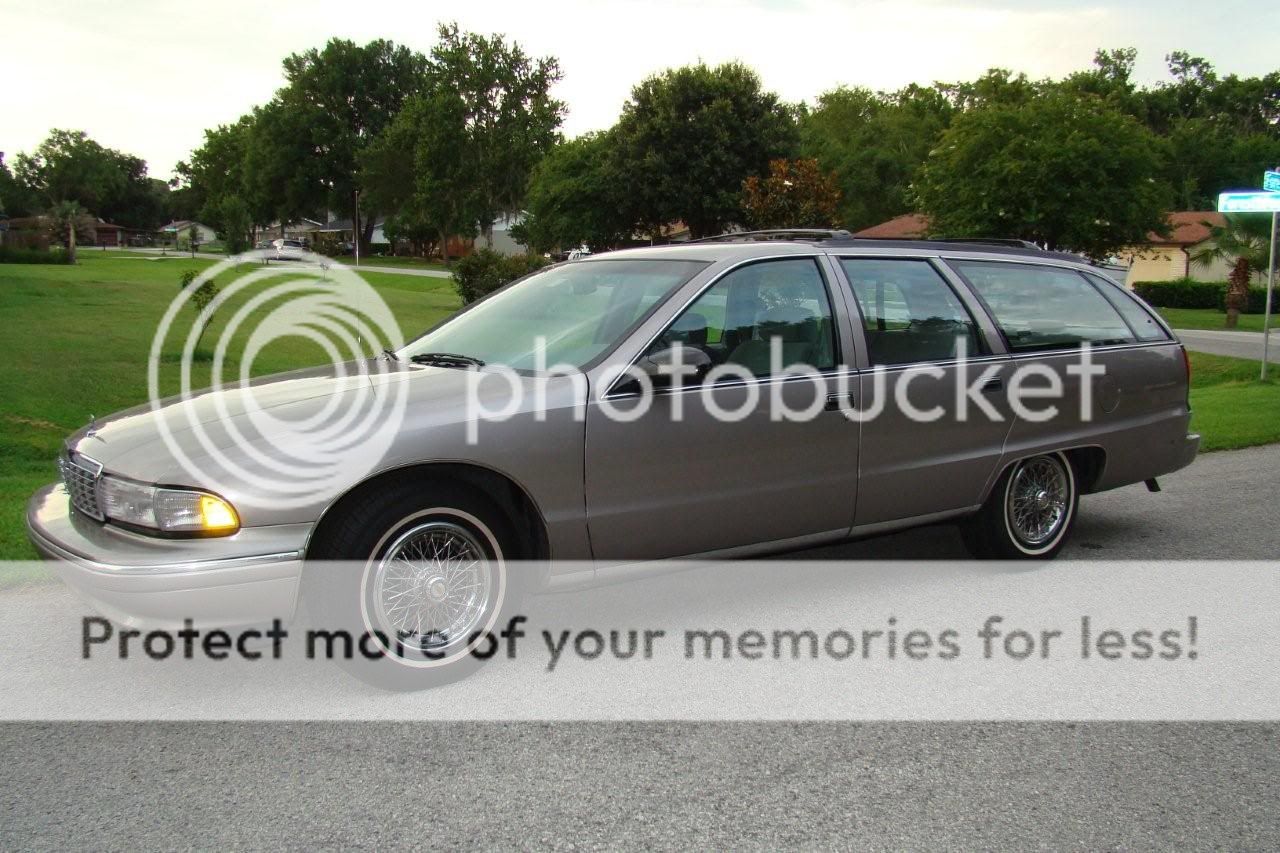

    Pictures of car for sale
    Hi Guys,
    I got some extra pictures of the grey Caprice and it doesn't seem as picture perfect as first thought. Here they are, don't hesitate to make any criticism you can find.
    Thanks for taking a glance and giving me your impressions. The seller says it was not used for towing and that the paint is entirely all original. The chrome trim appears to be missing. It's engine makes a noise which he says is the air conditioning unit, and it is uninsured.
    Vic
