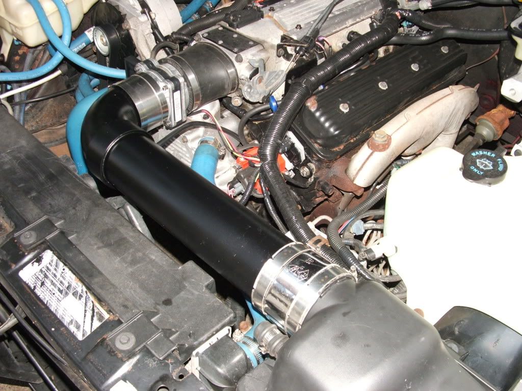

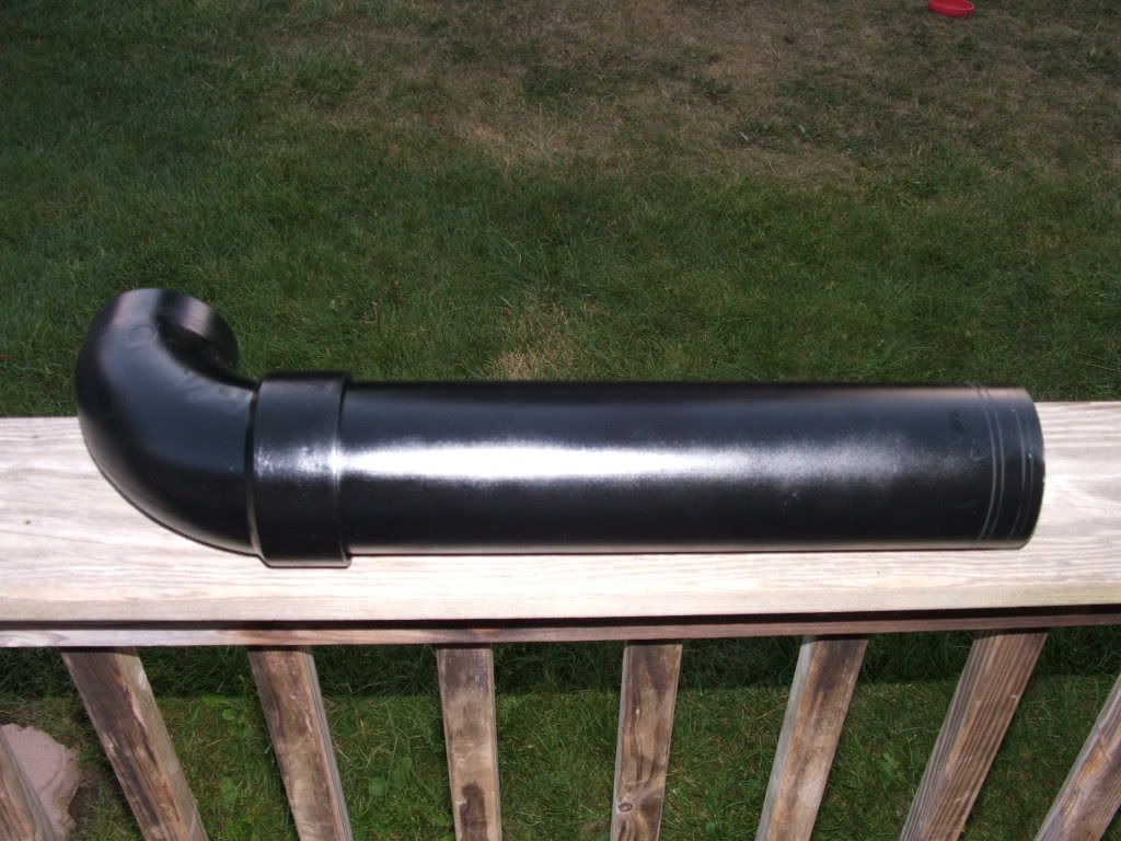

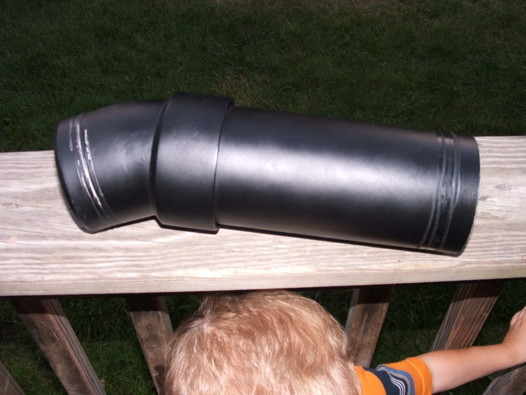

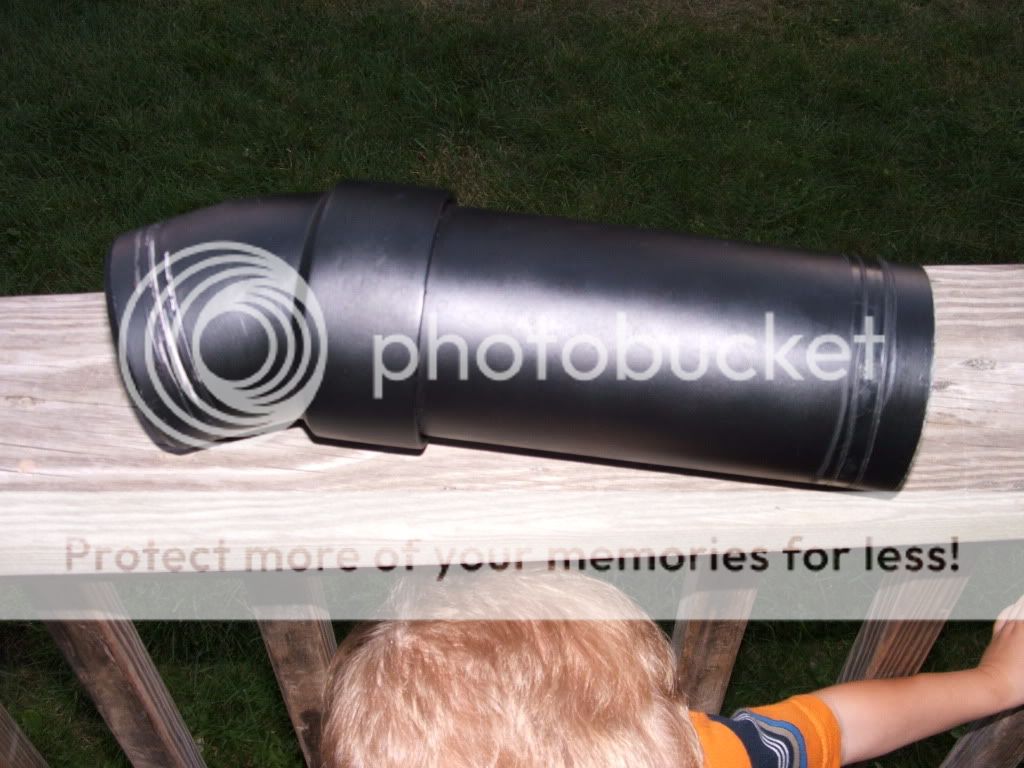

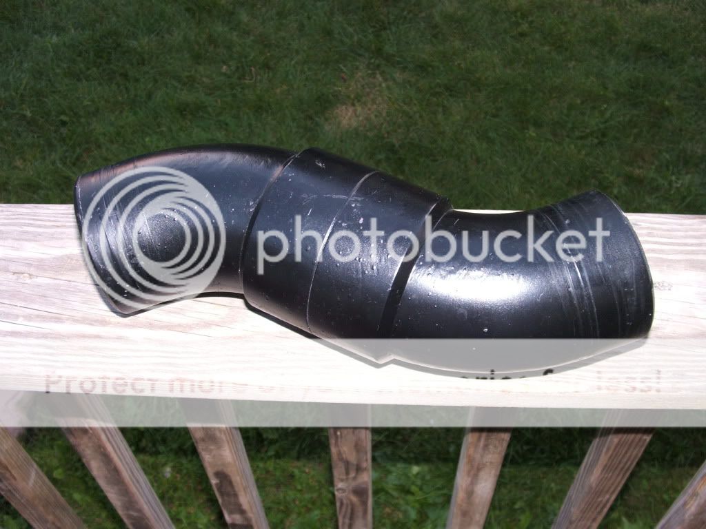

    I don't know how restrictive the stock intake plumbing is on the B body's, but I think most of us do this mod to clean up the engine compartment. I'm not a big fan of K&N filters, they are less restrictive, but at what price? You can see daylight when looking through them with out the oil on the filter media. Most guys will replace the "home plate" silencer with a hockey puck, and "first base" silencer with the K&N set up or a Home Depot or Lowe's sourced 3" pvc pipe, a few different elbows, and a rubber coupling. If using the stock air box "filter housing" most of us drill out or "swiss cheese" the bottom of the air box to allow more air to get to the filter. I think it's fun to figure out your own set up with the pvc. Here is some of the set ups I have played with.
