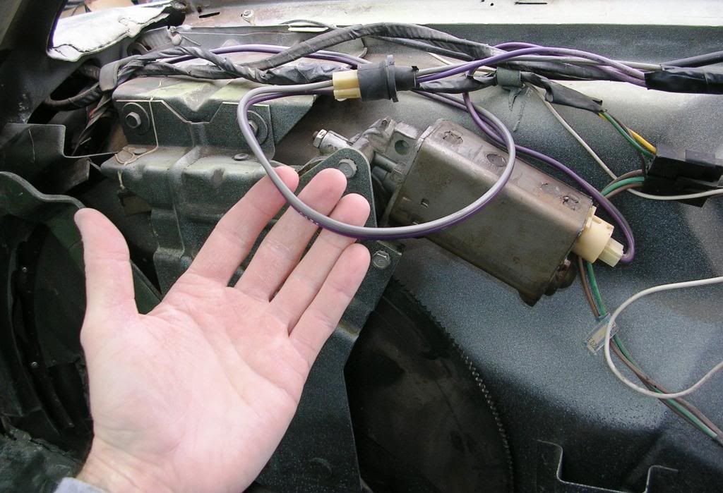

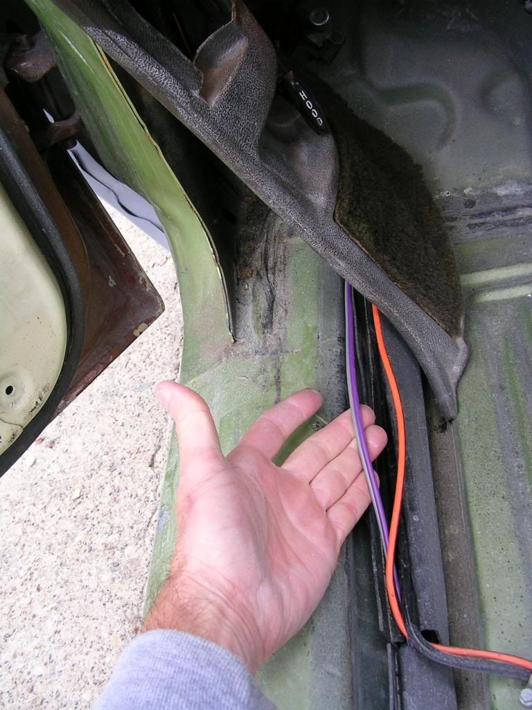

    Man, you are a hero and a half! Thank you for all the great photos. If I see what I think I'm seeing, the wiring does pass under the "Body by Fisher" plates on the driver's side of the car.
    Also, in the 12th and 13th photos down from the top, the wiring passes through this big black thing. (Stop me if I'm getting too technical!). Is that the connection between the front and rear wiring harnesses that the service manual refers to?
    But the other thing that puzzles me a bit is that, while the tailgate motor doesn't work, the rear window DOES work. Do the window and the gate get their power from that same pair of wires coming back from the front of the car? If so, then it suggests there is not a short along under the "Body by Fisher" plate as, if there was, the window wouldn't work, either.

    The first question: the wiring doesn't run under the "Body by Fisher" plates, they are encased in the hard black plastic sleeve the runs along in a recessed channel on the floor inside the car under the carpeting. This pic shows this best: (the kick panel is just laying there, not at all installed in place)
    _________________________________________
    That pic with the big black thing, is showing a plastic sleeve that holds the wiring as it runs under the seating and carpet. This sleeve protects the wiring from getting crushed.
    The pic is taken looking down at the area just from under the rear seat and down into the rear footwell, running along the threshold of the LH side.
    As the wires continue along the floor, it is encased in another black plastic protective sleeve.
    ________________________________________________
    The connection that joins the front and rear is, I believe, shown in this photo:
    I would give a good look at this connection shown in this pic: (this taped up connection is where the purple & grey wires branch out to make two pigtails, one that plugs into the motor, and one that plugs into the harness that goes back to the rear keyed switch.
    _________________________________________________
