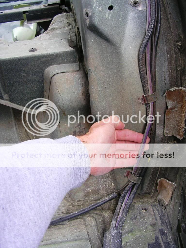

  15. wixom61
    wixom61 Well-Known Member
    Apr 21, 2009
    2,555
    19
    111
    Dallas
    Jaunty,

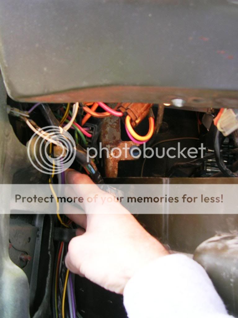

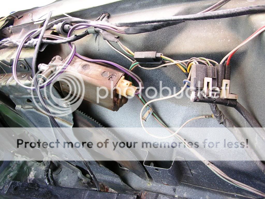

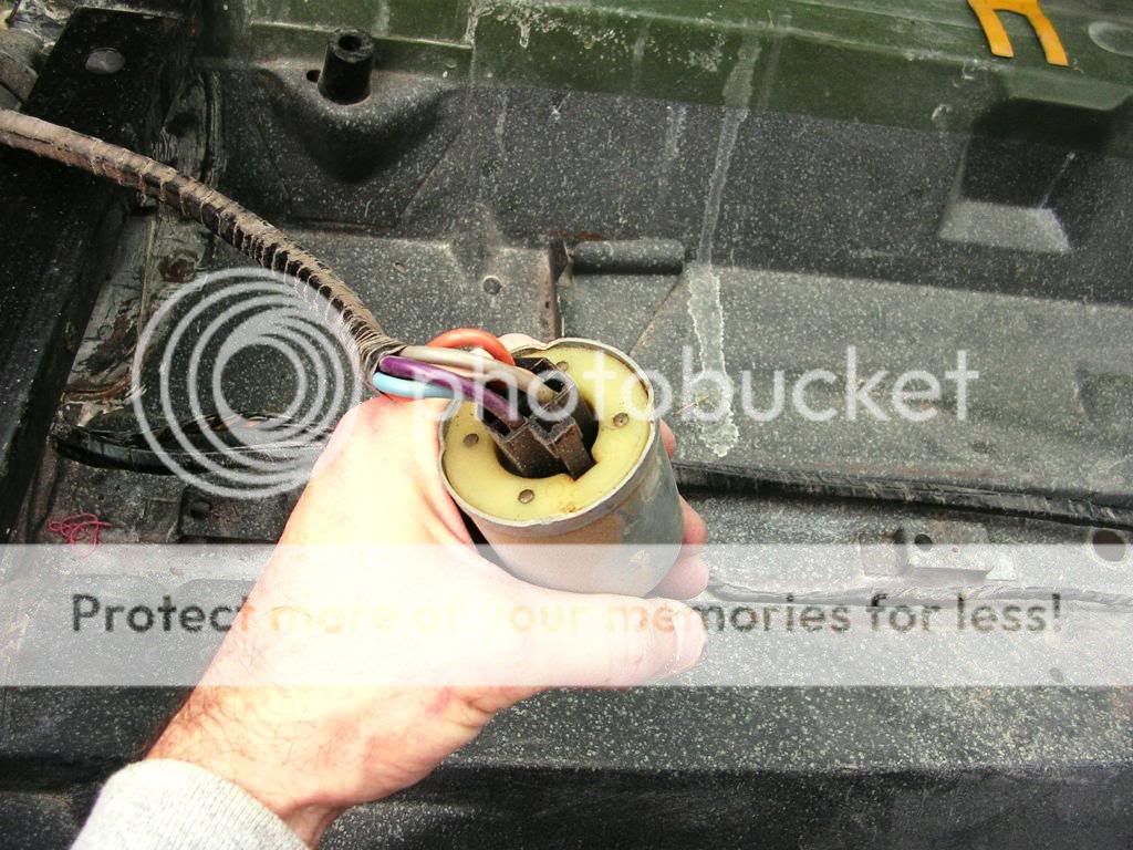

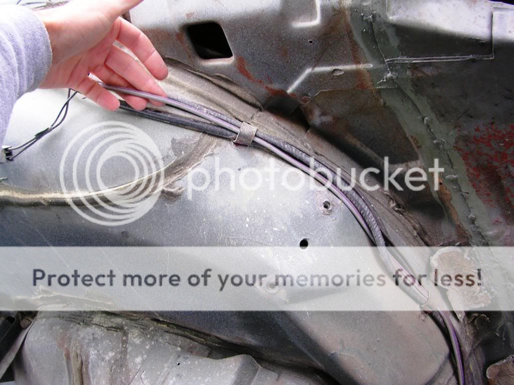

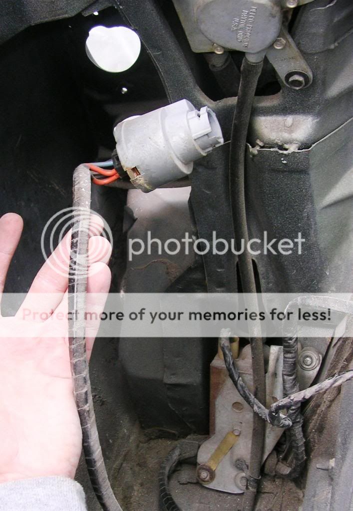

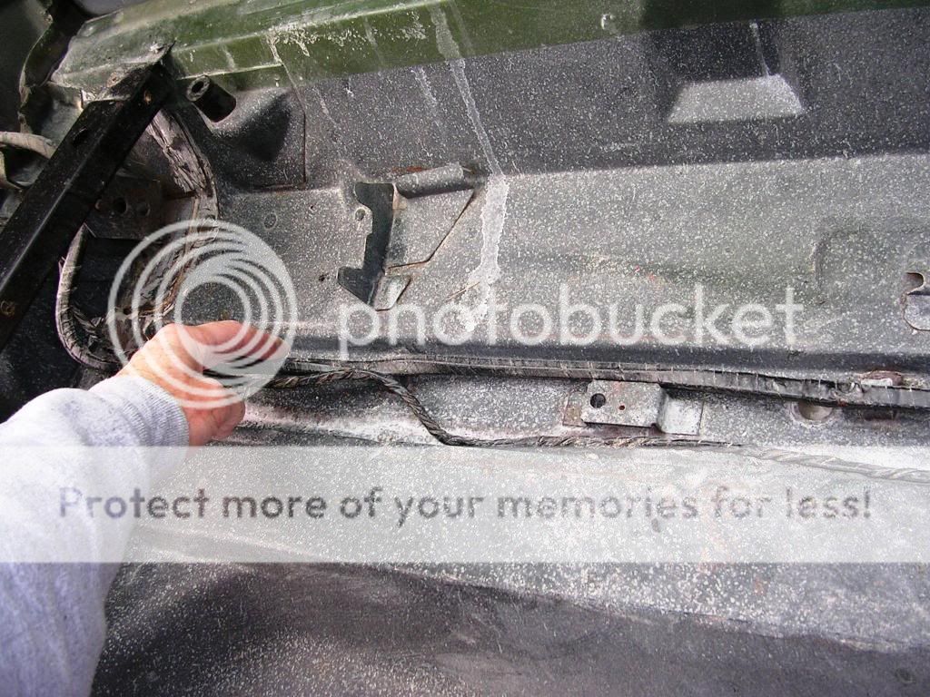

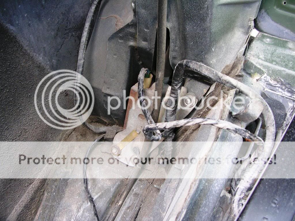

    Well, since I have been on a picture taking spree, I thought I would go ahead and take some of my tailgate motor wiring.
    These pictures start at the rear switch, and across to the motor regulator, and then head forward down across the floor and to the dash.
    This pic shows the RH key-operated control switch.
    These pics shows the wires plugged into the back of the switch. There are two orange wires that are the hot power wires, and a pair of wires for the tailgate (purple & grey), and a pair of wires for the window (baby blue & a pinkish beige).

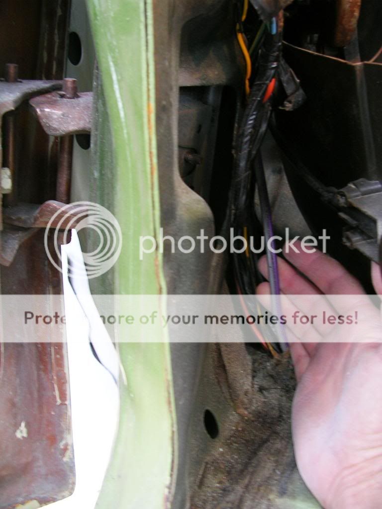

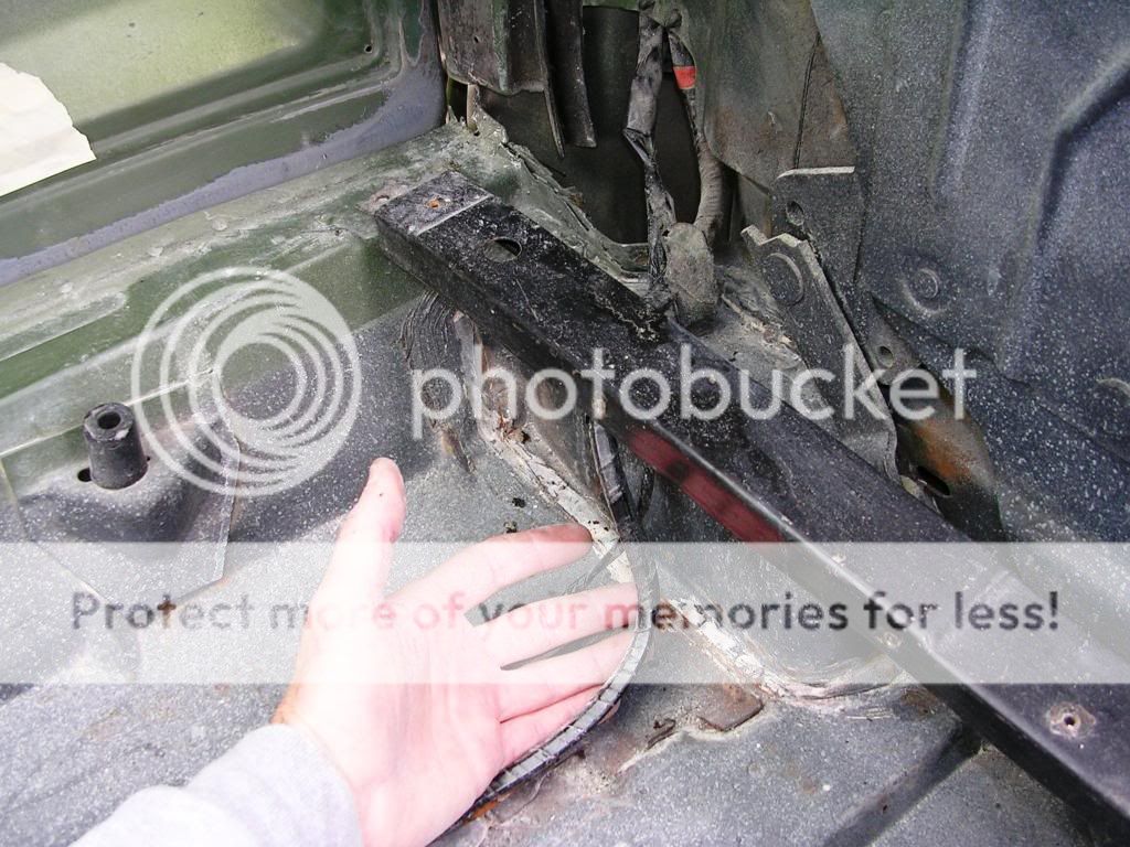

    The wires are wrapped and go down past the window motor, and then up to the recessed channel along the back cargo floor.
    This recessed channel is covered with a metal plate. This channel is also for the counterbalance torsion bar (removed for painting)...be careful with this torsion bar! Also, this area is notorious for holding water and rusting.

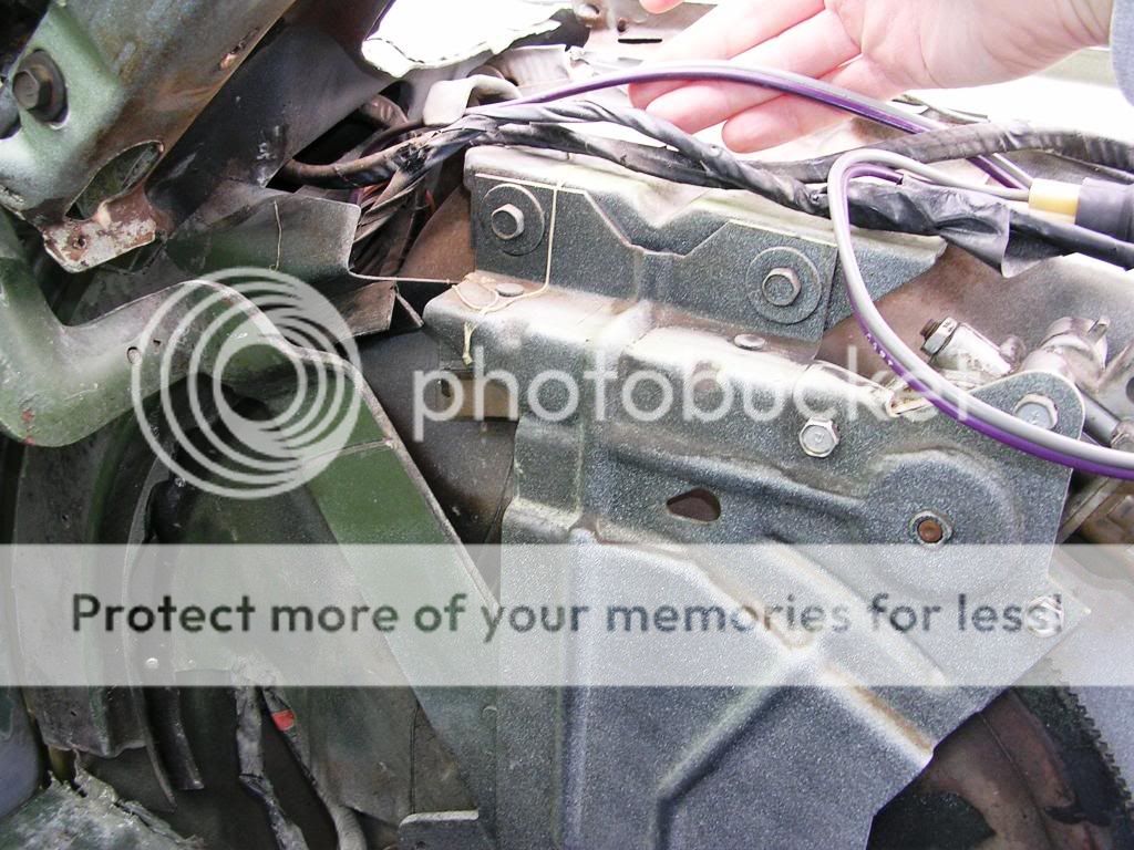

    These wires now head up to the tailgate motor...the purple & grey wires now are out of the bundle, and visible.

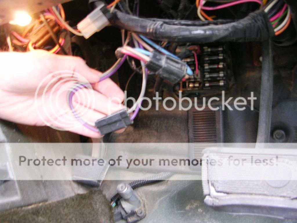

    This harness plug joins the key/switch lead to the part that goes to the motor and dash. [​IMG]

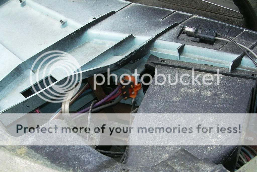

    This is where the wires go from two wires to four. Two pigtails branch out from the two wires coming from the dash. One plug goes to the motor, and the other goes to the key/switch.
    Focus on the purple & grey wires...all of those other wires are for lighting and fuel sender.
    This is the back of the dash switch...the red hot wire connects here.
    The wires from the very back of the car at the key/switch...the two orange and the baby blue & the beige, continue along the same path toward the dash, but they are wrapped in black tape from the factory.
    Jaunty, I hope this helps you out! :2_thumbs_up_-_anima
    If there is anything here you can't figure out what I am referring to (my explanations are clear as mud), feel free to ask.
