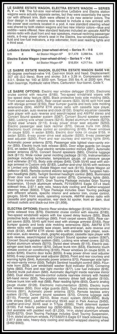

I've combined a few scans to create one big image. I also included the LeSabre options list, because I can't find the rear air deflector in the Electra option list. 5,191 and 5,901 are the production totals 1988 BUICK ESTATE WAGONS .

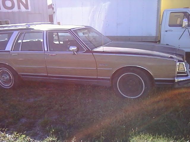

ok i took some pics after work but i couldn't get inside pics cause i had a brain fart and locked the keys in the car. but when i figure out how to get this slim jim to work on these doors i'll have interior pics for ya guys. now i remind you i only paid $400 for this car.
