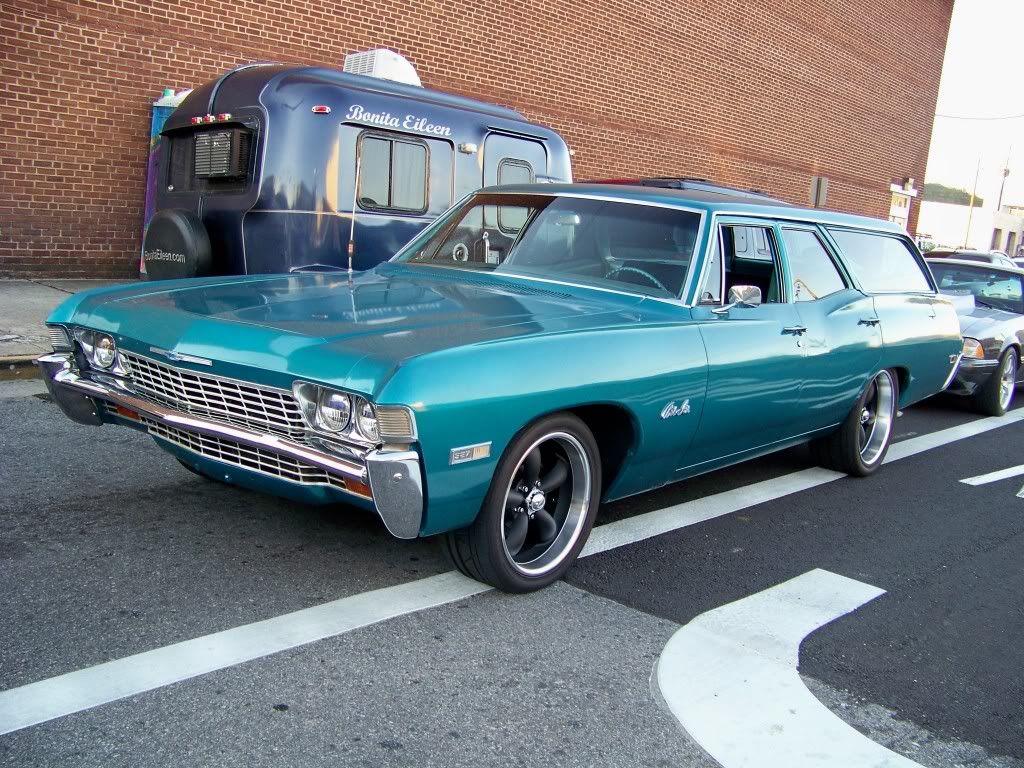

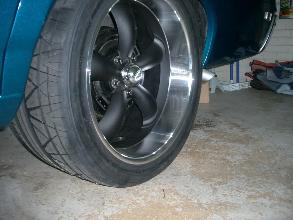

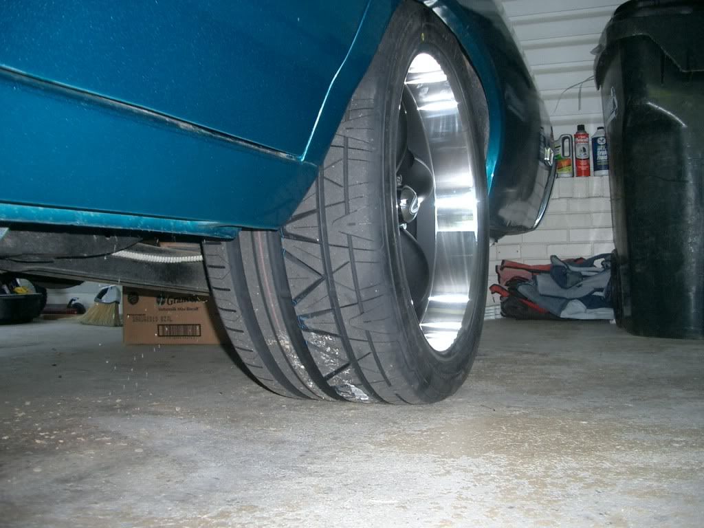

    Anyway, I sold the Buell and spent some of the money and bought Coy C5's and Nitto Invos. The current tires were 10 years old. Made sense to upgrade.
    20x10 5.5bspc in the rear with a 295/35/20 Nitto Invo.
    18x8 4.5bspc in the front with a 245/40/18 Nitto Invo.
    The rears fit but I do need to gain some clearance and control of the rear end. I ordered an adjustable panhard bar and will be centering the body on the frame to make sure the rear end is centered in the wheel well and frame.
    Front end was already high but with a slightly smaller tire overall diameter in the front the gap in the fender is quite unsightly.
    I will soon be ordering a drop spindle which may also advance my plans for disc brakes....I was gonna live with the drums since they seem to work just fine now.

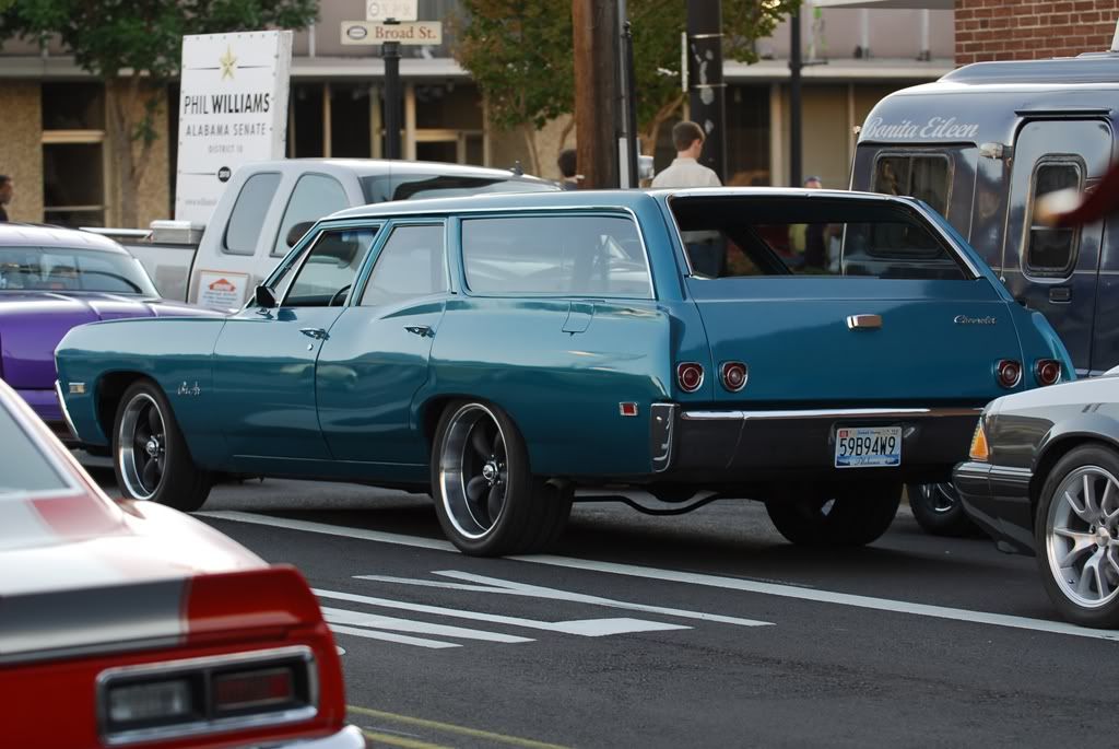

  2. Wicked
    Wicked Member
    Feb 14, 2010
    33
    13
    Pell City, AL
    And once I fix the ride height it should look like this...minus the drums I think.
