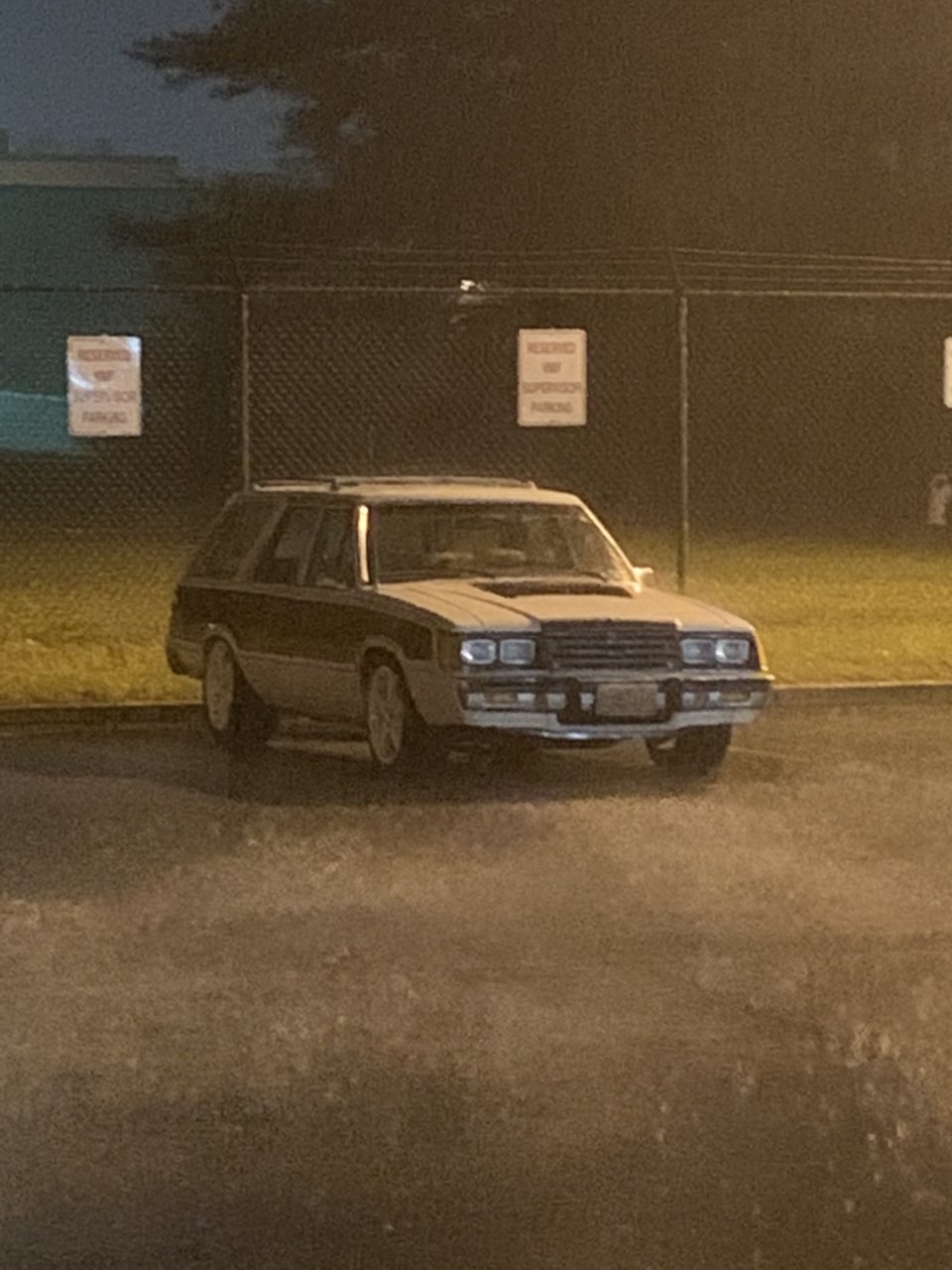

    Commuting in the Daddywagon lately. Just because.
    OrthmannJ and Grizz like this.
  4. Silvertwinkiehobo
    2,995
    Almost looks harmless in that shot.
