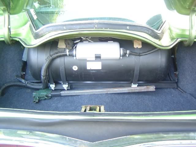

    There is an additional tank in the trunk for 27 gallons )which can be filled, due to a safety device, for only 80%. I will upload some photos later.
    In fact I can get rid of the original gastank and add another 20 gallon tank

    LPG-tank in the trunk:
