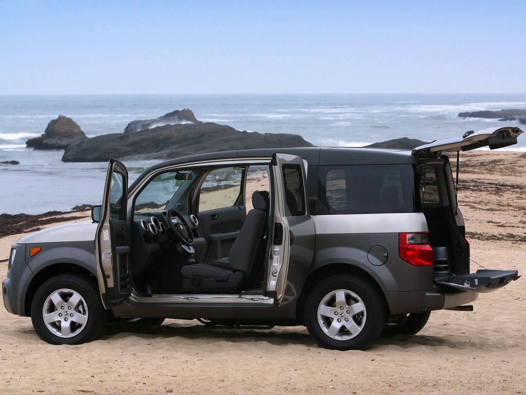

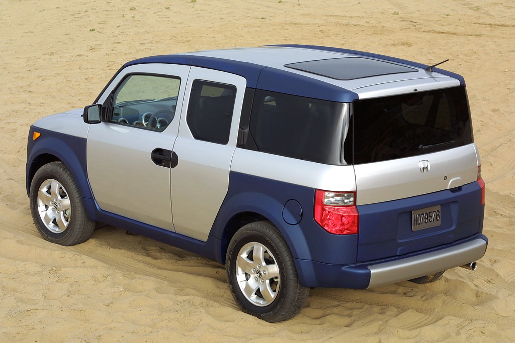

    Now I know what you meant. I've never seen any of these or even have heard of them, around here. I like them, though. I wouldn't mind having one, if they weren't so thirsty
    https://www.autoevolution.com/cars/honda-element-2003.html#agal_75

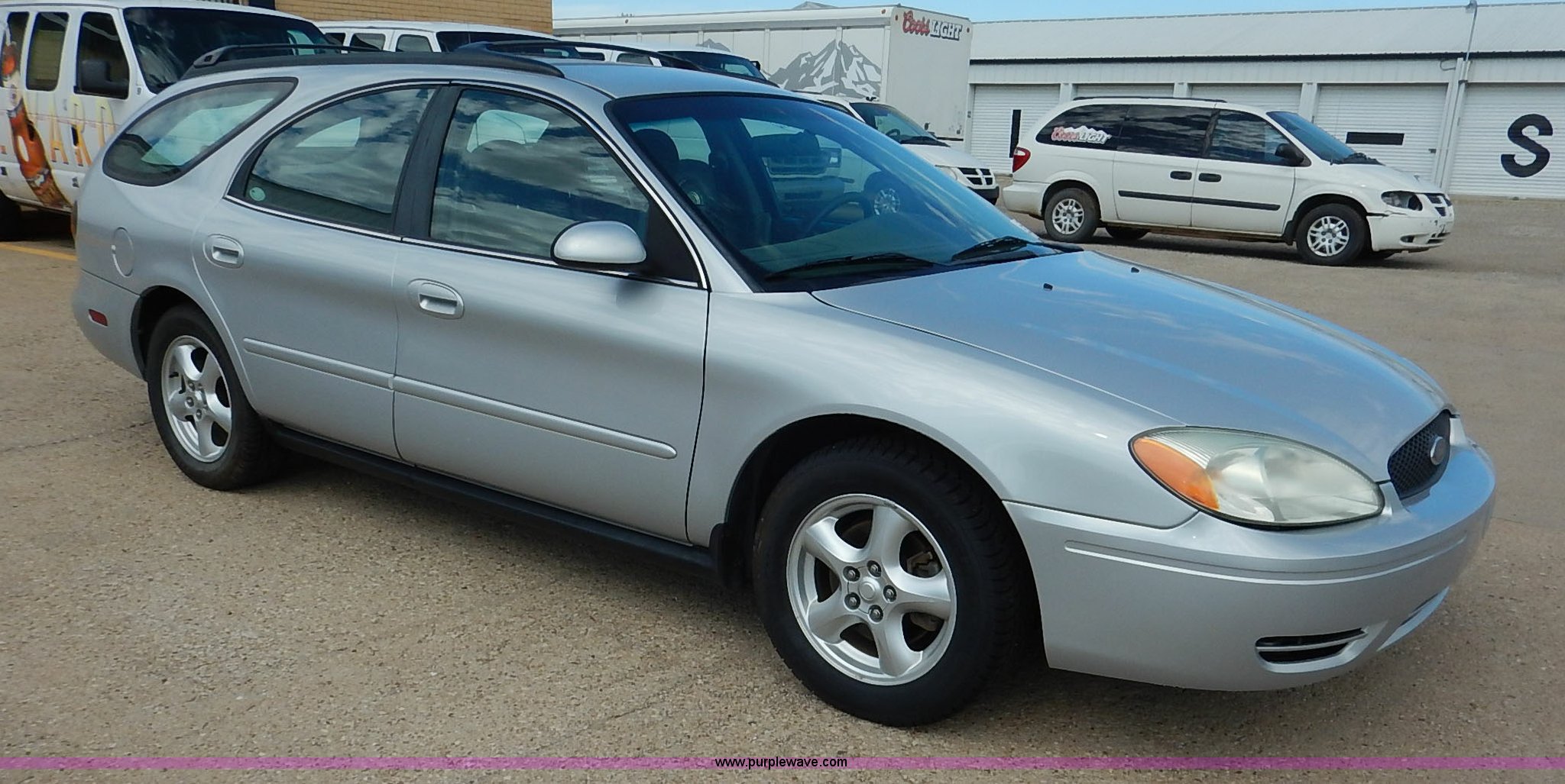

    What is a wagon?
    I'd consider the Taurus wagon a wagon.
    [​IMG][​IMG]
