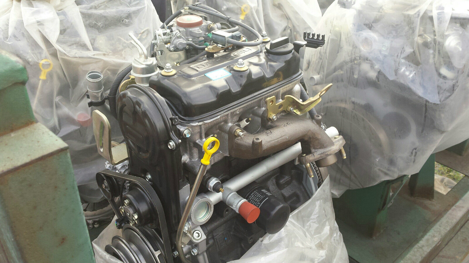

    I don't suppose there's a used engine sitting somewhere on the Continent?
  2. Doghead
    14,669
    6,058
    There's no shortage of them, as of yet. They usually survive the bodies. I'd like to get a spare for a project of which I've always wanted to do. Namely, dropping one into eithe a Renault 5 or 6. Perferably, one with an automatic. Both weigh about as much as mine does.
