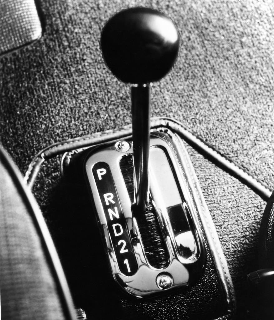

    Now that I've got an automatic, I'm going to have to try like Hades, to get one of these vintage Volkswagen mini-consoles
