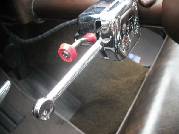

    Is that one of those with the rubber wheel running on the steeringwheel? I used to fix those when we had slow days at the family junkyard. Small world.:wave:

    Like this ?

    Man that's pretty. Yep, that one and another from a major parts producer... I wanna say Autolite, but it could be Smith Instruments. Anyway, those old beasts were made to be repaired, and you'd be surprised where you can get parts from! The US Army and their Quarter Masters inventory. I think they still use the old 1948 to 1952 Dodge Deuces for training. I'll bet ya a donut on that!

    Just remembered that Delco made some too but painted, not chromed.

    Well, I now have brake lights. Took the Yankee apart, cleaned all the contacts and reassembled it. :whew: Talk about a PITA to work on.
    Now I can say I fixed one too.....:rofl2:
    At least I don't have to worry about rewiring anything (yet)
